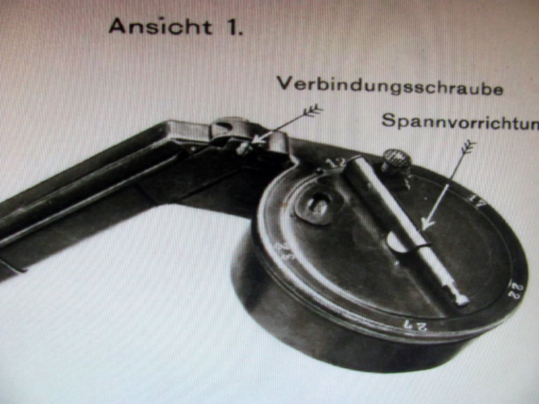

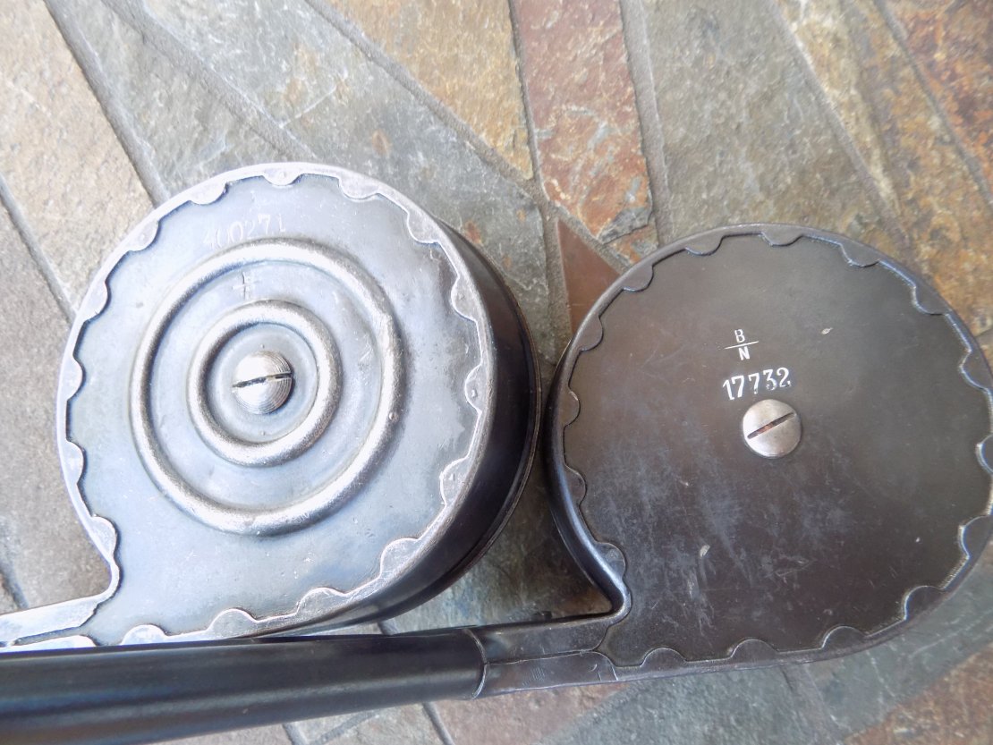

2) after becoming familiar with your drum... take the cover off and degrease and clean. Then using 3M 320 wet or dry sand paper, sand every bit of interior surface, inside the cover shell, and on the exposed surface of the spring cup, AND, up the tube as well... I use a 3M scotch bright pad, on a cleaning rod with a wire brush, to hold the sandpaper. And I also finish with just the scotch bright (extra fine!).. re-grease, and put it all back together! have fun!....til...lat'r....GT
