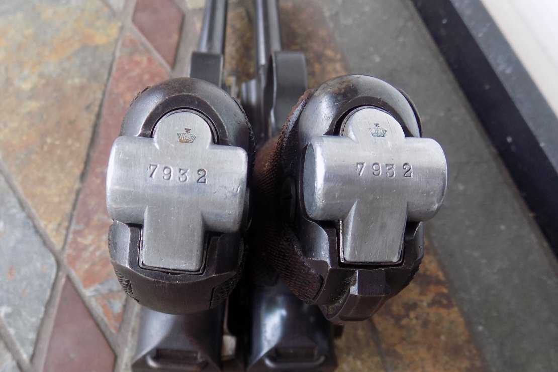

Old 03-08-2018, 03:34 PM   #12
Thanks: 1,120
Accountability is the reason.
I get the impression that the police elevated bureaucracy to a very high level.

Krieghoff took it seriously~
