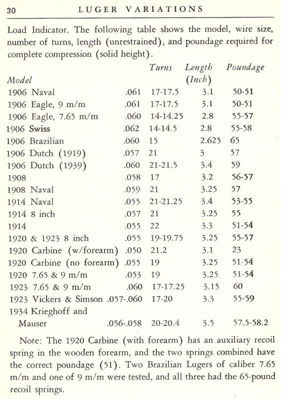

Wolf springs for the luger are "all over the place" with respect to length and "power".
You may or may not be improving your situation.
As you can see from the chart, the Germans(or someone) could not exactly make up their mind what spring was needed! JMHO.
Of particular note are the springs for the 1920 and 1923 commercial lugers- 7,65mm and 9mm the same-but '20 and '23 are different from each other, as the kids say- "go figure". I realize these are from measurement and may not be totally reliable, but are offered to put mainspring variations out for consideration!
I have used Wolf springs, but only after measurement. The first Wolf "Kit" I bought had 3 different stregnth mainsprings or was supposed to; the 34 lb spring was longer and stronger than the 38 lb- at least the way they were labeled.
If you must mess with your spring, take it out, measure the wire diameter and number of turns and the free length. Compare with the table that is available.
Then decide what to do, and by all means compare the "new" spring to the old and the chart.

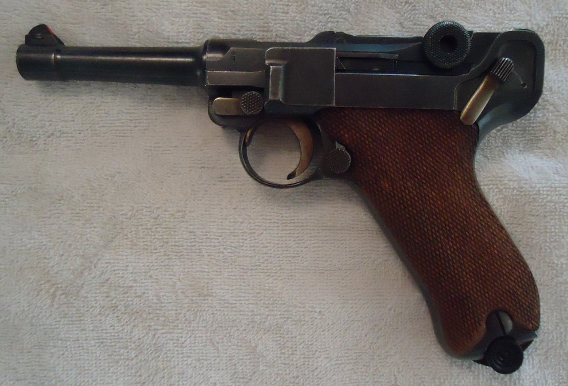

I'm in a quandary.....but I think the correct way to handle it, would be to replace the mainspring. I recently bought a 1920 Commercial 7.65 which is in excellent + condition, but has a very stiff mainspring. My normal reloads, and including some factory Fiocchi ammo, won't cycle at all; the breech comes back and cocks, but then slams the fired case back into the chamber. I'm guessing that someone put a 9mm spring in it. I really don't want to load-up hotter ammo. Your comments will be much appreciated.

Bob,
post pictures of the "damage".
DWM used the same spring for .30 and 9mm at times. See the attached chart.

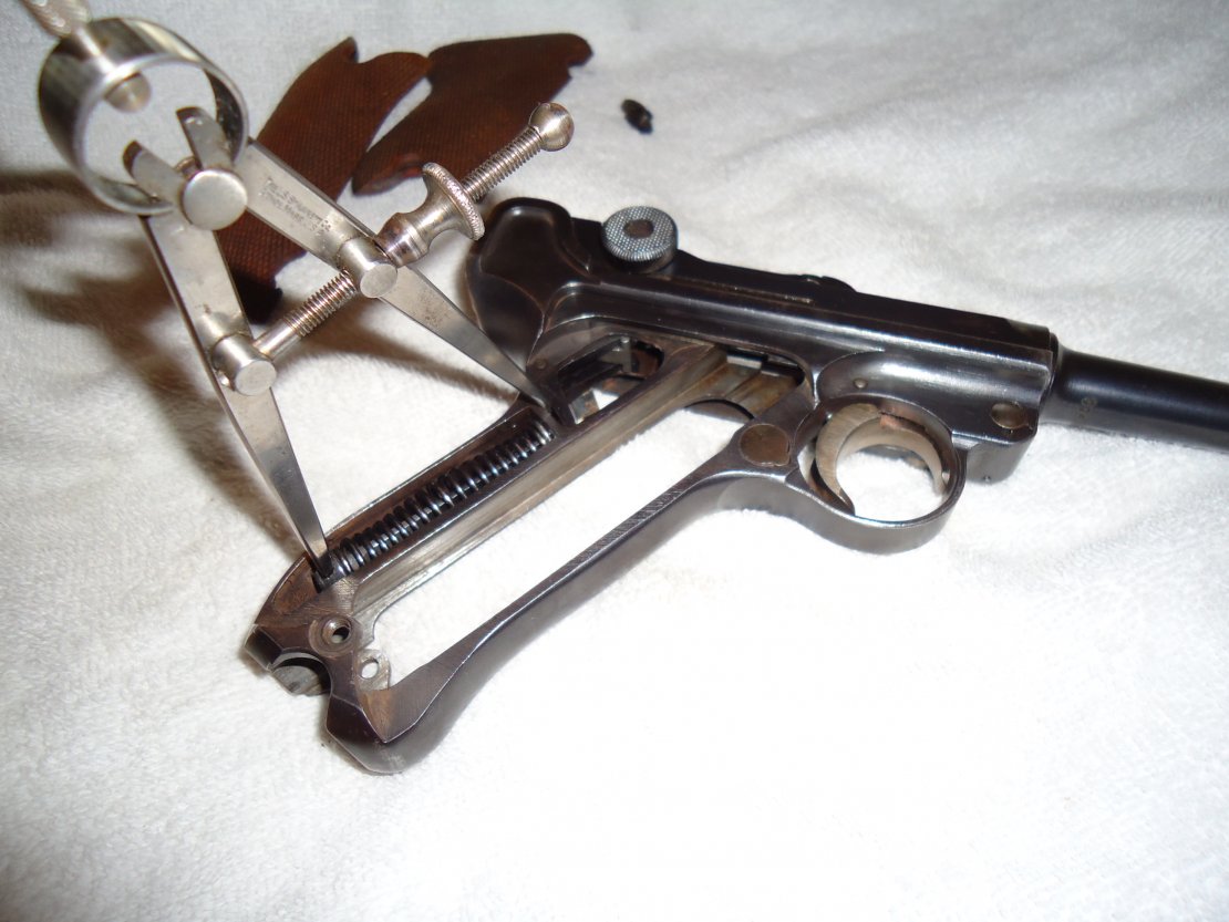

These are some dividers I bought at a yard sale which had been modified, and so I repurposed them. This is an easy way to remove or replace a mainspring, and you don't have to be Charles Atlas to do it;
