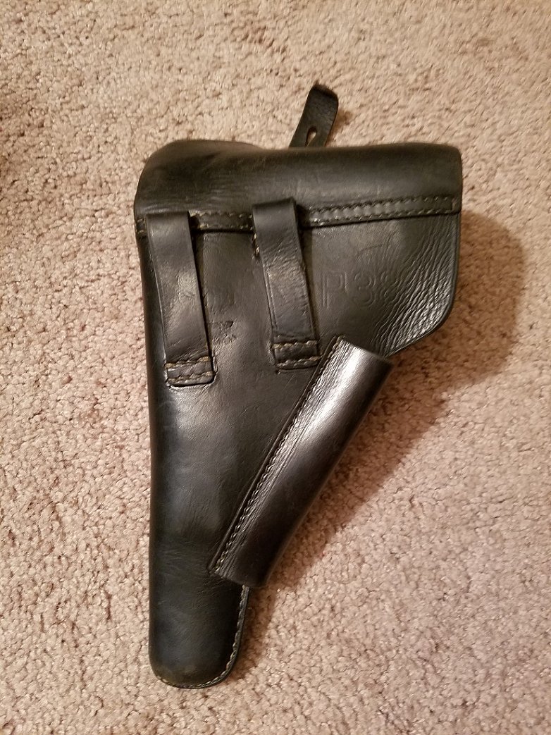

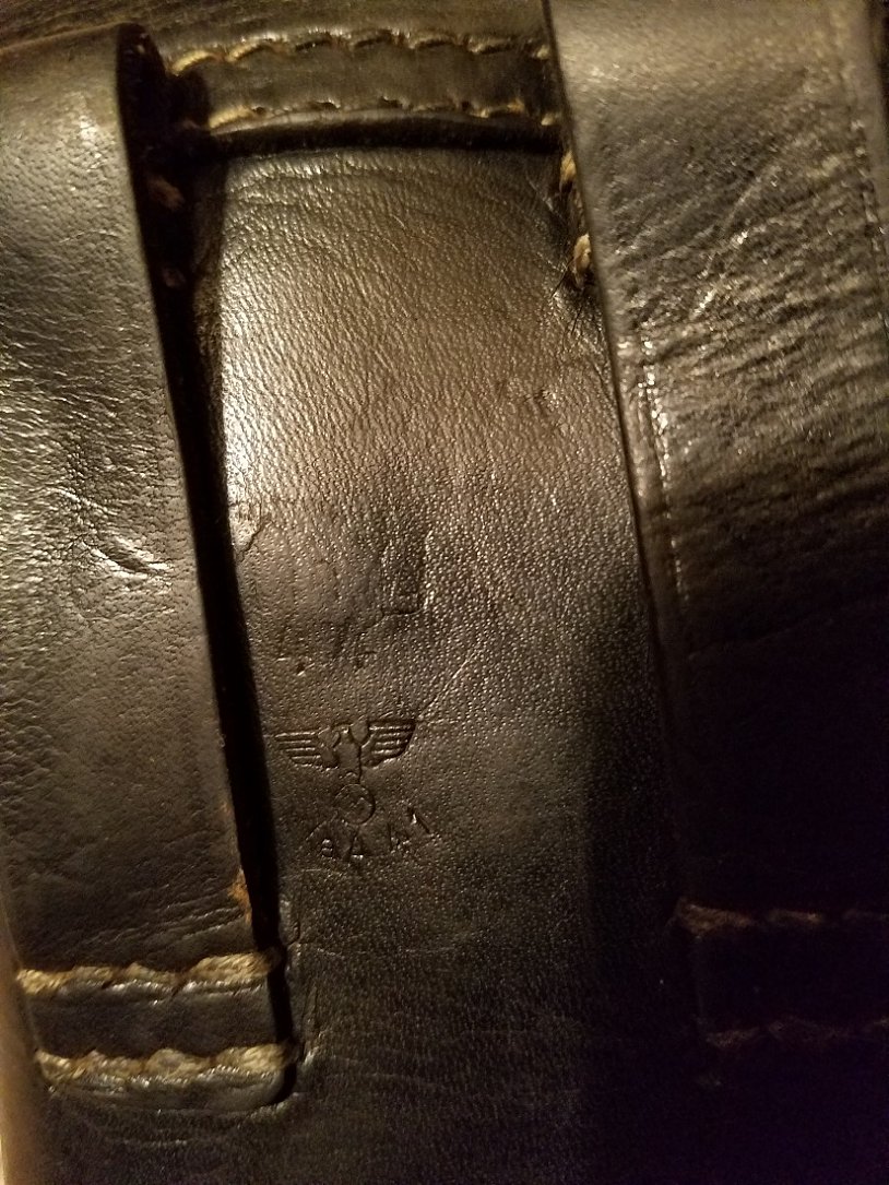

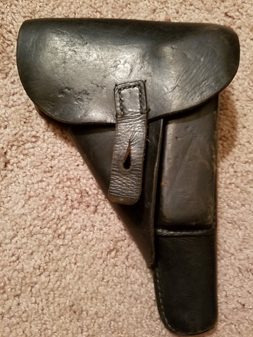

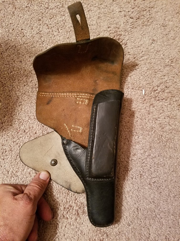

Here's mine.

I'm not sure if it's authentic? I posted pics almost a year ago but there was no response at that time. Tried to trade it for a P08 holster some time back but the other party must have decided against it, never heard back.
I would think the flap serves as some quick draw purpose?

Apparently the answer is yes, mine is real.

This style of holster began to appear in 1943, and eventually was to replace the hard shell style. It's know as a "break-away" holster. This is because when you pull the closure strap up, the flap lifts, and the inner "break away" flap opens up, and allows the user to easily remove the pistol. No lift strap needed. This holster was much easier and cheaper to produce.
Spanner,
Your holster is also original. Appears to be a "jhg" 1944 date. This is for GECO. Proof should be WaA41.
Matt
