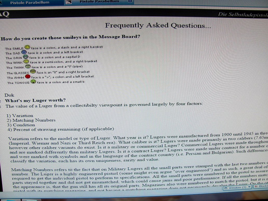

Dave , Thank you for your patience and common sense approach. Your explanations are priceless. Your thoughts shall be shared by all. You and Don are my heros to which I will always be there for you if needed! God Bless! You do more to heal me than any doctor or drug!! Our FAQ is priceless!! http://www.lugerforum.com/ Under General Information Section Just noticed Ed updated May 16, 2017~
