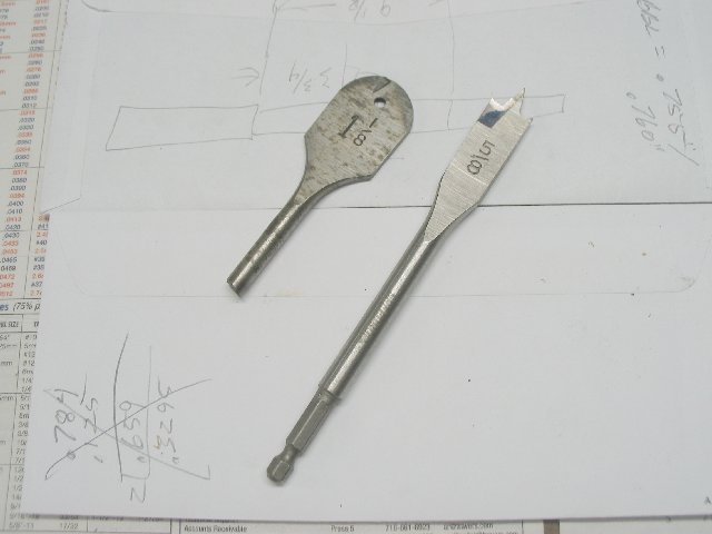

Buy a 5/8" or 3/4" wood bit instead. The flat one, with a central spike point. Grind the spike off and grind a radius on each side, angled so it will cut. Use that for the Mec-Gar knobs.
I did this with a larger wood bit to cut reliefs in Spanish Mauser stocks, the ones with straight bolt handles. I heated the handles with a torch and bent them, then added the reliefs. Looked as good as a German Mauser K98.

It was too late last night (it was dark...and scary...), so this morning I went out to the tool shed and dug out my 'Mauser bolt reliever' modified wood bit. I forgot to mention that the shank should be as short as possible but give good support in the drill press/mill chuck jaws. IIRC, I also used high speed. The better to send pieces of work flying around the basement.
I also have an old Harbor Freight drill press vise that allows movement (about 4") in the X and Y axis. I'm not sure if I'd trust it to steel, but it works satisfactorily on wood, plastic [Delrin!], and to a degree, aluminum.
All could be used for simple tasks like dishing out magazine knobs, small milling of wood holes/slots, etc.

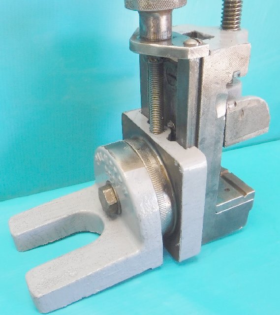

Gerry, back in the 70's/80's, before I bought my Bridgeport [now gone], I used a tool post milling attachment for my South Bend 14 1/2" x 60" lathe. There's a couple on eBay right now but pretty high price and kinda small...
But they can bridge the gap between a lathe and mill until you can find/buy a milling machine. I used mine for milling out reliefs for Bo-Mar BMCS low-mount rear sights, dovetails, S&W micrometer K frame sights, etc - all in 1911 slides. It was also good for making small parts. It adds 360º adjustability to the lathe, plus an extra 'Z' axis.
(Just to be clear, you mount the end mill in the lathe chuck and this attachment to the tool post!)
If I didn't have the mill in my Chinese 3in1 machine I'd buy this attachment.

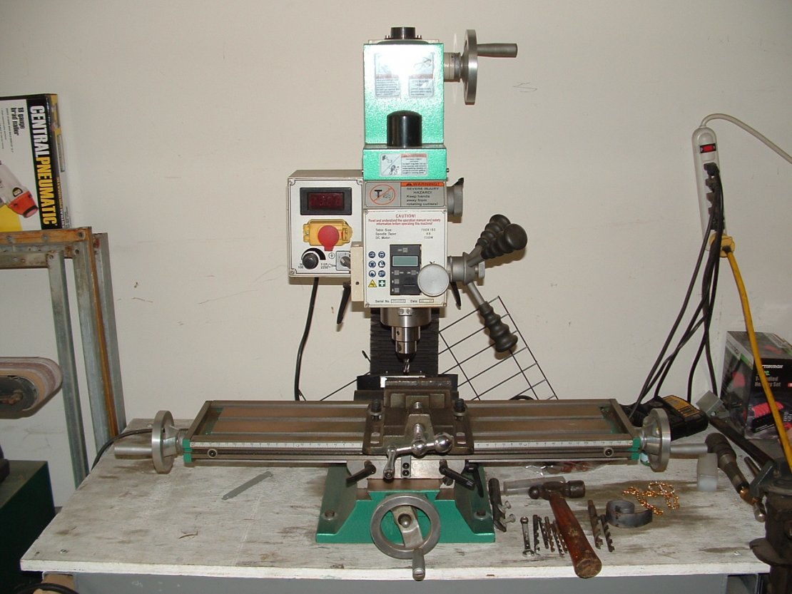

I know this is an old post, but I'm amazed that everybody can perform the
quality they do without the right tools. You can buy a small very precision
mill from Grizzley for $754 shipped. I bought my small harbor freight lathe
for $500 used. Its called a precision where they hand scrape the rails. Both
will do quality work, equal to your talents.
