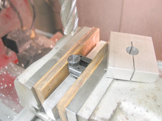

But, all that having been said, one thing they still are missing is the funky black plastic Navy concentric ring bottom design! ... Well, today I decided to see if that was correctible, and the good news is yes! A 3/4" ball end mill effectively removes all the rings and provides a much better concave recess to properly grasp the bottom piece... It's not all that much better looking, but it does look better???... I will trade you one of mine for one of yours for $10.00 and/or, sell you one for a broken mag bottom replacement for $15.00 ... I have a few, and will be generating more as time goes by...... Best to all, til....lat'r....GT....

First pic is of a shiny plastic (not Nylon) Mec-Gar mag base clamped between two pieces of plywood...I have a quick & dirty jig for holding Luger aluminum magazine bottoms (shown on top of vise) but the Mec-Gar is a bit larger, so I just clamped it...It's junk, after all...
Second pic is after the 5/8" ball end mill dishes out the knob. Not a high-gloss shine, more dull...It could be buffed with a rounded mandrel & wet-or-dry sandpaper, but again, OEM plastic - who cares...
So, it looks like Gerry's dishing magazine knobs would be an interesting & maybe worthwhile modification. Especially if you had several mags. They could even be dished without removal.

The pictures Ed so graciously added to the beginning of the thread, (because I can't figure out how to do it!..) shows the Nylon reinforced MEC-GAR mag bottoms with my effort to dish the knobs for better purchase when shooting?... Where as Rich used a 5/8" end mill, I used a 3/4" and took it to the max, both have there appeal but, I would say it is most likely what we had on hand was what got used! I am probably going to stay with the 3/4" because it is out to the max and feels very positive for the shooter in me.. but, aesthetically, the 5/8" is by far more preferable... ... Either way, it is an improvement to the MEC-GAR concentric ring offering... The last picture is a normal day at GT's work space! (next qty. 5 Numrich drums going out!) It can change to messy and stormy in a heartbeat!... ... Best to all, til...lat'r....GT...

Hi Rich, I get your humor.... again don't delete! It's part of the fun here.... ... The main difference between what we have done, is mine is lathe turned, while yours are milled.... I wish I had a mill... maybe in the future!....Best to you, and all, til...lat'r...GT.....
