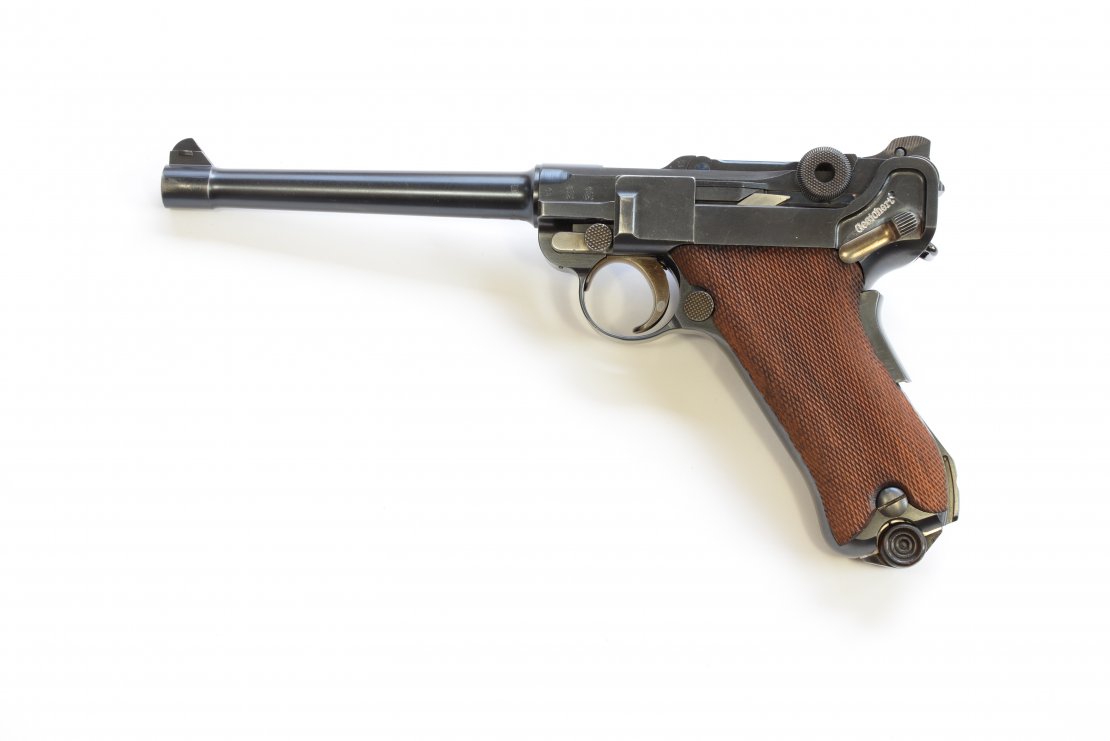

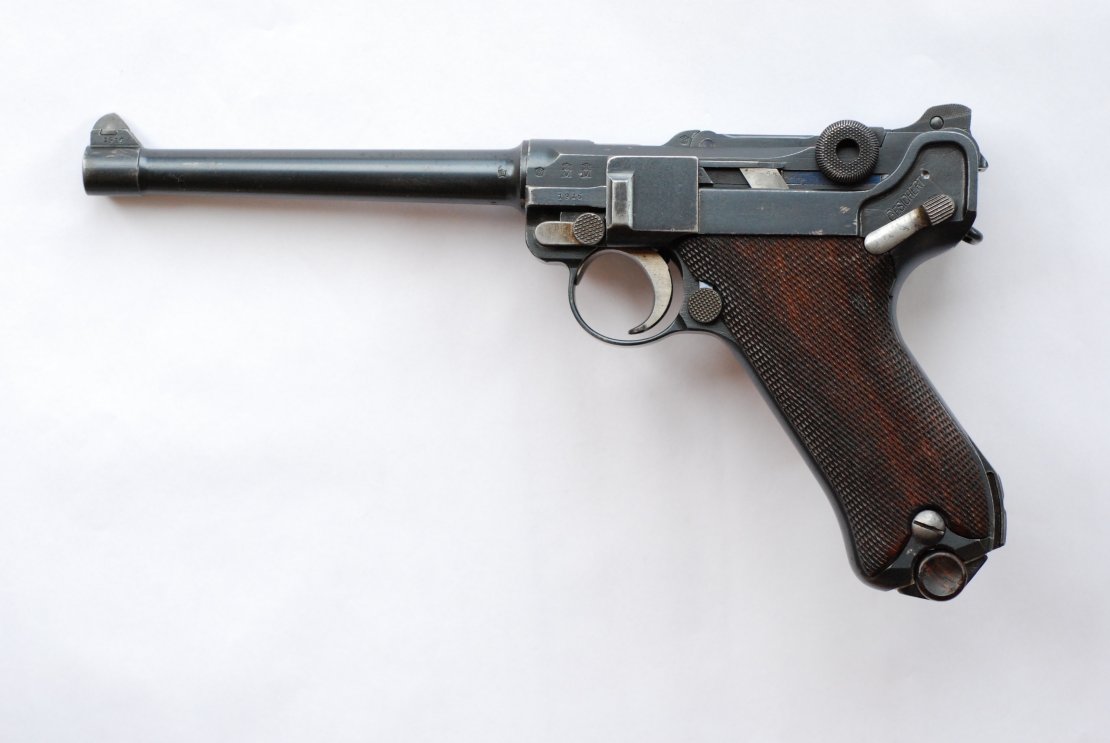

Here you go Kirk, as you suggested, the sear block slopes backwards on grip safety models, forwards on those without grip safety.
Regards, Norm

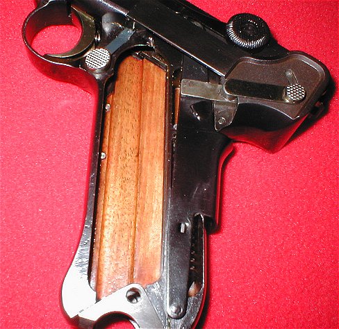

Here are the guts of a Mauser Parabellum.

So does the lever on a grip safety model just prevent you from squeezing the grip to disengage the safety? Thanks for the pics, maybe a pic of a grip safety model less the left side grip panel.
Kirk
John1125 is offline   Reply With Quote
Unread 02-22-2017, 09:21 AM   #6
Yes, that is correct. The lever just blocks the grip safety, which in turn blocks the sear.

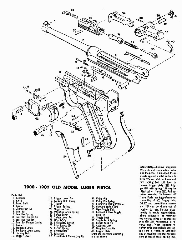

so a grip safety model would have a spring that would return the gun to safe when it was not held , and where does that spring reside on the gun?
I can't seem to get an exploded view of those models to come up when I google them , sorry for my ignorance once you get something in your mind its hard to get it out

Thanks: 2,679
Part #25

so a grip safety model would have a spring that would return the gun to safe when it was not held , and where does that spring reside on the gun? Kirk
Part #25!
