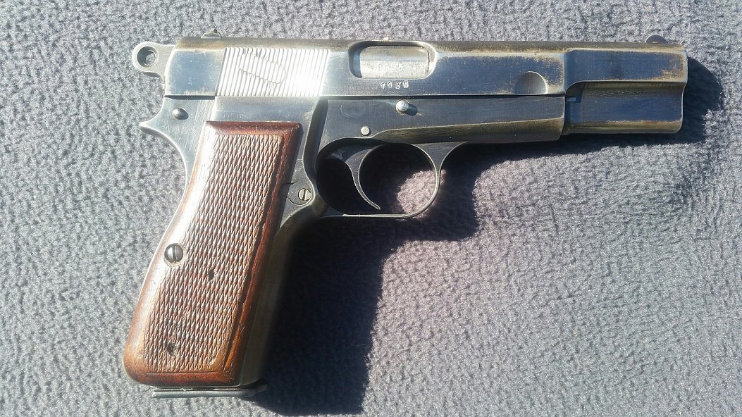

Has anyone ever seen one like this? I don't know what to think of it. I was thinking possibly it is a "last ditch" gun? or a "post liberation" gun?

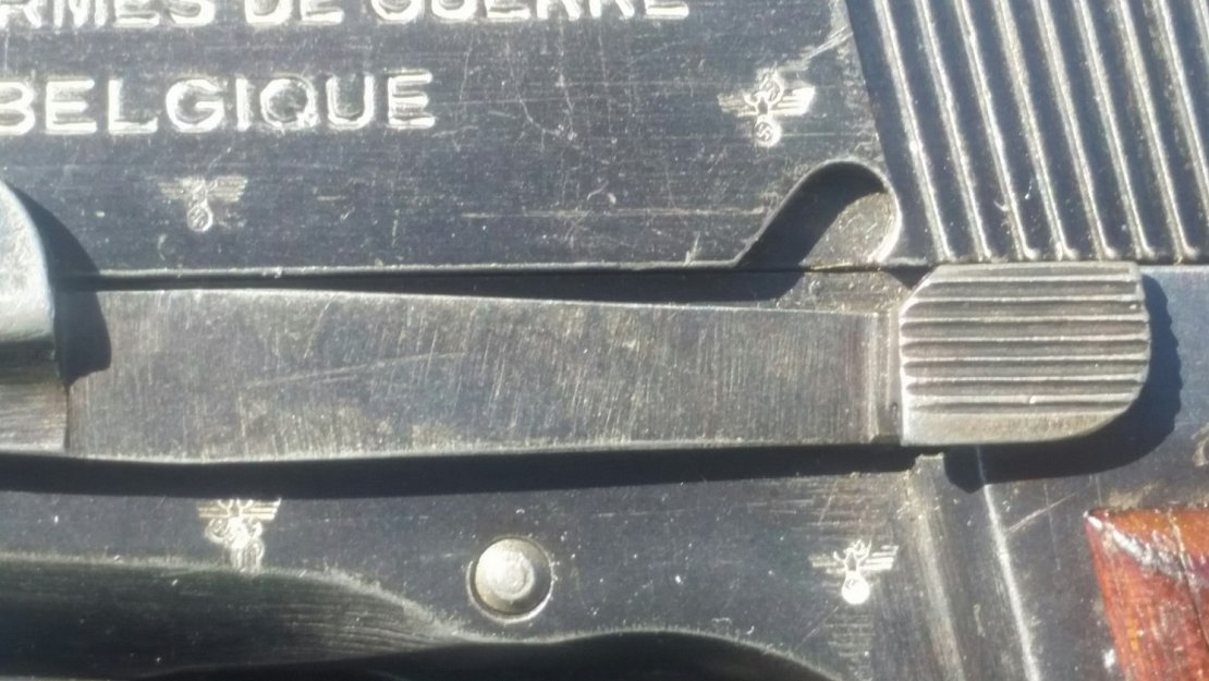

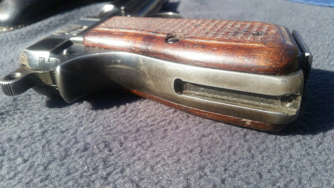

It has Nazi test fire proofs on it, but no waffenampts. It is all matching. It has the fixed type rear sight, but is slotted for a stock!
Opinions welcome.
Matt

Judging by the four digit serial number, this could prossibly have been a pre-occupation gun and just never got the full treatment of the guns that were being assembled by the occupation folks. A lot of strange things went on during this time period with the manufacturing of firearms and the identifying marks that were being applied.
I have a five digit and a six digit HP and neither have the slot but do have the waffenampts. Perhaps they didn't slot the occupation guns, I've seen several wartime HPs.but none that were slotted except for the Canadian versions.
It is an interesting anomaly, but perhaps someone will know the facts.

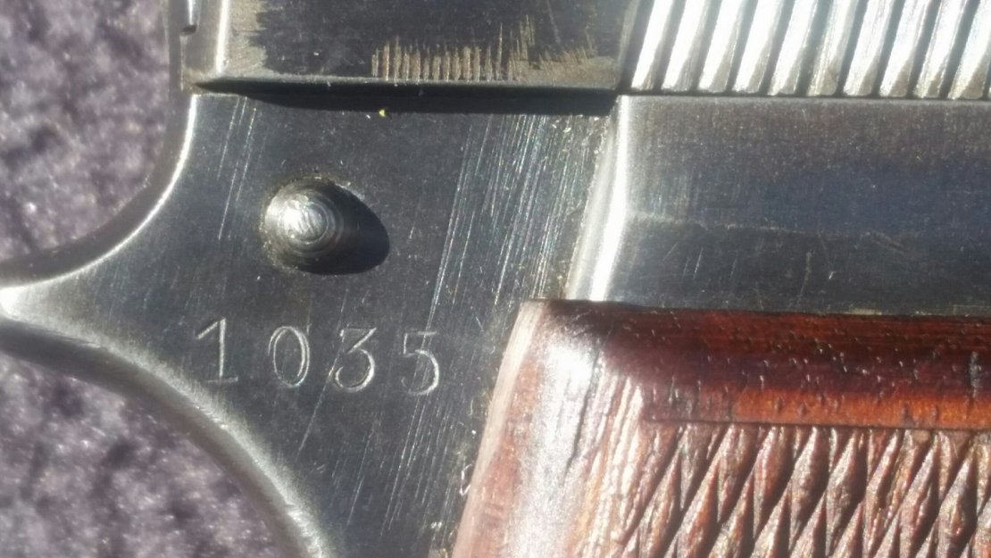

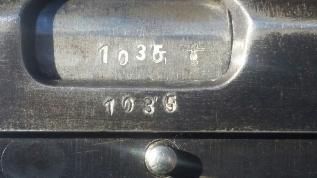

The serial number fonts are not correct. The location of the serial number on the frame is wrong. FN - pre/post occupation and/or the Germans never put the numbers in the tang area.
The frame with the slot was discontinued early on in the WaA 103 range which would have been early in the German occupation.
Could be a sample where parts were unofficially removed from the factory or cobbled together from parts on hand after FN took control of the factory in 1944.
