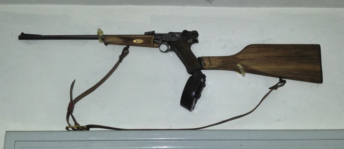

GT, I need to send your snap caps back.
GT does stand behind his work, always has and always will
My magazine makes for a nice display ey?
Yes, Tink, that rig is drool worthy for sure!
Thanks for making us all terminally jealous. LOL

Ed, Your photo reminded me of a 1930s Jimmy Cagney movie, where he was the bad guy with a full auto luger carbine with a drum. just another Hollywood error. I wonder how the new Trommel mags would function with 30 luger ammo? TH
Unread 11-16-2016, 02:32 PM   #73
I wonder how the new Trommell mags would function with 30 Luger ammo? TH Tom, I was asked that by George Fortier several years back so I loaded up a drum, stepped out to the pistol range beside my leather shop and let er rip. Worked just like 9MM.
The following 3 members says Thank You to lugerholsterrepair for your post:
