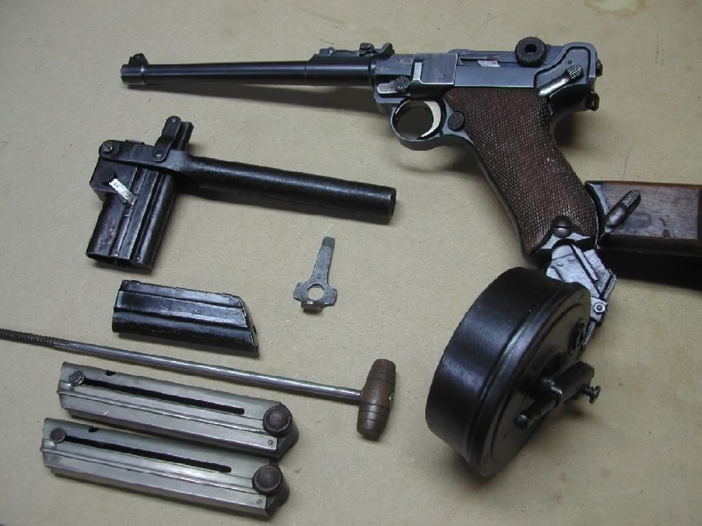

kurusu 04-10-2016 03:58 PM
1 Attachment(s)
Originally Posted by sheepherder (Post 286769)
Wow! Does Numrich really have that many 'on-hand'??? :eek:
It all sounds really cool, but I've never seen a drum except in pictures...Do you have a pic of one installed, so those of us who've never seen one can get an idea of its relative size??? :)
Found a picture for you.
Attachment 57997

sheepherder 04-10-2016 08:43 PM
Thanks for the pic! ;)
