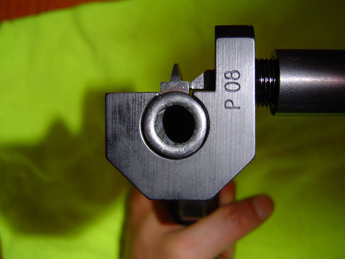

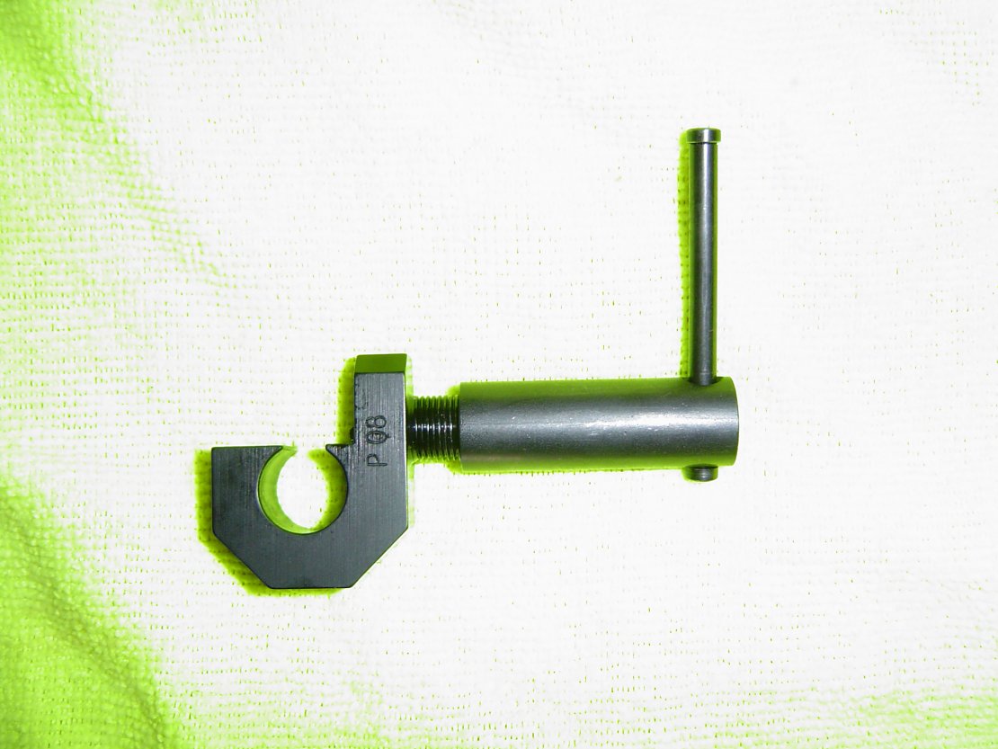

I have never really seen a sight pusher that works, and I have tried in vain to come up one that does.
I have one that does work. But it's P.08 dedicated. Meaning, it doesn't work on anything else but a P.08 (tricky fellers them Germans ).
Name:	sight pusher2.jpg

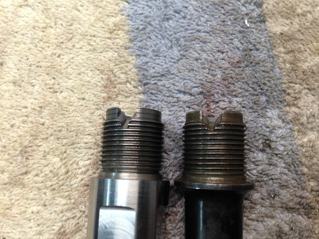

very nice cut for the extractor, looks just like the original! Good work. Do you use a shaped cutter or shaped grinding wheel ?
Don,
I happened to have a "divine moment" and realized that a corner rounding end mill would do the job, and after spending half a day on searching different web sites I found one the closely resembles the original cut. It's a bit narrower than the slot, but this works perfectly as it allows me to widen the cut for chip clearance as I go.
Attachment 59634
I tried to make one similar to that, but after measuring several barrels I realized that the band diameters can be very different (especially if you include the P1). However, yours looks simple enough, and if it does work I might give it another try.

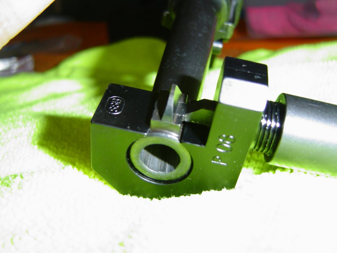

Work it does. But as it fits the P.08 barrel band like a glove, It won't fit a P38, or even other Lugers other than the standard P.08, such as LP.08; 1904 Navy; or any .30 caliber.

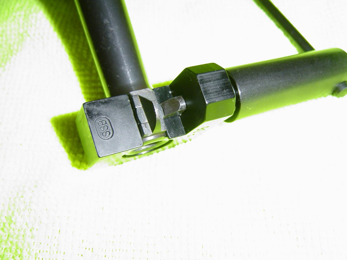

Pictures make better examples. You can appreciate how it fits snugly.

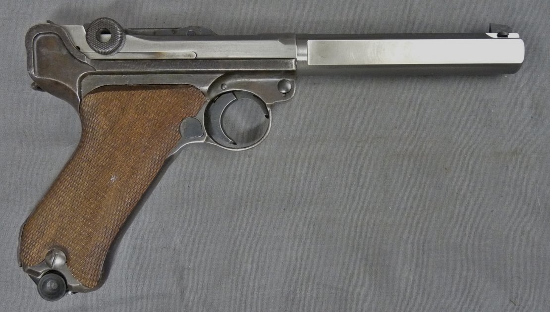

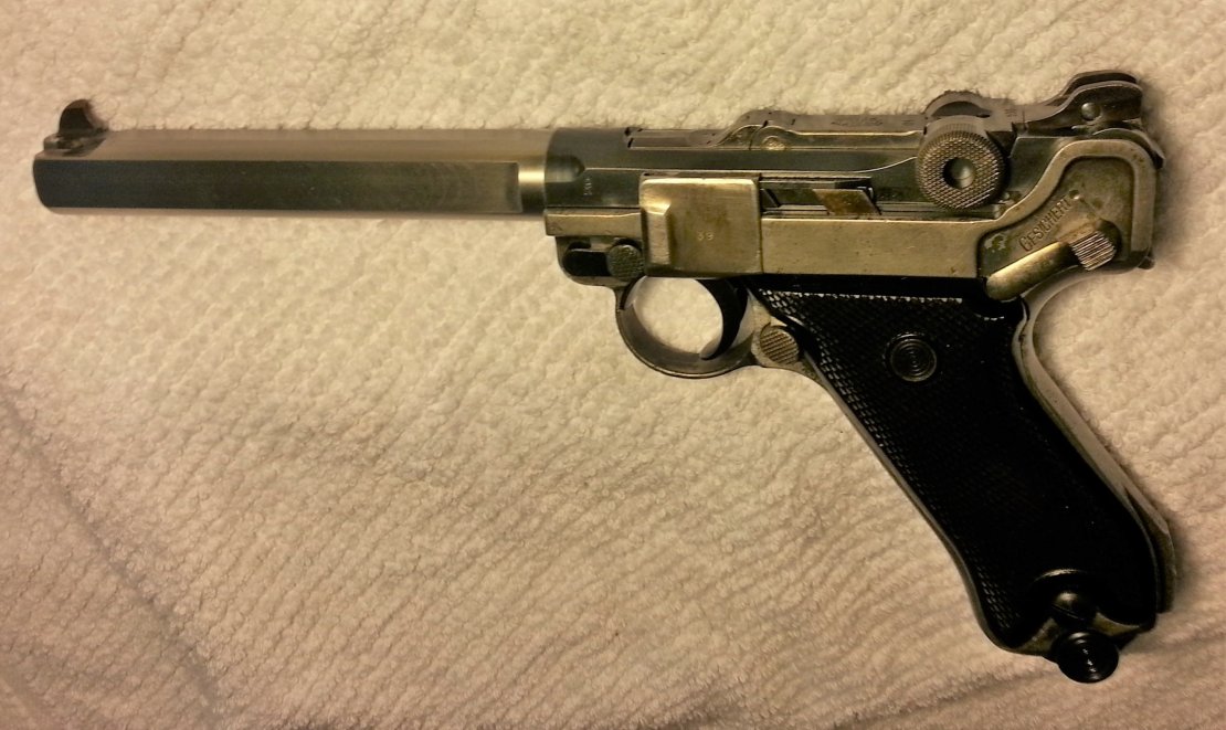

crappy pictures taken after class tonight and I had my Christmas package from GT!
Sorry Don, sometimes you're lucky to get pictures

Unread 06-16-2016, 02:36 PM   #53
Posts: 2,308
Thanks: 2,737
VERY nice Ed!! With that amount of weight up front, the barrel rise when shooting should be minimal.

Hi Doc & Ed, I did notice with the 6" barrel at near full mass, it soaked up a considerable amount of recoil as well... I really don't think an 8" barrel in that configuration would work?... More worried about closing then malfunctions?.... ... 6" smooth as glass... best to all, til....lat'r....GT......

Ed,
I like it; well both of them.
I'm going to get GT's 5" model and go with that; couldn't decide if 4 or 6 was better!
An 8" bull/slab is likely to be too heavy for the standard mainspring,would likely to go lighter.
Ed, your 6" bull bbl is approx 2 oz. heavier than an artillery 8" bbl., and close to what a 12" carbine bbl would weigh by my estimate; and about the max weight that would work reliably without monkeying with the spring.
The Art. mainsprings I've measured by my method are 14-16 lbs, and the 4" measures 18-20 lbs.; i.e. he heavier bbl requires a lighter mainspring as observed. It is impossible to predict what is in any given pistol, due to the natural variation and years of potential changes. The higher velocity from the longer barrel helps some also.
I also proved this to my satisfaction in working on a 12" .30 cal bbl, and getting it to a weight that would function.
Bottom line- if it works - super!!! The 6" pistol looks great with those grips too.

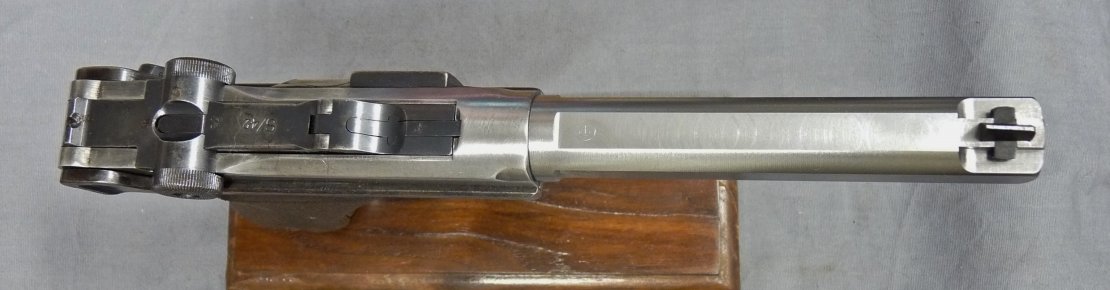

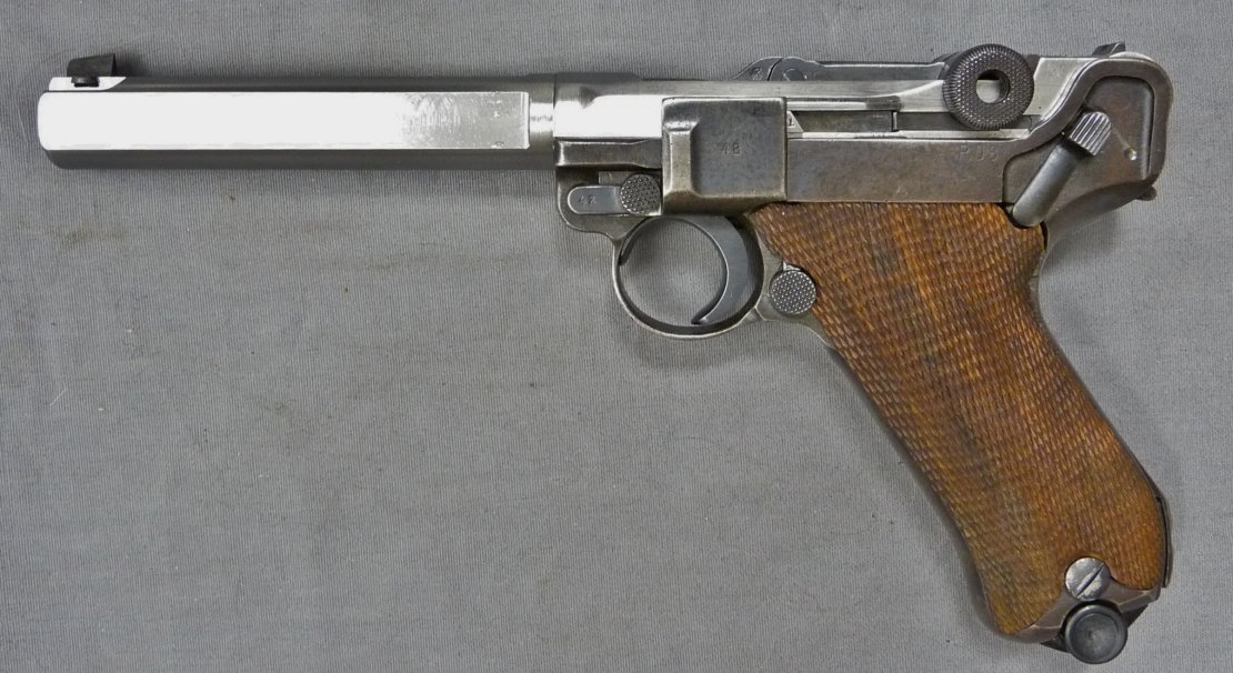

The 5" bull slab barrel arrived yesterday, actually it is 5.3" long and weighs 9.8 oz.
That weight is 2.1 oz heavier than an artillery bbl with sight; but the balance is much closer to the hand- I can't wait to shoot it.
I installed it on a receiver and put it together to shoot in a day or two.
Pictures below. Looks super, nice work GT and Ollie.

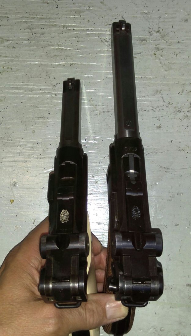

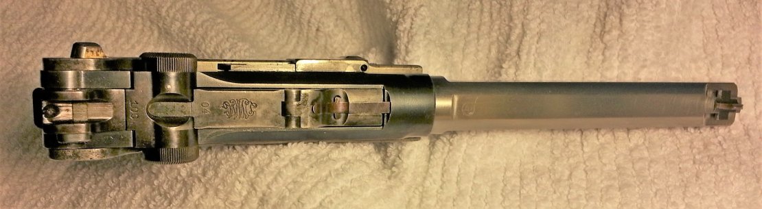

I received my GTS/T-6 from GT yesterday. I was very impressed with the quality of workmanship. The point of aim feel for both single right hand and two hand grip is not too different than my Hi-Standard bull barrel target models.
I manually fed several snap cap rounds through the pistol, very smooth. I look forward to getting to the range and putting a few boxes through it. I plan to play with it a while and then put a rust blue and straw finish on my GTS/T-6.
Name:	GTST-6 LEFT TILT.jpg
