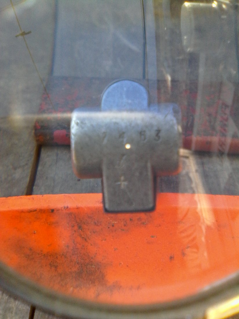

I am trying to learn if the magazine that came with my P08 is correct
It is a G date P08 with second variation markings as seen in the sticky "six variations of G date" 63 & 92
the magazine is aluminum base and appears to be nickle plated, it has the 63 stamp with + above it, and the prefix letter above that and finally the serial number on top, everything matches except the number 4 in the serial number, on the magazine it appears closed top' while on the pistol it has a small gap,
does this indicate the mag was numbered to the gun later in its life?

I have tried taking close up pics of the detail to no avail,
My main question is if the number font should match exactly or not,
Were the magazines numbered at the same time as the pistol using the same stamps?
Or was it done later using similar but not exact stamps?
Also from what I have read, the + stamp signifies it as being the second mag ?

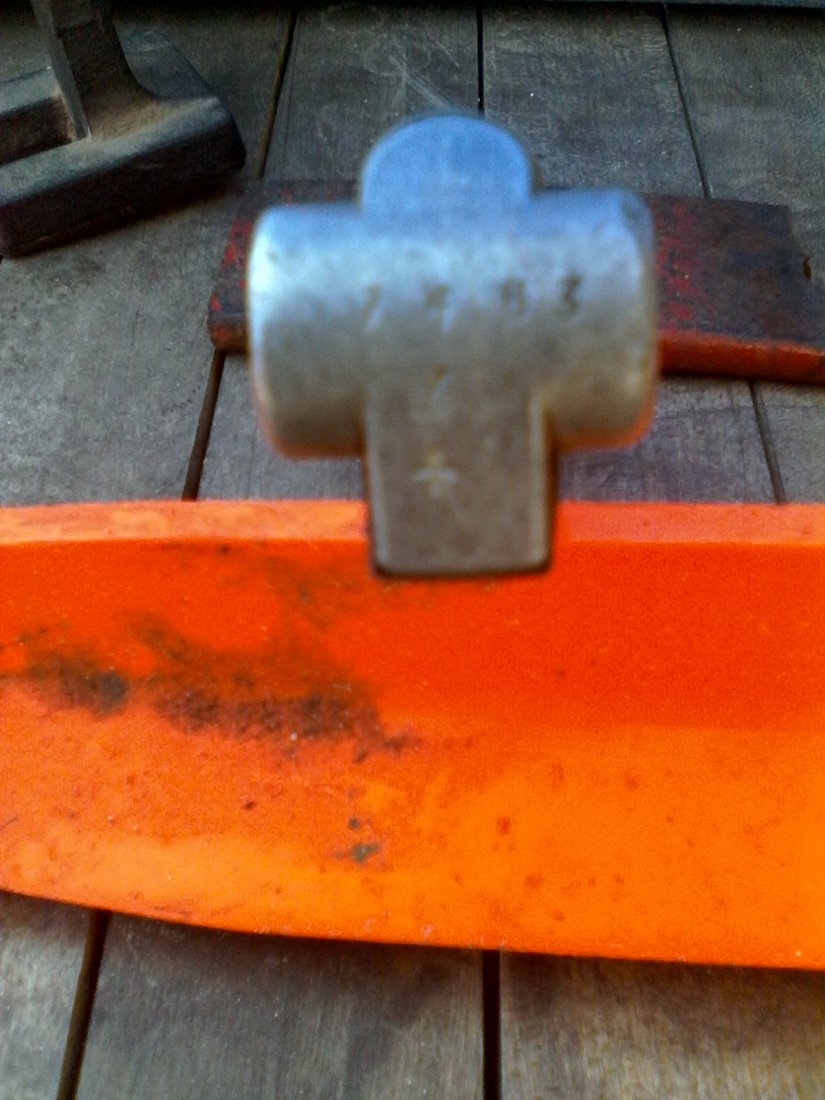

Pest pics I could get

As far as I can tell from the pics, the font is what would be correct for a "K" or "G" date pistol.... Not sure on the questionable 4 but the 3 is a dead giveaway to the date time period... GT...

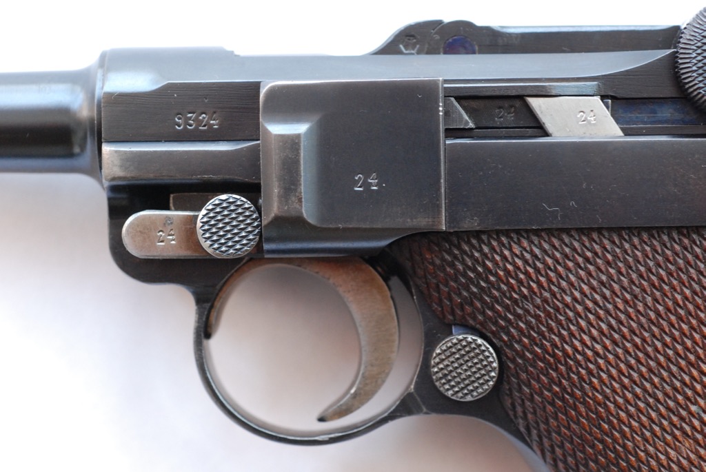

! agree with G.T., that mag looks 100% correct. Here's a photo of an early G date, the 3 is very distinctive.
Norm

Looks like a correct "d" suffix G Date magazine.

Thanks for the info everyone, yes the #3 font and everything except the #4 font appear to match,
