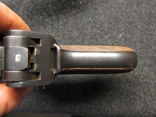

Thanks Dwight,
Since the numbers were out of order, I was assuming(I know, not a good idea), that the 03 related to the serial number overstamp of a commercial toggle. Now I can see due to the space, that it sort of "turns a corner" to get all 3 digits in place.
The rear number sure looks like it is struck over a scrubbed number, but I could not make out what the earlier number is.
I just had another look, I don't believe now it is over stamped, but one of the number stamps bounced and the part circle seen, is perhaps from a bounce or false strike of the 0. Rear of the toggle is very smooth and even, no signs of filing or metal removal.
The original extractor would not have been numbered on a commercial toggle, I think, so this one look like they made a mistake in numbering during re-work, stamping a "30" then canceling it, and re-stamping an 03. Maybe?
The breechblock and center toggle are both numbered 031. Granted the configuration is VERY non-standard, but the numbers appear to be original and the only way for them to make sense along with the c/N proof is as the last-three-digit small part numbering of a five-digit serial number gun. The photo of the toggle-tail number is not very clear in this regard, but it appears to to overstamp another number.

Unread 08-05-2015, 11:40 PM   #23
Exclamation
Dwight and others,
I was re-reading Sturgess green edition again today and on
page 801, lower left picture is an essentially identical breech bolt marking of 02 and horizontal 1.
Sturgess postulates that " the "1" inspection mark of the Police Inspectorate, applied internally as a component inspection acceptance mark to most small parts".
It would be interesting to know if others have or have seen this same use of the "1"
Unread 08-08-2015, 10:51 AM   #24
Dwight and others,
Not that I recall
and Sturgess guess is as good as many others - a guess - his books are very good and detailed, but parts of it are not as detailed as I'd like.
