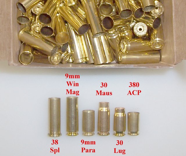

The Midway order came in today. I took a pic of whatever other cartridges I had handy, just for comparison.
