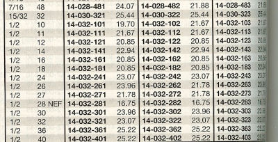

Sheepherder, I'm studying your info and have a problem with my conversion. The 'original' shotout re-barrel on mine appears to have been threaded slightly off. I threaded my 9mm blank to 1/2-18 which matches the old barrels threads.....I think a rather unusual thread. I've ordered a tap so as to re-thread the receiver straight. My question: Got a close-up pic of the rear receiver mandrel you made or, an explanation? The rear striker hole with the bolt inserted may, or may not, be a proper way to line it up. Any help appreciated! Bill
