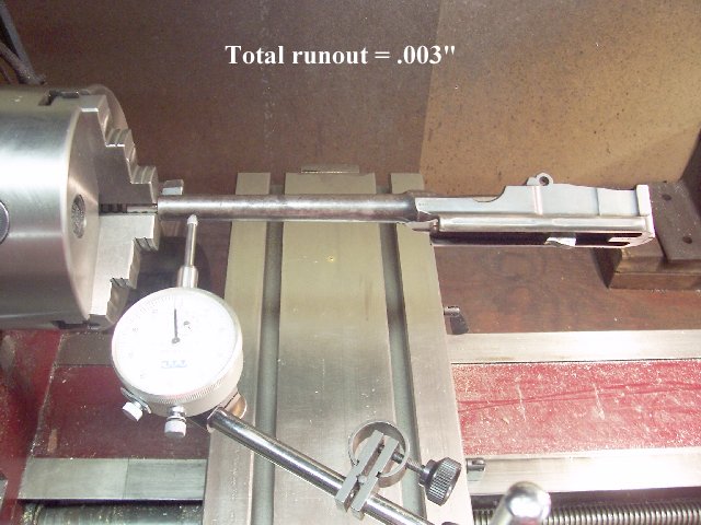

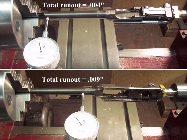

I made a receiver insert today, and after some measuring and test fitting I found that .540" x .540 was a snug fit. I figured that the firing pin is most likely centered, so I drilled a hole and chucked it up in the lathe (barrel band in the 3-jaw chuck and with a live center in the insert). With an indicator at the rear end of the taper (right before it rounds over), I read a .006" TIR side to side. Top to bottom was only .002" TIR, which is not too bad considering that the barrel has some slight pitting. I turned the insert 180 degrees and tried again, and got the same result. The low reading was on the same side regardless of how I turned the insert, so it seems like the bore for the bolt is off center. The point I measured is about 1/3 from the muzzle, which means that the rear of the receiver is off by .009".
Have you tried to measure the runout on an intact barrel/receiver, or do you know what a normal runout would be?
Unread 11-10-2014, 07:52 PM   #32
If you mean is the original C96/M30 barrel OD concentric with the bore, I'm not sure...I could chuck my C96 barrel extension up and dial indicate it, but I'd bet it's at least a bit off-center as to the OD...

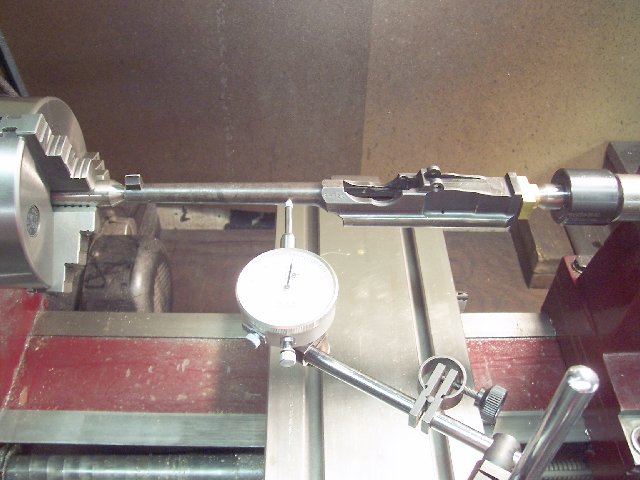

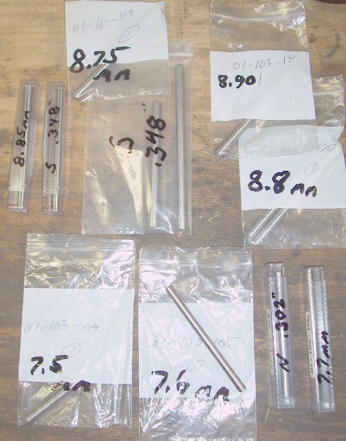

Here's my setup - the first pic is some of my ground drill rod blanks that I use for bore measuring...And by clamping my 7.6mm rod in the chuck and turning the C96 barrel extansion (not the chuck) by hand, I got the indicated runouts...
When I was done with that, I chucked my C96 barrel extension between a center in the chuck and my brass insert and got exactly the same results...Yeah, I was surprised too...

I tried the setup in your third pic, but with a turned brass rod instead of a straight rod. I got the same side-to-side runout as when chucking it by the barrel band, but the up/down runout was now about .015. Seems like the bore is off center by maybe .007-.008 at the muzzle.
Anyway, the runout in your second picture is close to what I got in the very same location, so I guess these guns are not as precisely machined as I thought they were. That could make it iffy to get a new barrel centered, as you won't have any reliable index points. On the other hand: It won't be difficult to stay within Mauser's tolerances, a tape measure will probably do just fine...

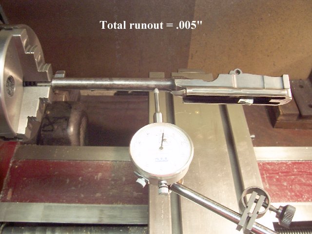

tell you what - that barreled extension up in the last post is an original C96 Mauser. Bore is a bit worn, but good rifling. Let me get my last re-barrel out and measure the runout on that...Stay tuned...
Ooowww...I'm not as good as the boyz at Mauserwerke...
