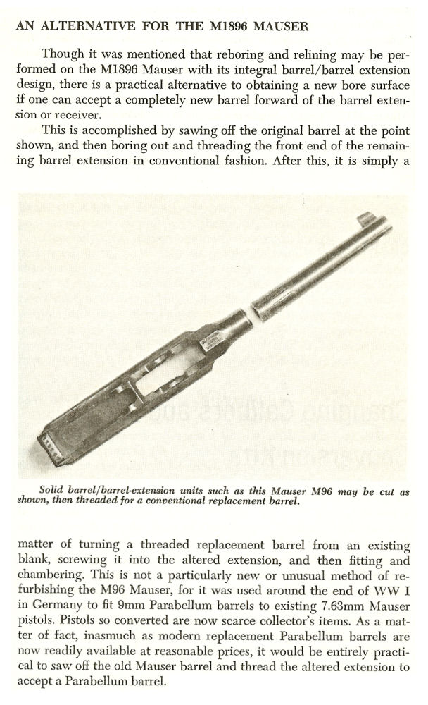

Some years back, I bought a book by George Nonte called Pistolsmithing. It is a compilation of many of his articles from various magazines. One comment was of particular interest, and concerned the M1896 Mauser.
I was intrigued by this, and decided to do a re-barrel of my own, on a shot-out C96 'Broomhandle' Mauser. I obtained a spare barrel extension from Gunbroker.com, and a 30 caliber rifled blank, and set out on my quest!

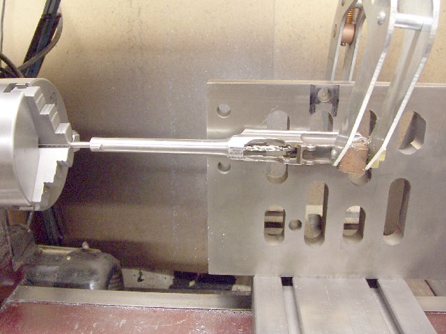

Custom turned mandrel in lathe chuck, mounted extension on angle block, leveled and squared to chuck...
Drilling out the extension stub...
Tapping the stub. I turn the tap by hand; the chuck is just to steady the tap and keep it on center...
Receiver/extension stub tapped and ready for barrel...
