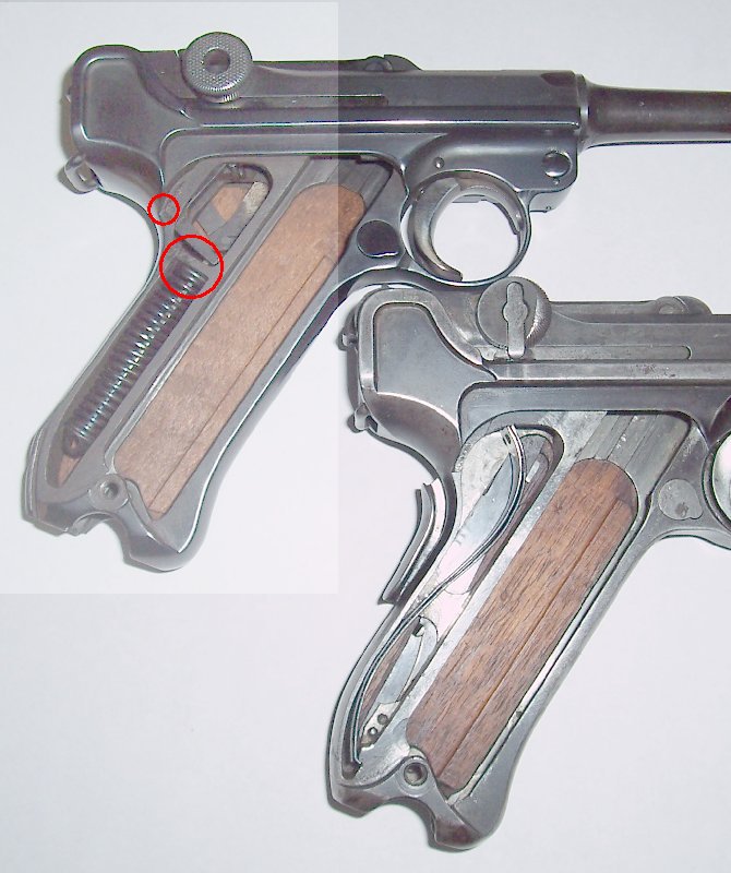

Would it not also be possible to swap out the flat leaf system and replace with the coil spring system? I know, the components are slightly different between rear toggle and spring, but changing everything over from the rear link on down would do it? I'd add the adjustable guide, too!
I'm not Tom (Tom doesn't take pics) but I see two problems: The small bulkhead that the coil spring bears against, and the lack of metal for the recoil lever pin...
...What adjustable guide???...

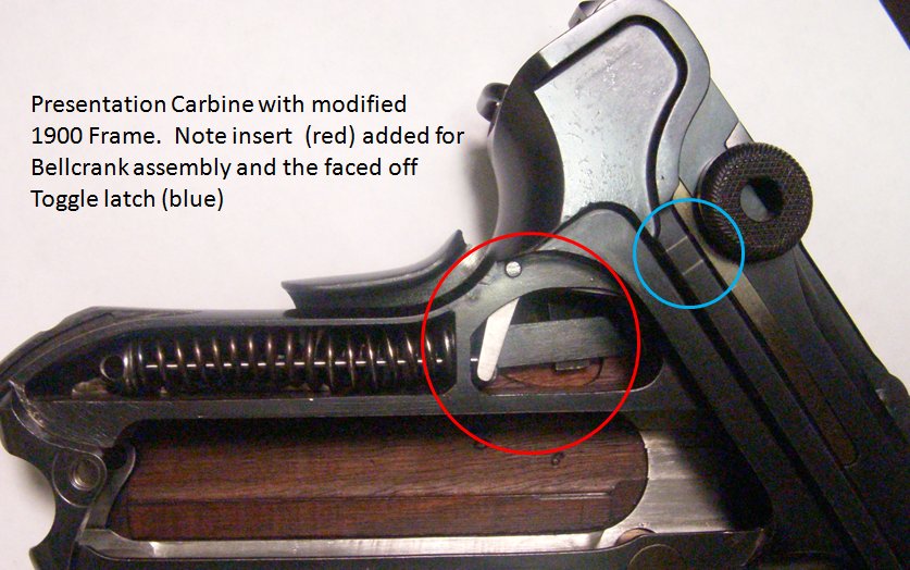

It is not only possible, it has been done. There are a number of authentic experimental and presentation Lugers that have had this modification (I even have done it )
Ron, I'm comparing your 1900 frame to mine and I don't quite see where your 'insert' starts & ends...Is it welded in???
Yours has a stock lug...Is that a late 1900 frame???

I see that it's more than simply changing parts...

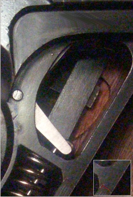

It starts and ends inside the red circle, and it is silver soldered in. Perhaps you can see the dovetails of the insert in this photo
P.S. It isn't mine...I wish it was. It is a GL marked transitional piece with the improved breech block and made from a 1904 Navy frame which explains the stock lug.

It starts and ends inside the red circle, and it is silver soldered in. Perhaps you can see the dovetails of the insert in this photo.
I see something on the inside grip, but I can't envision what it is that is soldered in...Dave, can you see it???
Is it something maybe one inch in diameter and shaped to fit the cavity???

The entire web (or bulkhead as you call it) and the support for the recoil lever pin has been fabricated and set into the 1900 frame with dovetails at the front (see inset) and rear. Charlie Kenyon provided detailed line drawings of the insert in one of his articles in the series he wrote for "The Gun Report" some years back. It is the same device that was in a prototype piece that has been attributed to the Dutch, in fact some give the Dutch credit for inventing the coil spring action (but was probably something developed by DWM in response to the Dutch request for improvements).
I guess you have to be on top of it to see them...But that's OK, I have no plans for them. I don't have Kenyon's article. Maybe Dave would be interested...

The solder joint at the front of the insert is fairly visible, and if you look closely, a seam is evident in the material b elow the newly-created place for the pin. It would appear that the unit is slipped into the cavity in the frame, and the dovetails on the face of it assure that it won't be torqued around. The closer the fit of the joint, the better the solder bond; so I'd imagine a lot of work in fitting the piece to be patched in. The concept seems simple, otherwise. Thanks for the pics Ron.
I'd like to have a 1900 shooter someday. Changing over the recoil system would eliminate any worries about breaking a flat spring. This modification is semi-permanent (could be restored with a bunch more work) but the theoretical pistol would be a shooter.
