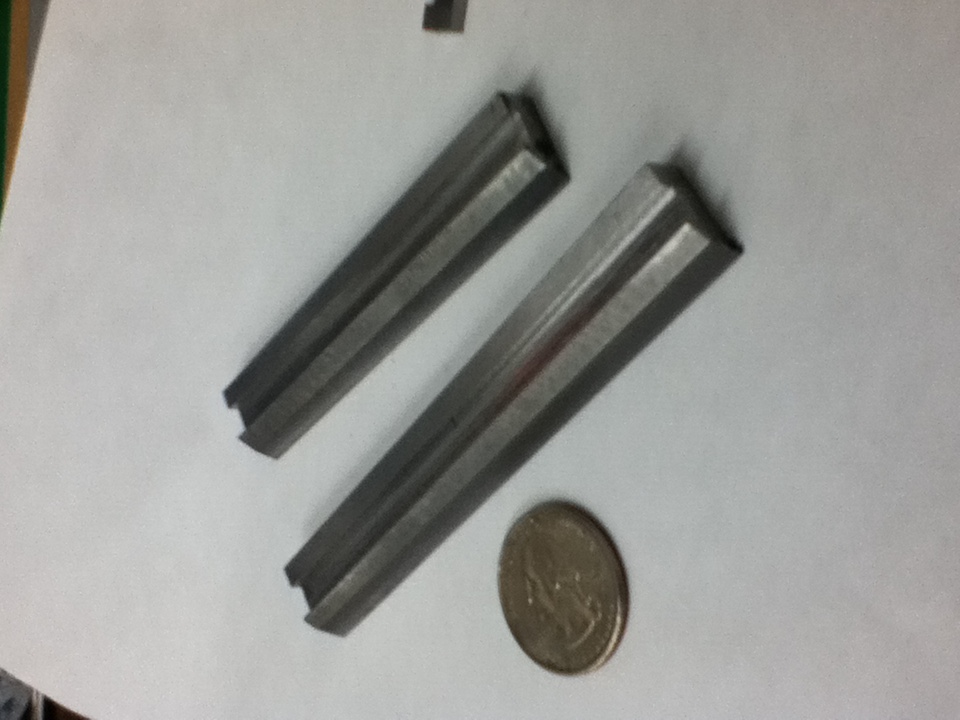

Here is a pic of what has been done to the standard configuration barrel so far. I found a local machinist who worked to my specs and a 4 3/4" barrel on the upper of my other '06AE--and VERY reasonably. He also milled me a set of tool steel bars from which to slice individual extractor blanks for the Erma KGP68a.

File Type: jpg 6x 30 Luger barrel--old style from new style.jpg (133.0 KB, 449 views)
File Type: jpg 6x 30 Luger barrel--old style from new style 2.jpg (127.7 KB, 468 views)
File Type: jpg Erma extractors sliced from milled bar.JPG (179.2 KB, 450 views)

He might do it again. The work cost me $100 plus materials, and this included milling 2 bars of tool steel to Erma extractor profile, slicing a few blanks from one bar, and turning a couple of little plungers that help the retractor's spring interface with a small notch on the back of the extractor. I thought it was a great bargain and was pleased to have found him to do this kind of work. The profile actually has an area towards the breech that is not straight. He turned the front end of the barrel first and left a portion of straight turned cylinder shape towards the back in order to hold onto it better while milling the barrel band down. Re-establishing the continuation of the tapered cut is where it's off, but I'll be able to straighten it out on my own equipment. He said he'd do a project or two in the future, but basically has shifted his interests from guns to clocks, and would prefer to work on them instead. Go figure.
