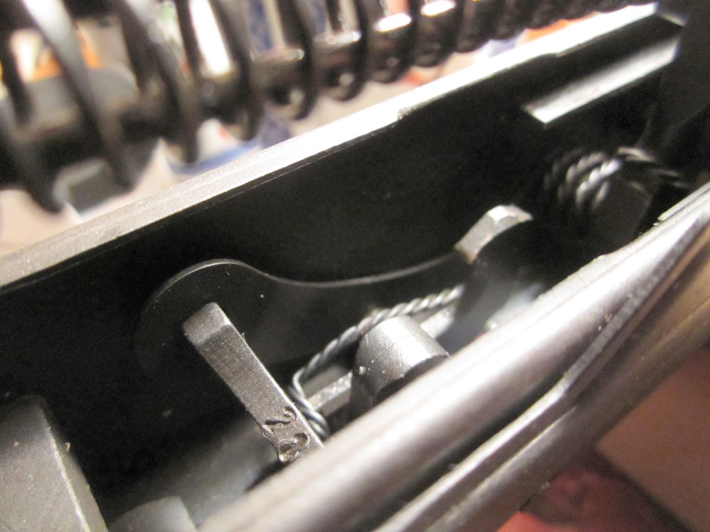

Plate arrived. It works, but it's a little bit loose. I bent its back end more, so it also performs like a flat spring compressed a little bit by the safety pin, then the loosing issue disappeared

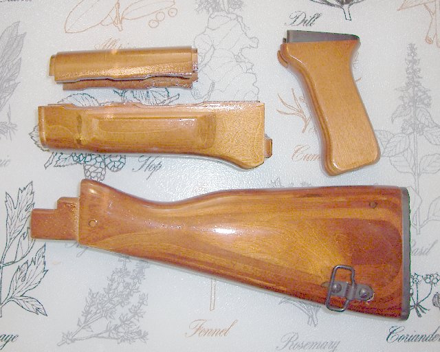

My Sportsman's AK stock set was delivered today...By Fed-Ex...
(It appears that instead of leaving it at my door, or my side gate, they just threw it over the fence...)
Anyway, pics below, shown compared with my other fixed-stock AK...Both with rods, which need the cross-tool from the 'cleaning kit' to poke through the big end of the rod for use as a 'handle'...
The Sportsman's 4-piece set doesn't look too bad; varnished, but Metric plies, so probably Romanian like my two parts kits...3 of the 4 pieces slid/screwed right on, the lower handguard was too long and needed a lot of trimming...
Buttstock only has 12 3/4" length of pull...I like a longer buttstock, as well as one wider/taller...
Definitely not military issue...Wish it was; I like battered furniture...
Haven't decided if I'll strip the finish off...The varnish is actually well done, no runs, no sags...
Much better looking than the ugly brownish-purple plastic furniture the Romanian parts kits came with...

Your new stock looks very cool.
