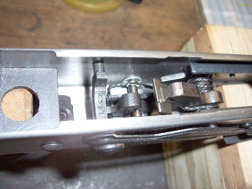

Visited store and inspected another Cugir WASR-10/63 rifle. A little bit surprised. Originally, I thought I deformed the Shephard's Crook when I took it out so it does not work anymore after I put it back. But inspecting another WASR indicated that was not the case -- on this WASR in store, the position of the crook is too high and it does not even touch the groove on the trigger pin, the pin does not fall out simply because attrition with the receiver !! Then, I am sure this pin will come out one day or another in range, inevitable.

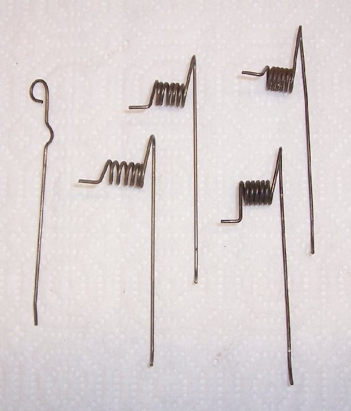

Is this the 'shepherd's crook' on the left??? I have to admit I don't know how it goes in anymore...I think it went under one pin and over the other...But I don't remember where/what anchored it...

Thanks for the pictures. It's interesting to notice different manufacturers having different versions of this pin retaining wire. On WASR-10/63, it looks different. Please note the wire does not positively lock into the trigger pin groove. It marginally touches the trigger pin!! No wonder the trigger pin could drop out during firing. I can blame Century Arms for their low quality, and work around the problem by rearrange the position of the folding a little bit, but I will go the better way -- install a pin retaining plate into this rifle.
