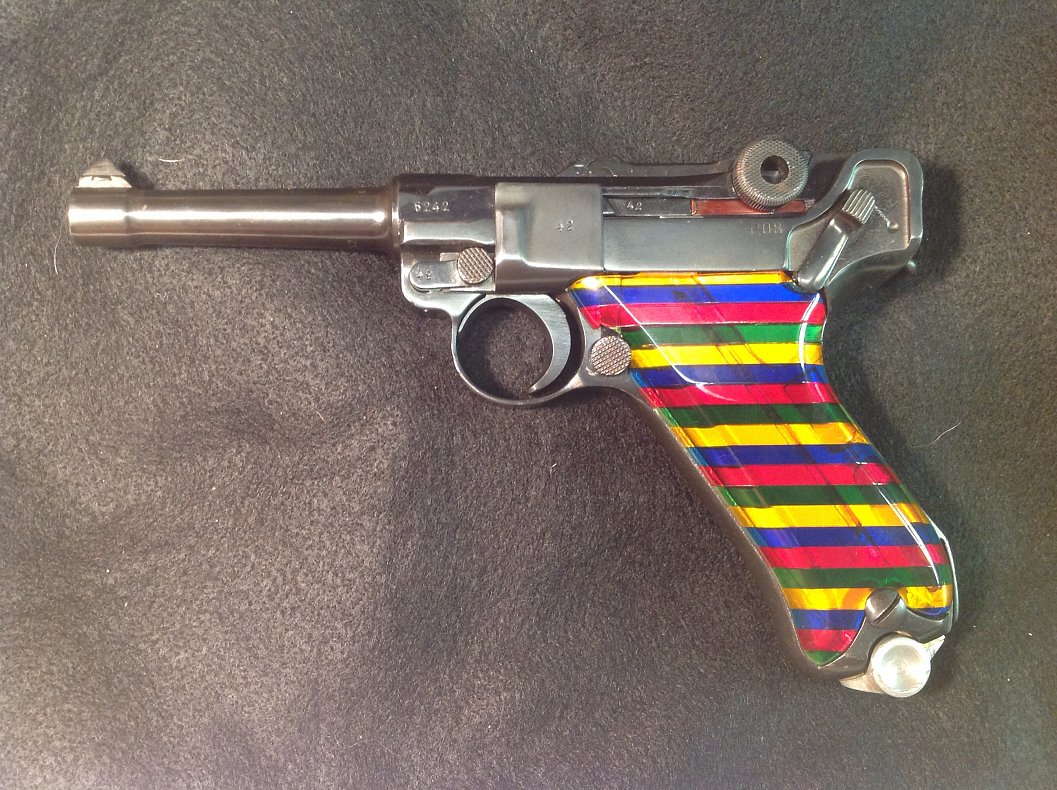

Oh, and I think you guys may get a kick out of the grips my father added. (I have the originals as well.) I always thought he made them, but now I'm not so sure.

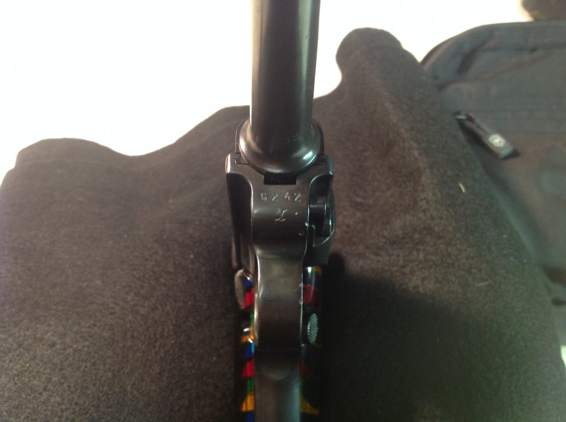

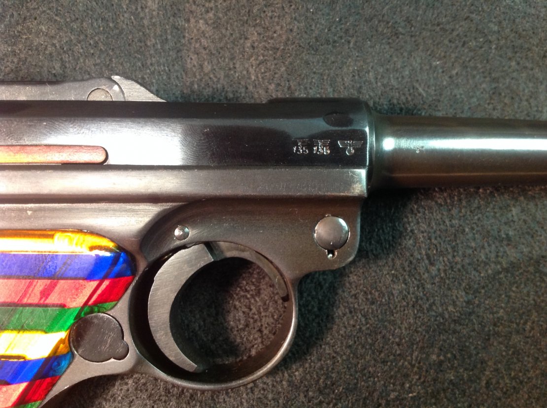

With all original parts, in original finish and 95% condition, it would be worth $1400-$1500 to a collector, and more at retail. If the magazine is original and numbered to the gun properly add another 35%-40%. Post some closer detail pictures and we might be able to tell you if it's original finish.
These guns were completely salt blued, and should show something of the surfaces grain and machining in some areas. if the edges are rounded, it is refinished. If they are sharp it might be original.
My first impression is that the frame edges are rounded, and that it has been refinished at some point. If that's true, it is a shooter grade gun, worth $1000 or so. You can also look for any pitting and see if it has been blued over.
As collectors here, we prefer Lugers in their original configuration. That said, your grips are pretty unique.

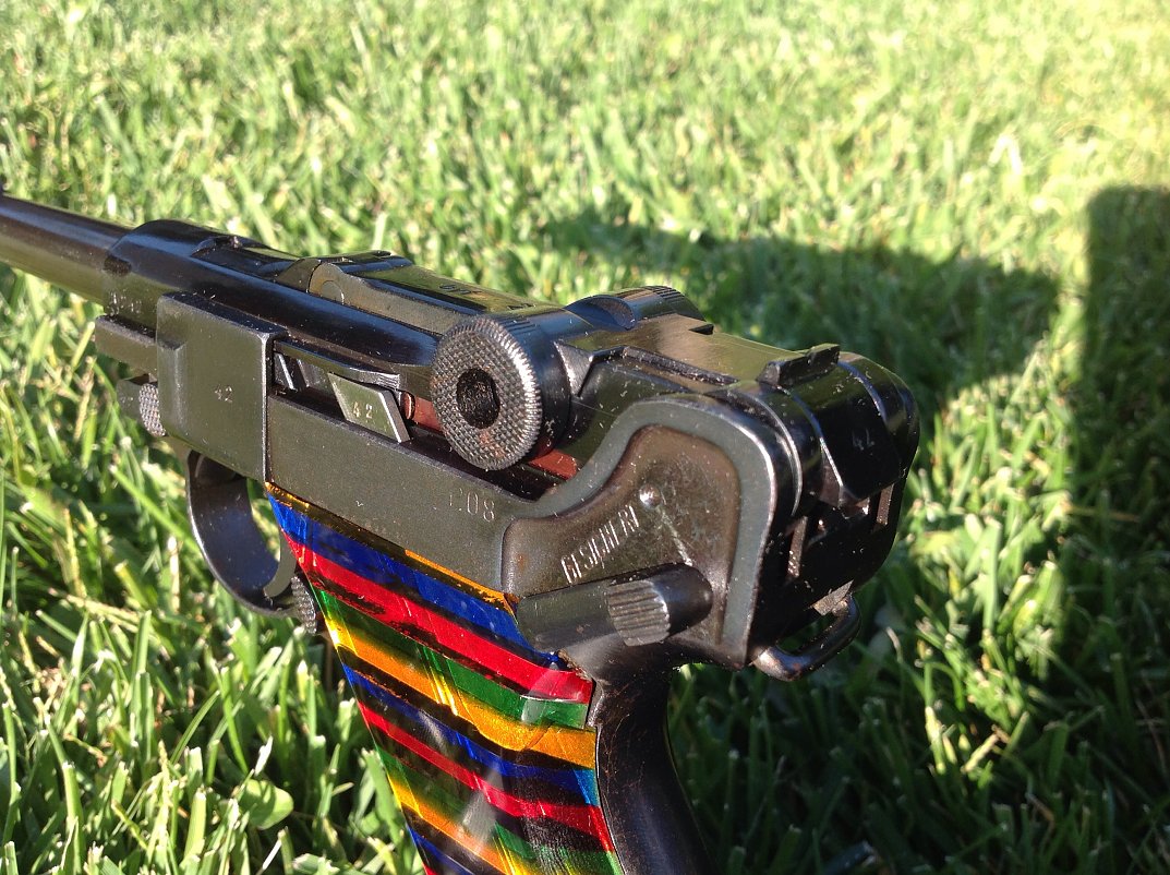

Thanks for your feedback! I was planning to fire it (I've had a couple gunsmiths look at it and pronounce is safe for fire), but I think I'll wait until I've got a better idea if the blueing is original or now. The magazine does not match and the back sides of the original grips are pretty much free of markings, though I think I can just make out some faint depressions that might be the number 42. I plan on doing a rubbing to see if I can confirm that.
I'll attach some more pix. Looking at the various markings under the microscope indicates the edges are nice and sharp. I'll look again at the various edges to see if they're more rounded than sharp, but I sure would like to find someone knowledgeable in my area to get their opinion.

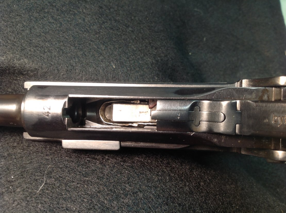

Here's a couple more pix:

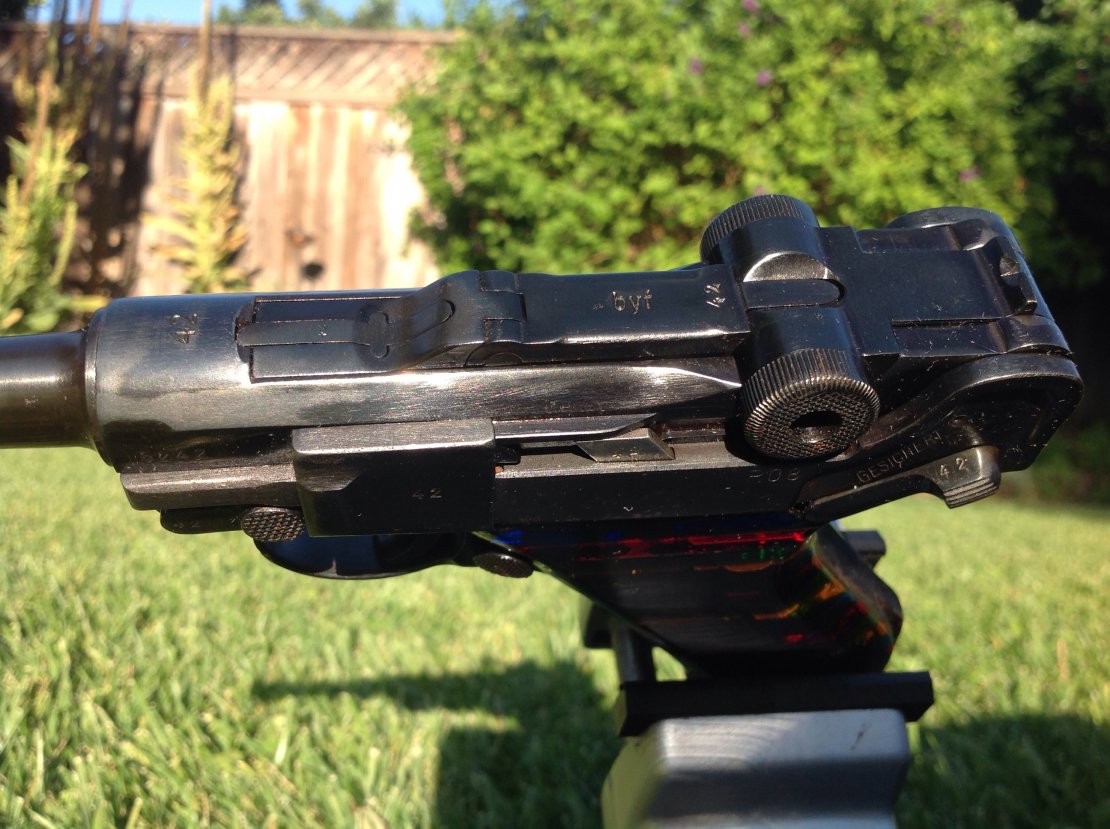

And:

I have never seen a sear bar spring a red color like that but it goes well with the grips!
Appears to be a reblue to me.

Re-blued. Notice the lack of paint in the safety printing? It looks like a very nice Luger, and one that I'd like as a shooter (with different grips), but it has been refinished.
Thanks for the feedback. If you zoom in on one of the earlier pix, there is color in the safety printing. 'Least it appears so to me.

where can i get grips like that

He says he has the original grips.

That's one way to ruin a nice Luger.
Yep, I've got the original grips. I still think the grips are interesting because they're a variant of what are called "sweetheart grips". Back in the day, Lugers were fairly common so modifying them wasn't a big deal.

Edges are very rounded so looks refinished. I would value it at $800 because of that. Krausewerk in San Mateo is the local Luger expert.
