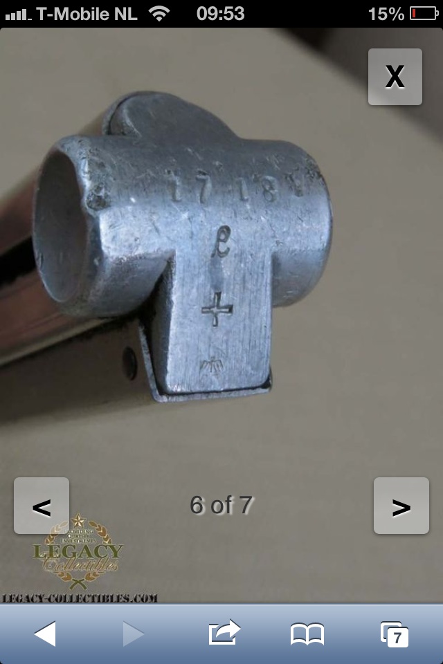

Hello Guy's ,
Could someone help me to identify this magazine ?
Altough it's quite clearly stamped, I can't make out the suffix ( h ? ).
And what year is it ?
I'm looking for a correct magazine for my '36 S/42 #9367k.
Thanks in advance.

Your suffix appears to be an "e", but this magazine has been scrubbed and renumbered and is not in the best condition to boot.
It may have once had the desirable stick eagle over "63" acceptance proof, but it is impossible to tell now due to the grinding it endured.
If you want a quality magazine to complement a quality, collectable pistol, this isn't the one.

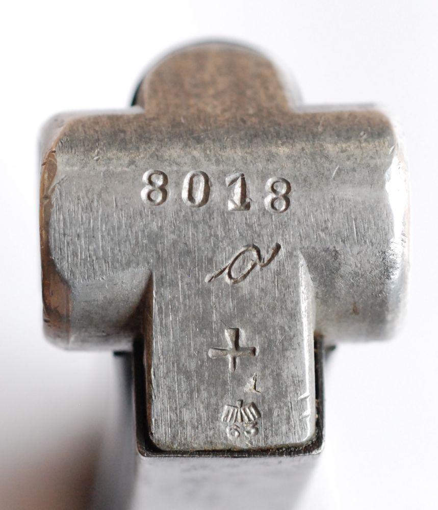

I have to disagree with Doug, I don't think this magazine has been renumbered. Early Mauser magazines were sanded at the factory prior to numbering to remove a casting line, the photo shows one of mine. The droop eagle/63 inspection mark is correct for 1936, but the e suffix, I believe, is late 1935.
Regards, Norm

Sorry Norme, but I have to concur with Doug... I think the magazine has been renumbered. It may even be possible that it really is a "o" suffix just like your magazine...
Just my $0.02
And ZX-10R,
you better charge your cell phone battery... you are down to only 15%

I'm not that sure that there was a previous number as "if" there ever was some sort of sanding, looks more on the suffix side rather than on the number area. But I' m not sure at all about it.

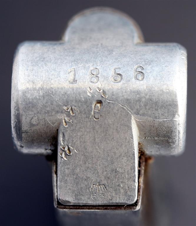

I'm thinking your magazine is worn but correct. Here is another close G date "e" suffix to compare.
Tom
