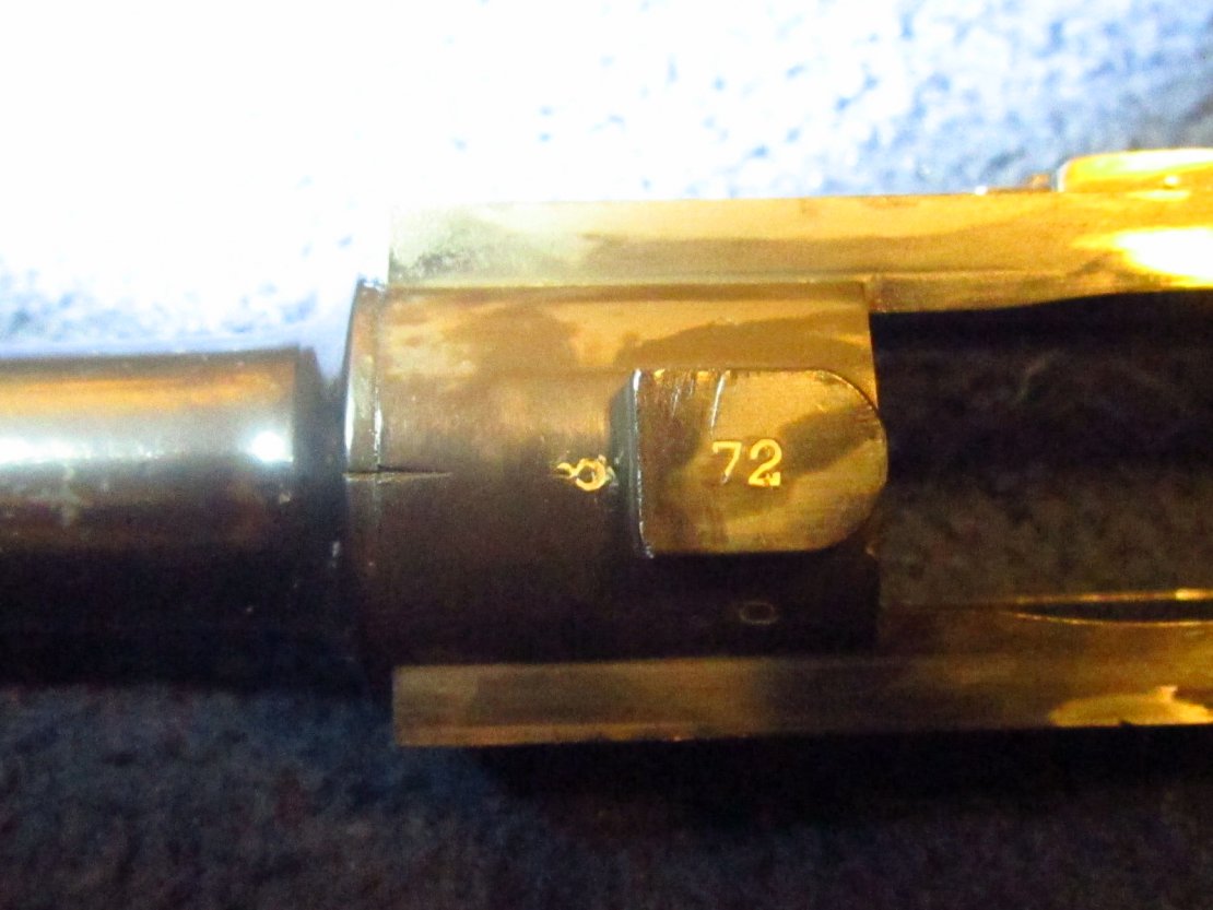

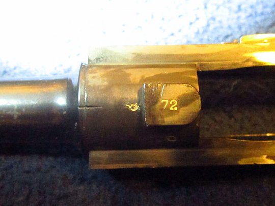

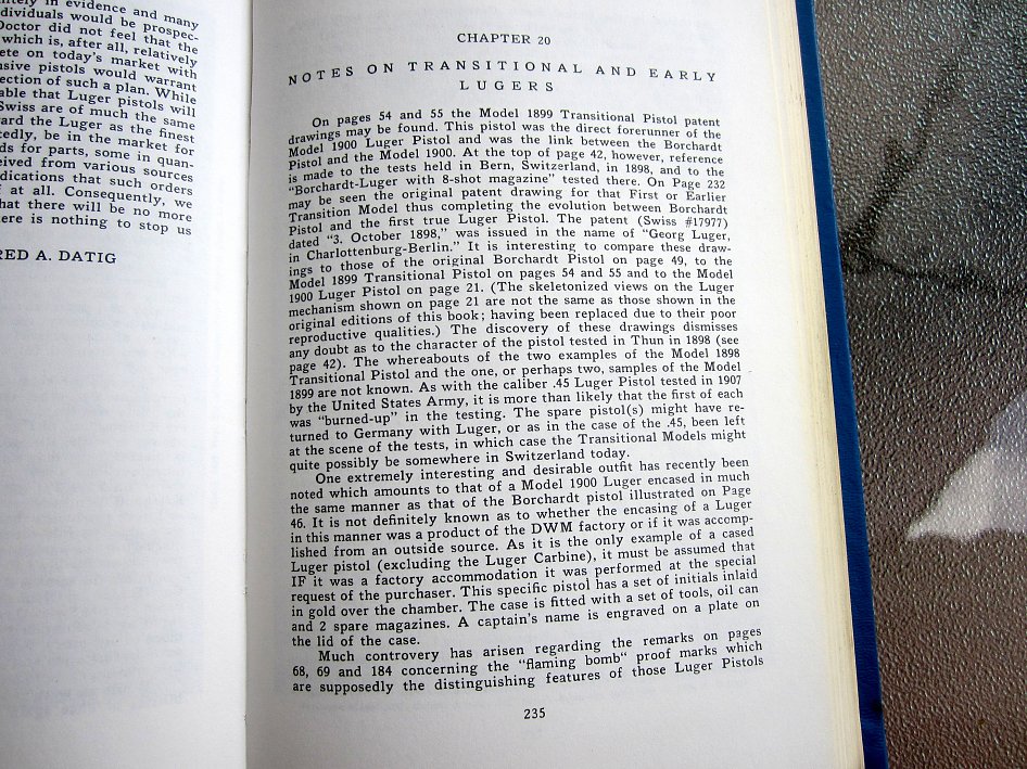

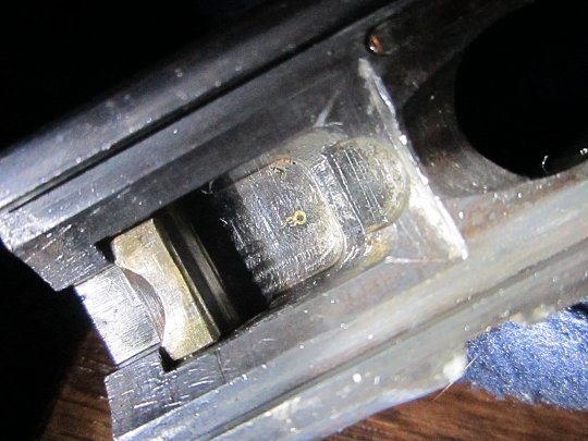

Unread 06-22-2013, 12:35 PM   #14
Fred Datig addressed the issue~~
