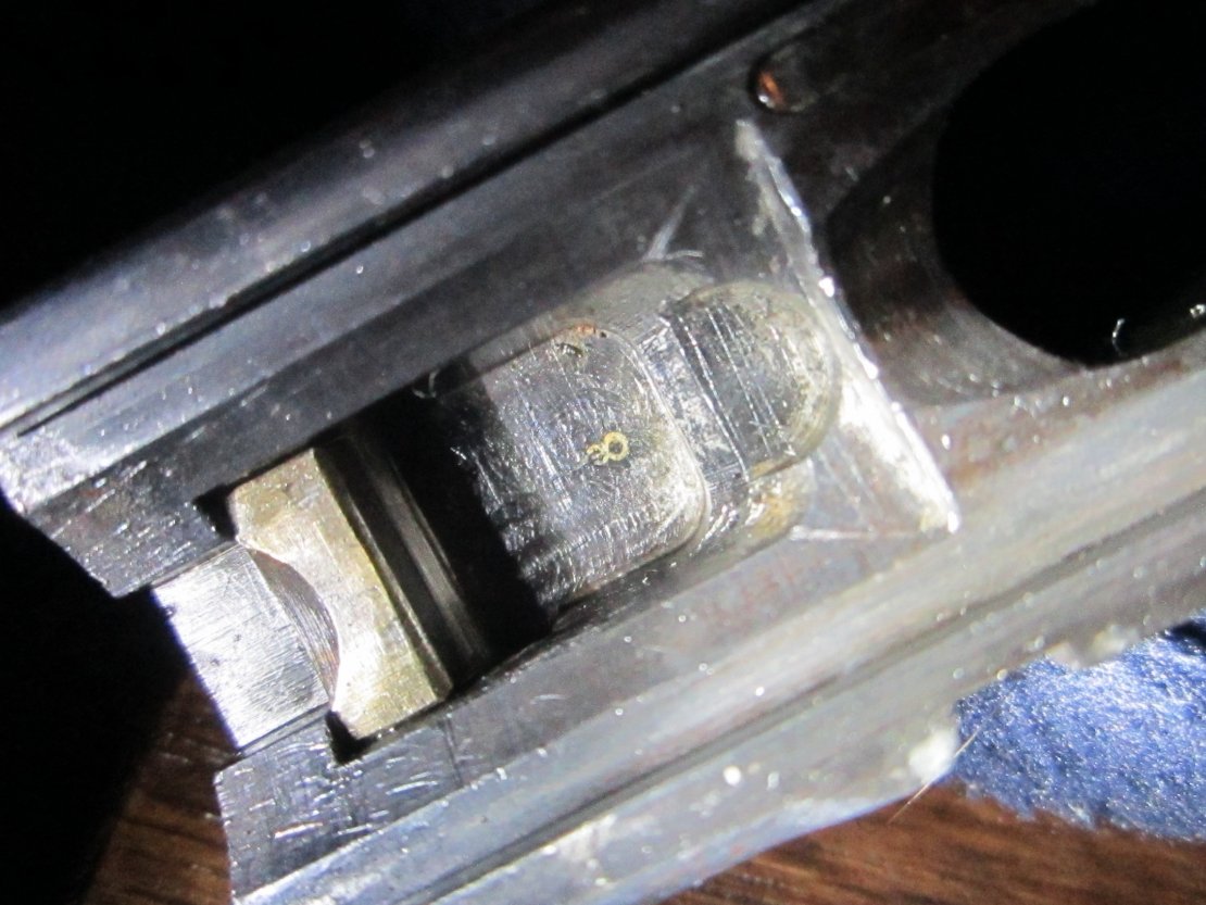

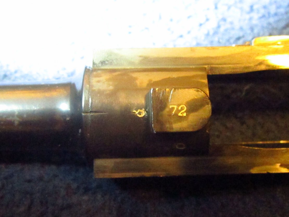

skeeter4206 06-19-2013 10:24 PM
2 Attachment(s)
My 1900 AE is outside of the test luger range and it has the flaming bomb stamped on the inside of the frame and on the bottom of the upper receiver. But the magazine just has Germany stamped on the bottom.
Attachment 34511
Attachment 34512

Skeeter, The "Germany" marked mag bottoms, just indicate that these mags were imported into the USA separately (not as part of a pistol) as spares. TH
