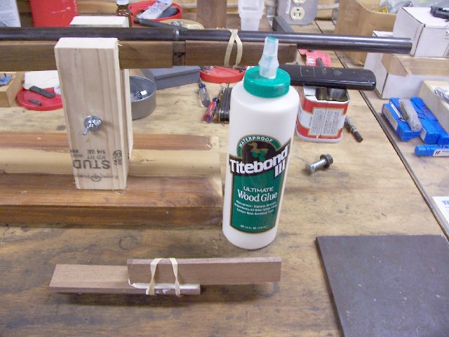

I was able to get out to Home Depot today and got a bottle of Titebond III (Ace didn't have it) . They also had Titebond ['The Original'], Titebond II ['Premium'] and the Titebond III ['Ultimate']. But since y'all think III is the way to go, I bought a bottle ($8.61).
I couldn't find any scrap stock pieces that weren't usable for something, so I tried it on a pair of scrap pieces of Walnut lying around. Same end mill finish as the Mauser stock groove/tongue I cut, rubber banded together as I would the rifle stock. I'll check it in 24+ hours and see how it turns out.
I also noticed that the toe of the stock had been broken off/cracked extensively at some time in the past, and some unknown previous owner had 'glued' (or epoxied) it...I can't pull or twist it apart with my two somewhat flabby arms, so I guess it's a good join...A little off; I can feel the uneven surfaces, it'll take a bit of sanding and maybe a little filler to even both sides out...
I wish I knew what this toe join was 'glued' with, it easily passes my lax quality control for 'glued' joins...

As noted in post # 13 above, I rubber-banded two pieces of Walnut scrap together and glued with Titebond III. It's 27 hours later (instructions say fully cured at 24 hrs) and time to test the join.
First pic below shows the pieces clamped in my mill vise. I pulled back as hard as I could with both hands/arms, and could not break the join. I could see the Walnut bend a bit, but it wouldn't break. This is great! The joins I envision making are non-load bearing joins, so this would work OK.
I still wondered how strong the join was, whether the wood would break, whether the wood fibers would rip out before the glue let go. So, I put a 12" Crescent wrench on the upper piece, and gave it a go. The glue join finally broke; no fibers ripped out; no wood breaking (second pic).
Still not a failure. I won't be yanking on these joins on the rifle. The only negative I had was when it came time to clean off the surfaces. The glue itself would not sand cleanly; it was semi-flexible and 'peeled' rather than sanded off. That could be a problem when sanding down the join or using it as filler.
