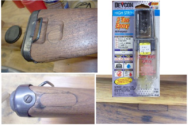

We all use what we're most familiar with; with me, it's the polyester resin. I mix it with paint if I want to give it color; or with sawdust to make a filler for filling small holes. Occasionally I'll cut a piece of hardwood to make a patch and use the resin to 'glue' that in place (see pics below).
One other outstanding 'glue'/epoxy I've used is by DevCon ["2 Ton Epoxy']; it comes in a big syringe with two chambers, epoxy & hardener; you push the plunger in and it mixes as it comes out. Unfortunately, it has a short shelf life when opened...
(No, these plugs are not pretty...)
