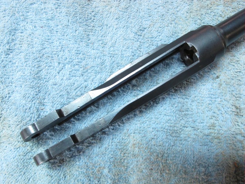

Default How to fix a bent barrel extension?
Does anybody here know how to fix a barrel extension with a bent rail? It's about 1/8" off at the very end, and it seems to be bent right behind the chamber. I'm afraid to just try and bend it back, would rather leave it to somebody who knows what he's doing.

Hi Olle, It can be done, but you have to be carful?? Also, you have to get it right pretty quick, as the are probably not dead soft and maybe will crack due to work hardening or temper... But, you'll get a couple of shots at it... you need, a good vice, some brass, steel, and probably some aluminum plates and pieces... First things first, using a digital caliper, measure across the width at the chamber, this is your base measurement... next using a machinists straight edge, or square.. check along the sides using the chamber area as your guide, and see which rail is bent, either in or out, or perhaps even twisted some... Then it's just a matter of, blocking, spacing, clamping, SQUARELY, the receiver in a vice with protective blocks, and springing the rail slightly past the yield point and check for straight... over and over... also, holding or clamping a long vertical straight edge on the receiver sides at the main pin area, will show if you have twist... again, clamp some blocks on it and twist it back, with a little bit allowed for spring back as before... It should display some memory, and you will be surprised how close you can get it...Just make sure of where you want it to yield.. as you don't want wowies... ... When the back is square and straight, it sould measure within .002" or "003". probably +.000" /- .003", You'll know a hell of a lot more when your done! .... best to you, til...lat'r....GT...
Do you mean the 'fork' is bent-in one hundred and twenty-five thousandths??? That should show up on a picture pretty good, but I don't see it...
I've had a twisted and Z'd Luger extension back in the 80's...Took a long time to get it straight...Months, maybe even a year...Nudging it a bit more every couple days...When I was done, It was straight again, and I looked at it and proudly said...
NEVER AGAIN!!!
Box yours up and ship it off to Gerry Tomek.

I measured with calipers and it's more like 3/32", 0.095" to be exact. You can't really see it in the picture, but the right rail is bent pretty bad.
The left rail appears to be straight, so I was thinking along the same lines as GT: Clamp it in some kind of fixture, then bend it a tad over to allow for springback. What I had in mind was to clamp the left rail to a straight surface, and also clamp the chamber really tight to make sure that the left rail won't bend. The next step would be to fabricate a small machinist's jack, set up a dial indicator and start spreading it about 1" or so behind the chamber. Spread it a bit, take a reading, check the result, spread a bit more, take a reading, rinse and repeat until it's straight. A slight "Z" won't bother me all that much, this will be refinished anyway so I'd rather file/polish the last few 1/1000 than working it until it cracks.
Then again: I might chicken out and I need for someone to remove the barrel as well, so are you up to the challenge, GT?

Sure thing! I'll certainly give it a go.... But, send the toggle train with! Best to you guys, til...lat'r....GT

Part of the problem with 'spreading' the sides is that both sides want to spread at the same time whether you support them or not...I toyed with the idea of making a special mandrel to insert into the receiver, with a drilled & aligned hole for a 8.82mm rod that would enter the barrel...Then you could work on 'spreading' the sides one at a time...
I do have a brass receiver insert for my barrel swaps; in an emergency (which is doubtful in my future) I could drill it and insert a squib rod to make a shade-tree fixture...But that axle pin is the most oddball size ever designed; not Metric and not Yankee...Not Inch, not Letter size, not Number size...You'd have to make up a special pin (or use a spare axle pin) to test your alignment after every tweak...
...Or just box it up and send it to Gerry!!!

I was thinking about supporting and clamping the barrel, instead of using a rod in the bore. If you lay it flat on its side and clamp it both at the muzzle end and right at the chamber, you would only be bending one rail... or?
But yeah, boxing it up and sending it to Gerry sounds like a safer alternative.
Just out of curiosity, where do you intend to apply pressure on the rail to bend it???
BTW, is there an amusing story behind how this rail got bent???
(Mine got bent when I removed the barrel without proper tools)...

My approach would be to lay it with the left side down on a fixture (for example, a heavy aluminum block) and clamp the barrel, the chamber and the left rail securely. This would leave the right rail unsupported. Then I would insert a machinist's jack between the rails and push, while reading with a dial indicator at the end of the rail. I can make a spacer block (using another Luger to get the correct dimension) to get a fairly accurate base reading for the indicator, then I'd push beyond that a bit.
After doing this in increments a few times, I should get a pretty good idea of the springback. After the final push, it should spring back to the base reading. I'm sure there will be some fine tuning after that, but this should get it back within reasonable tolerances. Well, that's what I had envisioned anyway.
It was bent when I got it so I really don't know what happened to it, but it takes a lot of force to get a breech block in between the rails so somebody must have squeezed it pretty darn good. There are some bad diagonal gouges on the rails, almost like the extension has "derailed" at some point, and I'm sure that this has something to do with it. I might even take it to a machine shop to have it crack tested before I go any further, I definitely don't want it to break.

Here's another caution to consider: When bending a steel structure to and fro, forces act upon the weakest area along the length of the piece. In the case of the Luger barrel extension, this would be the square, inside corners, where each rail of the extension joins the main meat of the chamber/receiver. When flexed, and particularly if the steel is tempered a bit, this sharp corner will be the first place to show it when the steel begins to tear.
My advice is to stabilize this area with a clamp so that the area in question is not subjected to these forces. Clamping/fixing the part in place is paramount; and all deflective forces intended to realign, are best applied with a clamp, as well, for optimal control, to gently squeeeeeeze. Avoid sharp blows to the setup at all cost, even with soft or padded whackers.
Of course, the safest way is to forge/heat bend the offending arrangement back into submission. However, this would likely mean the part would need to be heat treated all over again. Metallurgically, this would be no big deal, but you'd kiss your finish goodbye, that's for sure.
I had occasion to perpetrate such a disaster upon myself a couple of weeks ago. I'd acquired a stripped frame for an Erma Ep.22 -- their second crankiest gun -- and when the upper arrived from another source, it was bent; BOTH ways. I succeeded in straightening it the hard way first, removing the dip in both rails from front to back using the clamping method to displace it just enough to overcome springback, plus a tad. Now the extension would actually slide into the frame!
My setup for straightening the length of one side, flat-ways -- theoretically the easier of the two ways it needed to move -- was deficient in stability and approach! I'd previously brought a couple of sear housings for these pistols back into true by laying them flat on a non-marring surface and tapping down the high areas with a padded instrument. However, the vibration involved in doing this with a Zamak upper was sufficient to snap off the entire extension and barrel from the side I was working on. Ouch! a $100 mistake, as it turned out... I'd attempt it again, but would use a better setup that would use a clamp instead of a dead blow hammer!

I know what you’re saying, and work hardening is another problem. This is just a slight bend so it’s hopefully not enough to work harden the steel, but I’m sure you know that when you try and bend something back, it won’t necessarily bend in the same place. Many times, you’ll end up bending it right next to the first bend, so some heat may be necessary to prevent this.
I’m not worried about the finish though, it's going to be rebarreled and refinished anyway. By the way, the barrel has a big dent at the muzzle end, and I wouldn’t be surprised if this has something to do with the bent rail. Some people just love to use the BFH for disassembly.
