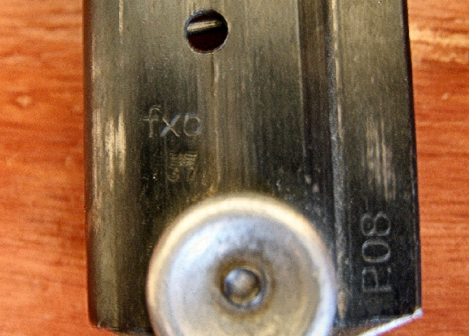

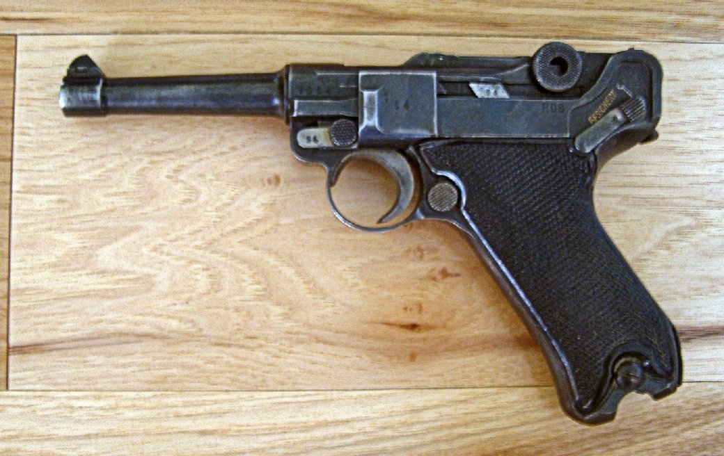

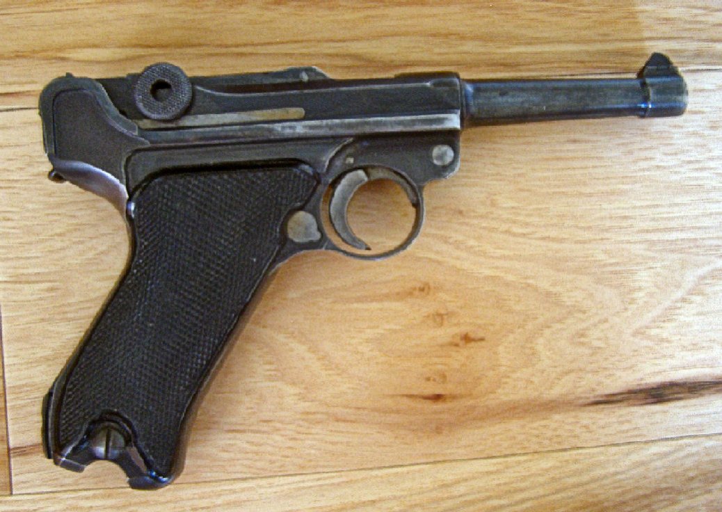

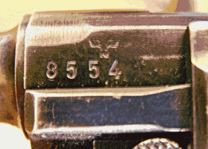

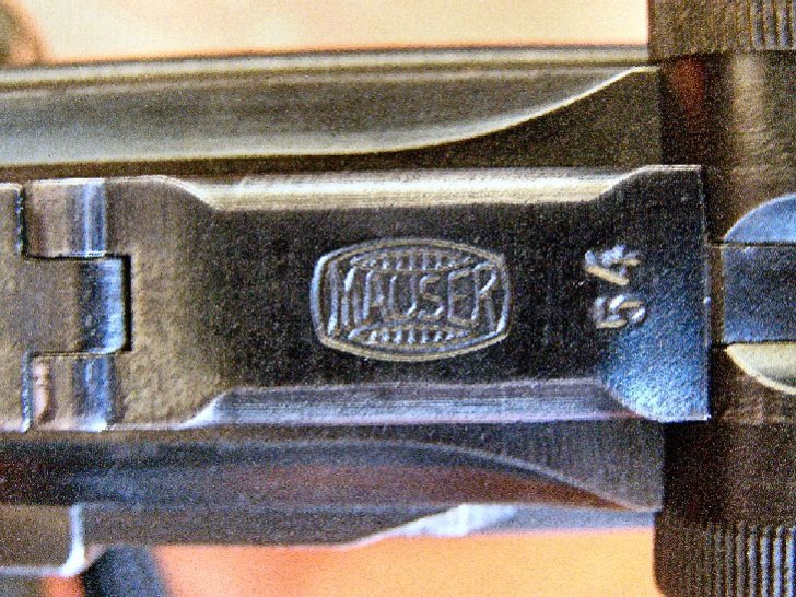

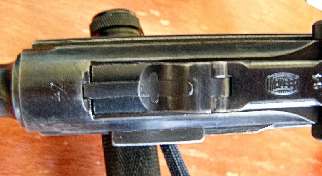

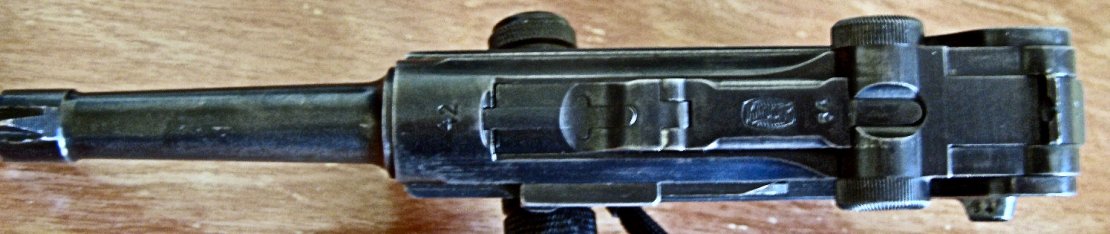

I have a P08 that I need some help identifying and an opinion as to price. This came from a friend of mine who's Dad was stationed in Germany for a time immediately following WWII.
The pictures would suggest that what he has is a "Mauser 2 Digit Date" Luger and given the shape it's in, I'm guessing might fetch between $1500-$2200. Did I get the identification correct? It also looks like the holster may have been bought at the PX? Is it American or German? The pistol has 1 matching magazine and one aftermarket magazine with an aluminum base and a stamping "MADE IN DENMARK".
All the components are matching numbers. It has some bluing wear from the holster but the chamber and barrel internals look practically new. This is the first anyone has seen this gun since WWII Germany!
Any help would be greatly appreciated.

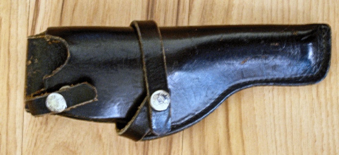

I think that the value is likely if in good, matching condition, if in really good condition, towards the higher. The thing is that the pictures are not clear enough. It is a Mauser Banner, two digit, meaning it went into the army.
The holster is just a commercial holster, low value, but nice to have.

I am curious what you mean by the mauser two digit. Is it the fact the year on the top says "42" instead of "1942". And if the two digits went into the army saying "42", is there a commercial style mauser that says "1942" on the top of the gun?

Some 1942 chamber dated commercial mausers were ordered by police according to police lugers book.
looks good I would say 86 percent blue , 30 percent straw. but what do I know .

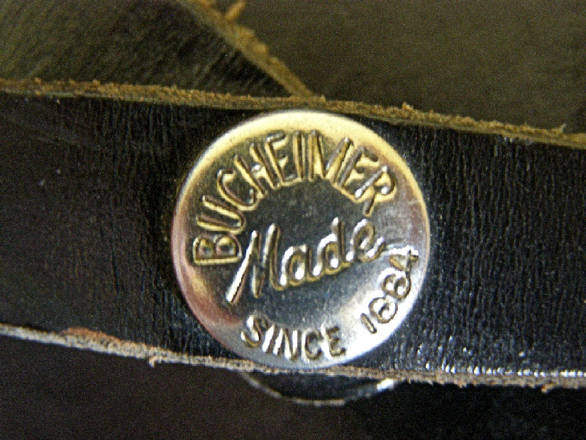

bucheimer isnt around anymore my .22 cowboy action sits in one of his holsters.

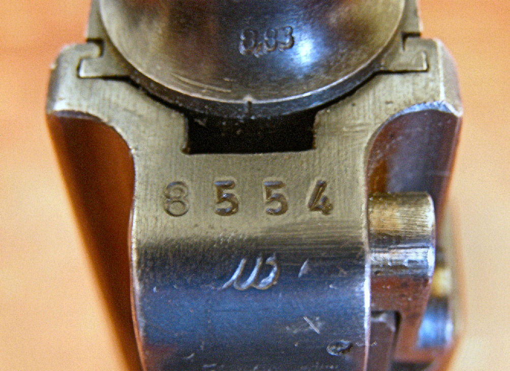

This looks to me like a 42 dated Commercial Banner. It is in the correct serial range, commercially proofed, has straw parts. Is there a Eagle over N on the front of the sight block? Is the barrel serial numbered? Is the barrel marked s/42? Is it 9mm or 30 caliber?

The proof mark looks like the Mauser #48 proof on this forum's ID page. I never thought to look at the front sight base. With my old eyes, all I can see is an eagle proof mark. It looks like there might be something just to the left of the eagle but I can't make it out. I can't locate a serial number on the barrel anywhere. All it has is the air gauge size of the chamber (8.83) which I think makes it a 9mm. Every part that has a visible stamp is "54" which I believe makes it matching numbers. The bakelite grips are pristine: no cracks or chips anywhere.
My buddy is in no hurry to sell it but he has no use for it and it doesn't hold any sentimental value to him. I'm in California, so I may put it up on this site and Calguns. If it doesn't sell, I'll move it over to Gunbroker. He would like to see it go to someone who appreciates these guns. It appears much better than a "shooter" to me. I removed the slide today and it looks like it was never fired on the interior.
Thanks for the help. It is much appreciated.

I was thumbing through my gun books and found the description as "Mauser 2 Digit Date" in the 2008 Edition of the "Standard Book of Firearms" by Dan Shideler. It fits the description perfectly. He states "There were approximately 2000 manufactured for sale to Nazi political groups." He says the 2 digit date stamp was the year of manufacture (either 41 or 42). 1942 doesn't appear anywhere on the gun. Sorry for the fuzzy photos but I needed to reduce the resolution to get them down to the 200KB picture size limit on this forum. Thanks for the help!

Thanks for the information. I can get better pictures to you if it would help but scrunched them down so I could post them here. I thought the holster was probably commercial. The interior of the Luger looks new to me. If is was fired, it wasn't fired much and was well taken care of. The bluing is worn where the frame rails contact the leather, but other than that, the finish is pristine (except for 70 years worth of dust and grime).

It is a nice looking commercial banner. These pistols were sold to anyone besides the army who were able / allowed to purchase pistols. This includes private sales, police organisations, political organizations and probably some small exports here and there.
42 on a commercial version just means that they used a 42-dated receiver, that was probably left over from the military production run (which ended in 1942). Chances are that it was assembled and sold anywhere between 1942 and 1945.

These are found in all kinds of different combinations; with or without proofs, with strawed or blued small parts, with bakelite or wood grips. Over on the other site, 46 pistols have been recorded in this serial range and of those 46 there were 16 different flavors noted. Only 2000 or so of these in this particular range of serial numbers.
