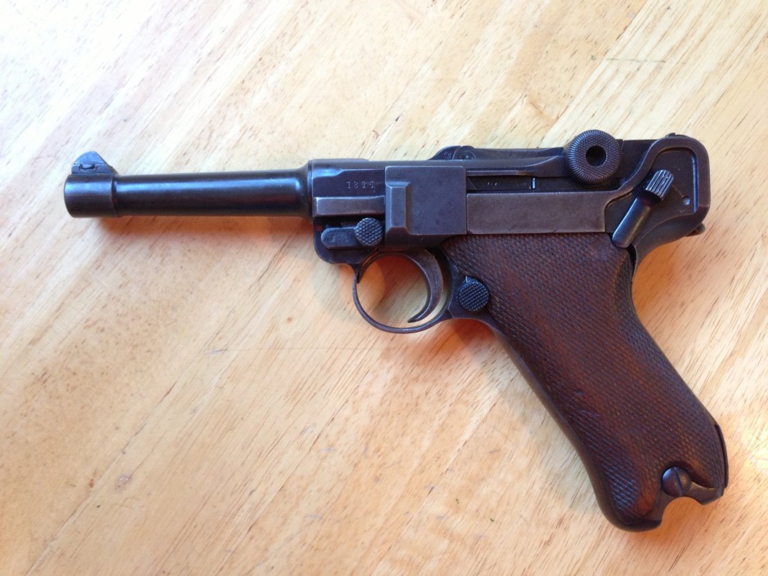

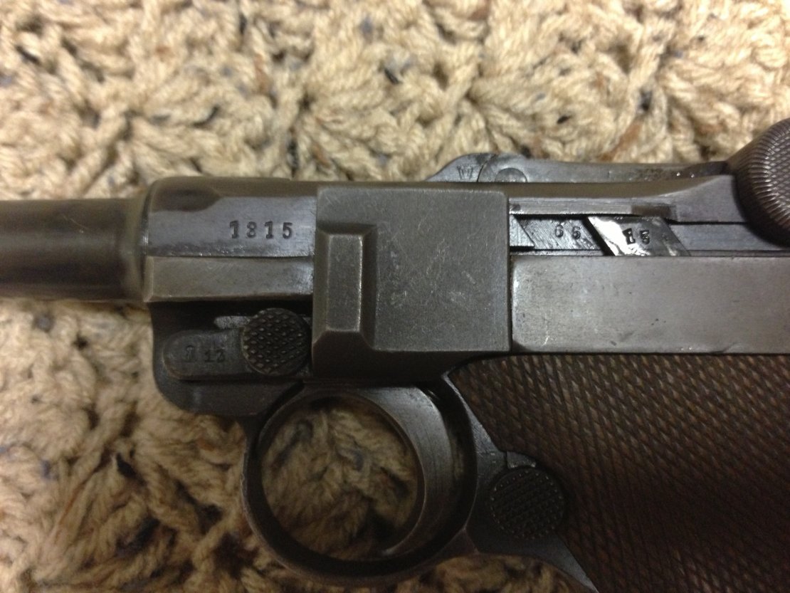

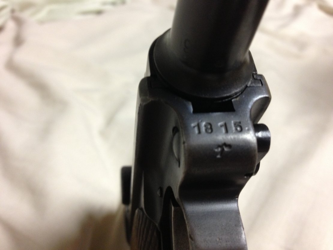

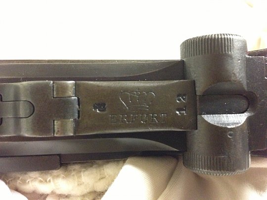

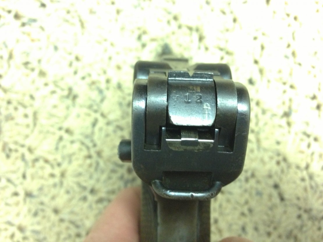

I recently purchased this and was hoping someone could tell me exactly what I have. I was told it was a vet bring back, but not really sure about that. The numbers don't match and it appears to have both Mauser and Erfurt parts, I think.
Thanks,
Sticky

Welcome to the forum. What you have is a mismatch parts Luger, which may turn out to be a great shooter, but it has no collector value.
Unread 12-16-2012, 05:22 PM   #10
Thanks: 2,748
I agree with Alanint 100%. Your Luger is composed of many different numbered parts, so it is shooter grade. If it works reliably, then you have a fun range gun that will surprise you as to accuracy. Break it down for a really good cleaning, inspection, and lubing, then take it to the range and give it a try. I would suggest that you try either Winchester or PMC 115gr FMJ ammo, NO +P, or +P+ ammo.
