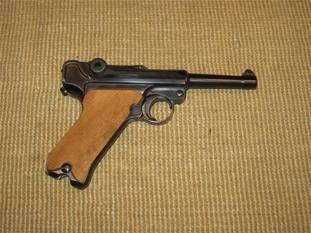

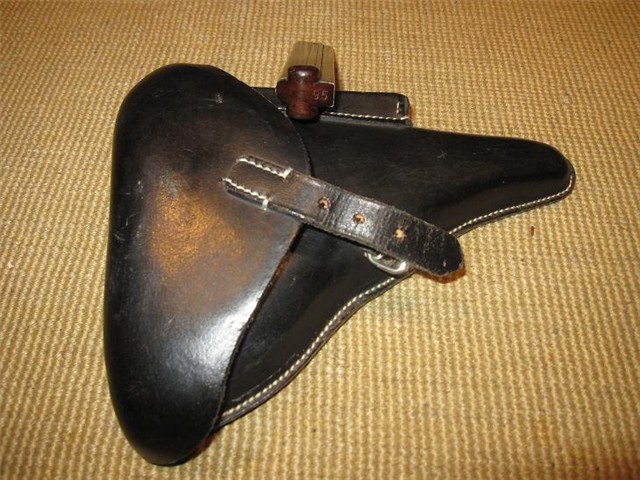

bam! you can use gunbroker to trade, I just found this all matching all original dwm commercial there.
The kicker is it has two matching mags!!! Buy Now
Unread 09-30-2012, 07:17 PM   #27
Glad you preceeded your post with a smiley face indicating a joke...as this Gunbroker offering is a joke.
