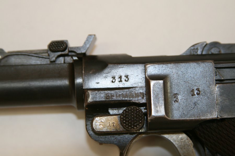

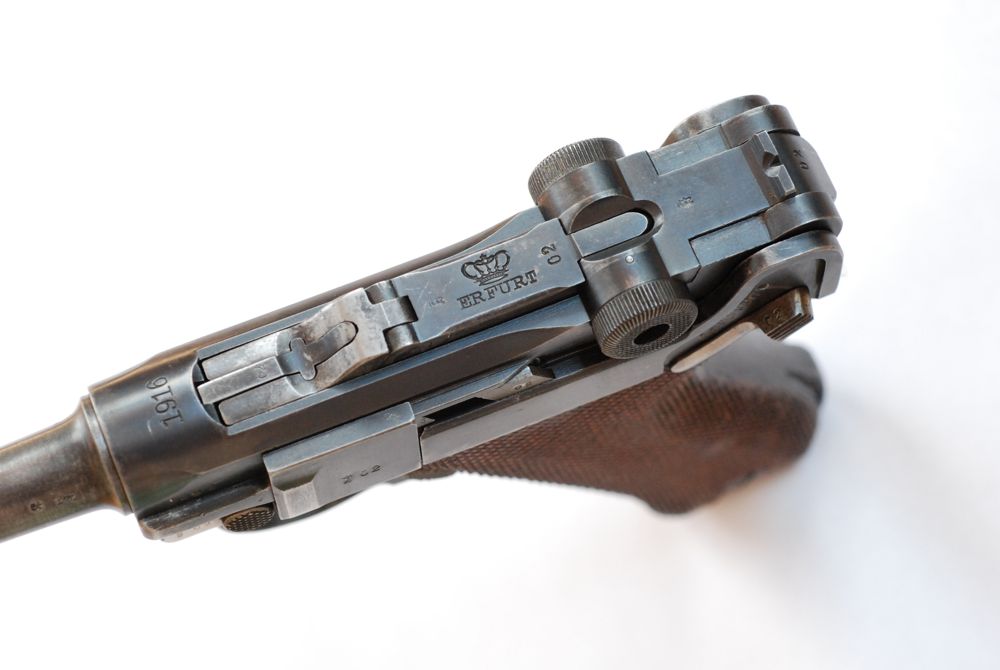

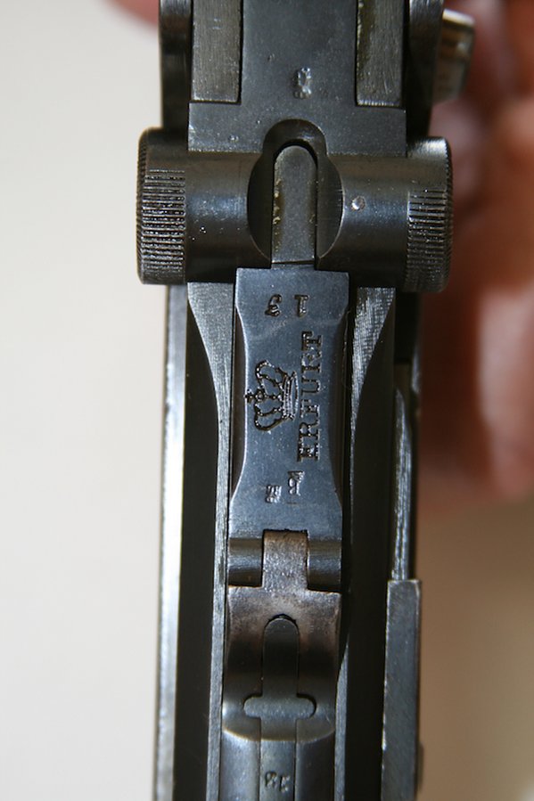

Unread 09-26-2012, 07:45 PM   #1
tm510a
Join Date: Sep 2012
Posts: 1
Default 1917 Erfurt luger
All matching serial numbers butt stock holster.

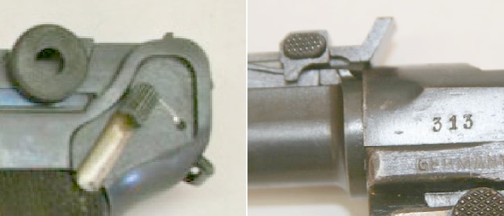

While we're waiting, let me point out that this "artillery" has what appears to be a toggle rear sight and no receiver notch...

tm510a:
Are you sure about the date? It's my understanding that Erfurt only made artillery Lugers in 1914.

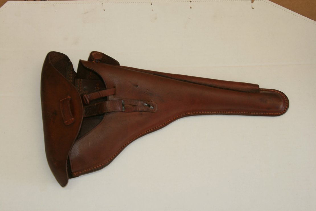

Agreed........May we see the serial numbers on the bottom of the barrel?
Also, someone has modified the holster's closure strap with crude staples and the strap has a pearcing. It looks like a piece of an old K98 sling was used as a repair...

Hmmm, we don't know where the '1917' came from, can we guess that this non-Erfurt has a 1917 chamber date??? Erfurt toggle, artillery barrel (maybe an original?), unknown frame, buggered holster...Barrel is in much better shape than the rest of the gun/parts...Most likely a repro...Grips look awfully good...
It's probably worth more in parts than as a shooter (which is the best it can be), but I'd peg it at $700 - $800, as an ersatz shooter...Maybe more if honestly described on GB...(Gun only)...
The all-matching numbers is suspect, I'd think...
Stock-holster I couldn't put even an estimate on (not my field of interest)...
It would be interesting to see barrel bottom + frame serial...and chamber hood...

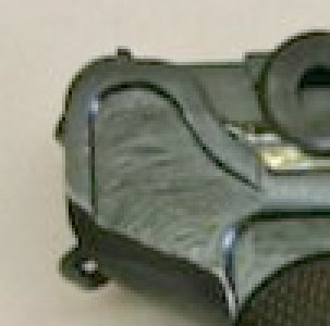

One additional comment...On the area inside the right frame ear...There is usually tool marks here, made by an end mill, but this area has...gouges...I can't even imagine what made them...
