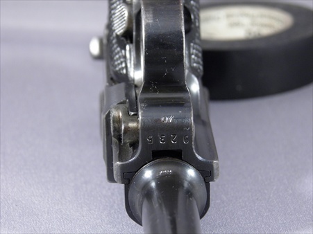

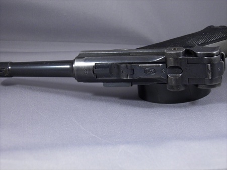

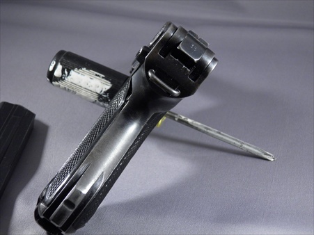

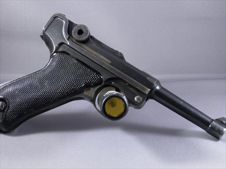

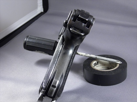

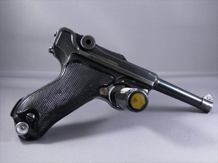

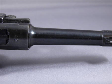

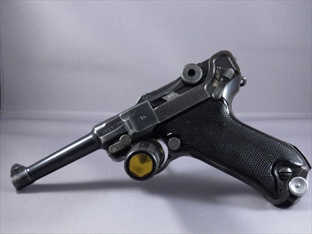

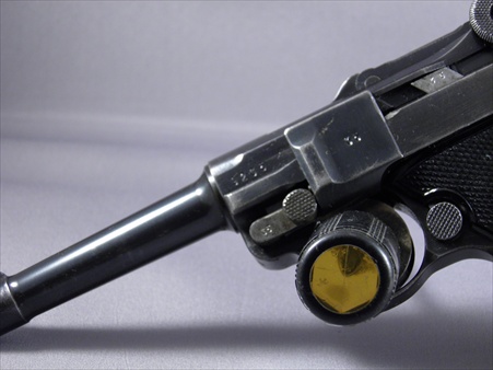

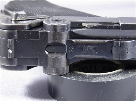

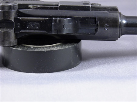

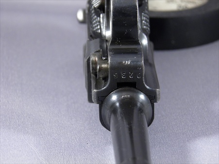

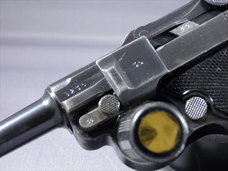

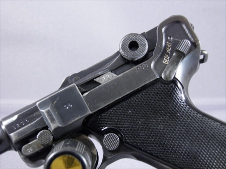

I have some decent pictures to look at.

A few more. The straw color is strong but the pictures do not show that.

It is a finished commercial luger that went into military service (see the Mauser banner and exterior marking of the serial numbers).
I would be amazed if there were not at least eagle N markings on it, at least originally it HAD to have them, or it would not have made it into military service. In addition to a single proof Eagle most likely on the barrel right, right receiver or left toggle????
Anything is possible, but very doubtful to me....

I looked with a magnifying glass along the right side of the gun and left side toggle (except #35 on the pin)and see nothing and there is no indication of metal being removed. I have not diassembled it completely but I see no other markings then what I tried to show in the picutres.
The barrel blue does not match the rest of the gun so would that explain missing marks if it the barrel was replaced ? I hope the pics were ok.

Although commercial, would this gun have retained strawing at that late date?
What about the "42" chamber date along with Mauser marked toggle?

On page 331 of Hallock and van de Kant's 'The Mauser Parabellum' there is another example and rack mate to your Luger. It is classified as a Mauser Commercial Banner, and is a "late war assembled commercial"...
Serial #9232w, only three guns apart from yours.
No proofs
Military (42) dated receiver and military P.08 coded frame
Square dot betwwen P and 08 on frame indicating 1942 manufacture
Rounded edges of late front toggle link
Strawed parts
Bakelite grips
There is another example with no proofs on page 333 which is very similar. S#9323w. Military (42) dated receiver, but has a rounded dot between the P and 08 on the frame, indicating 1941 manufacture.

A definite square dot after the P

Look at the front sight base. It may have an E/N or C/U

Without removing the front sight there is no letter pattern as described- but is this because it is not the original barrel ?

I forgot to mention, both examples I discribed above have barrels stamped with the bore gage only. No serial #'s, like yours. Except for one digit of the S#, your Luger is exactly the same as #9232w, on page 331. I believe it is all original including the barrel.

It gets interesting. Is there an estimate of how many that were put out in circulation ? Would this be a war gun or does that go under anything is possible ? The grips indicate to me honest wear.

Technically it is a commercial. There are no military or police acceptance stamps.
