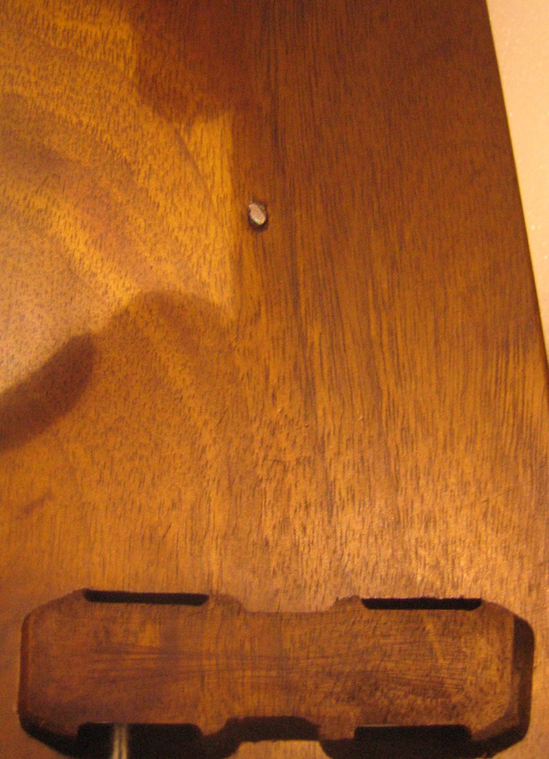

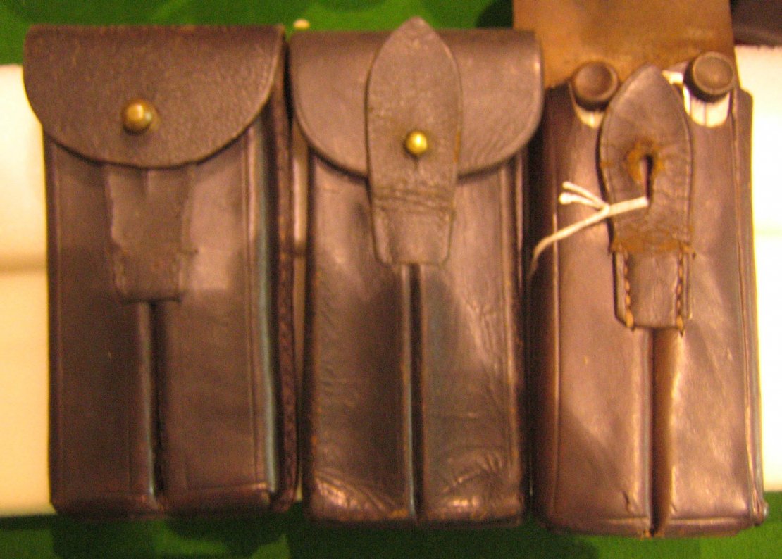

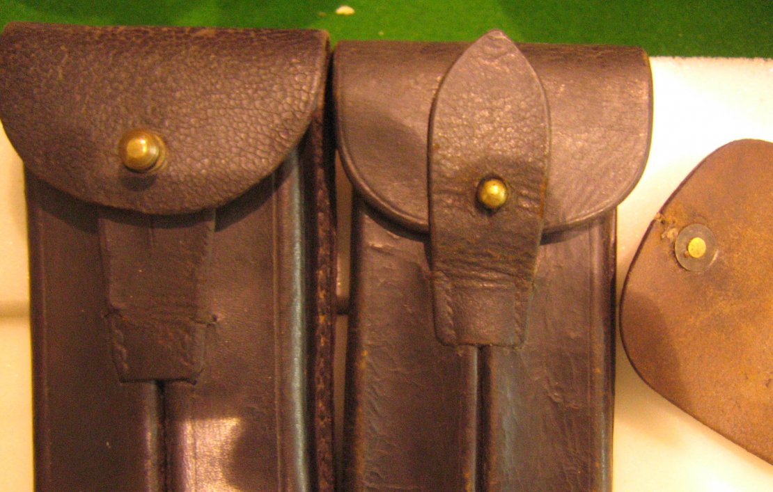

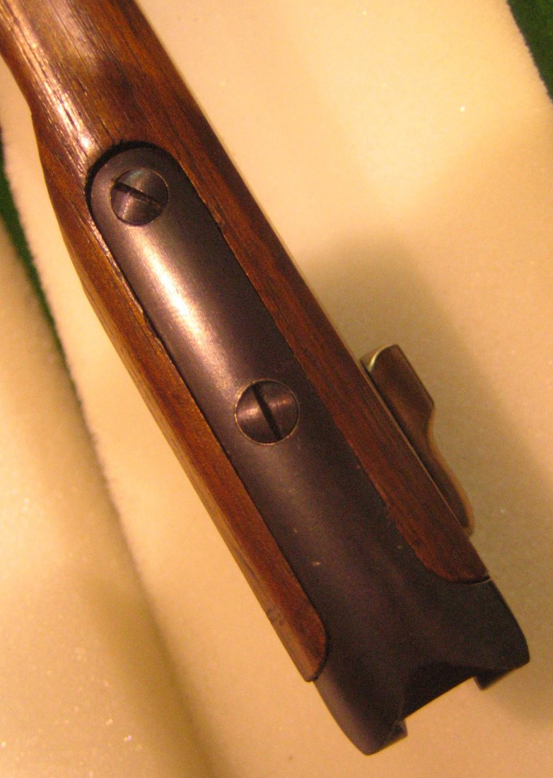

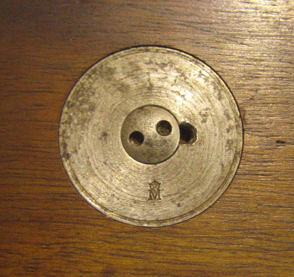

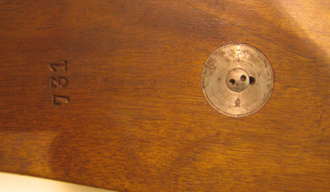

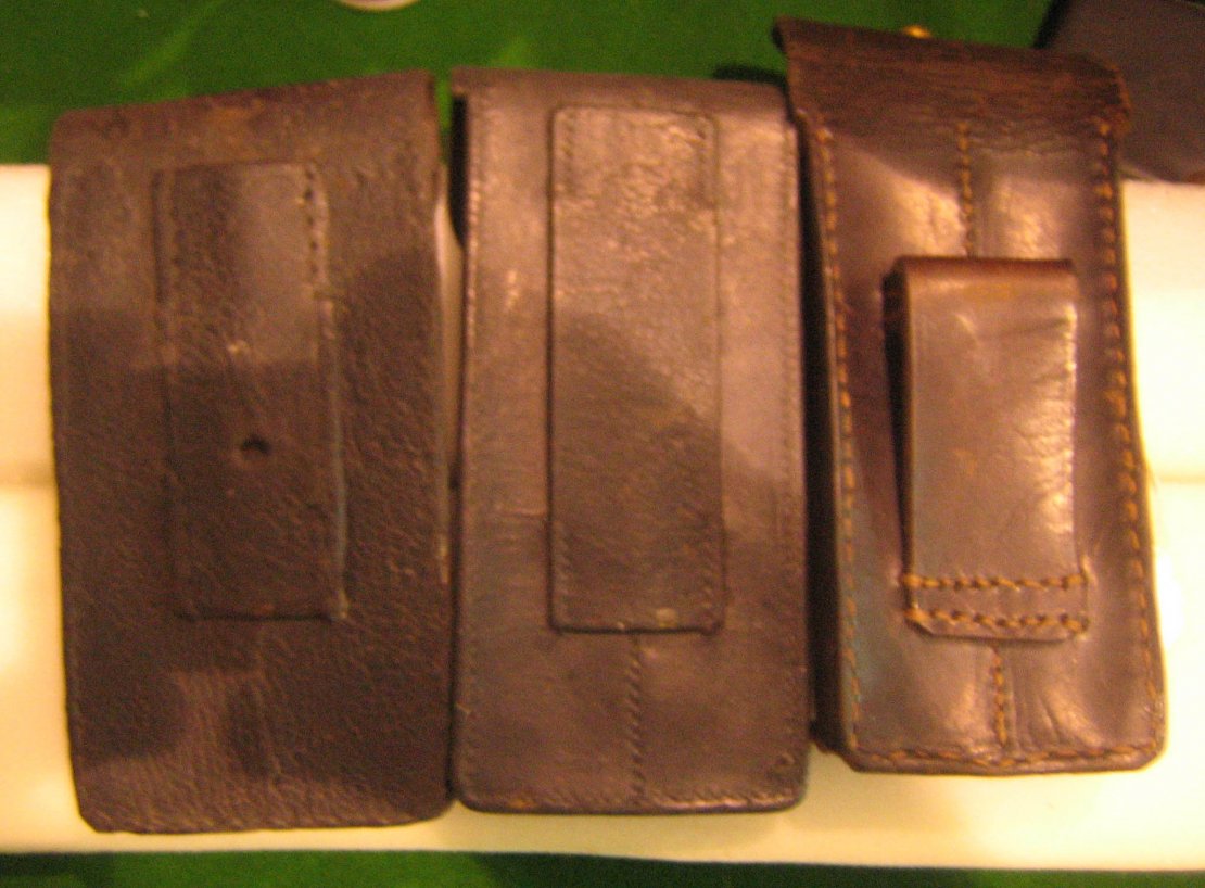

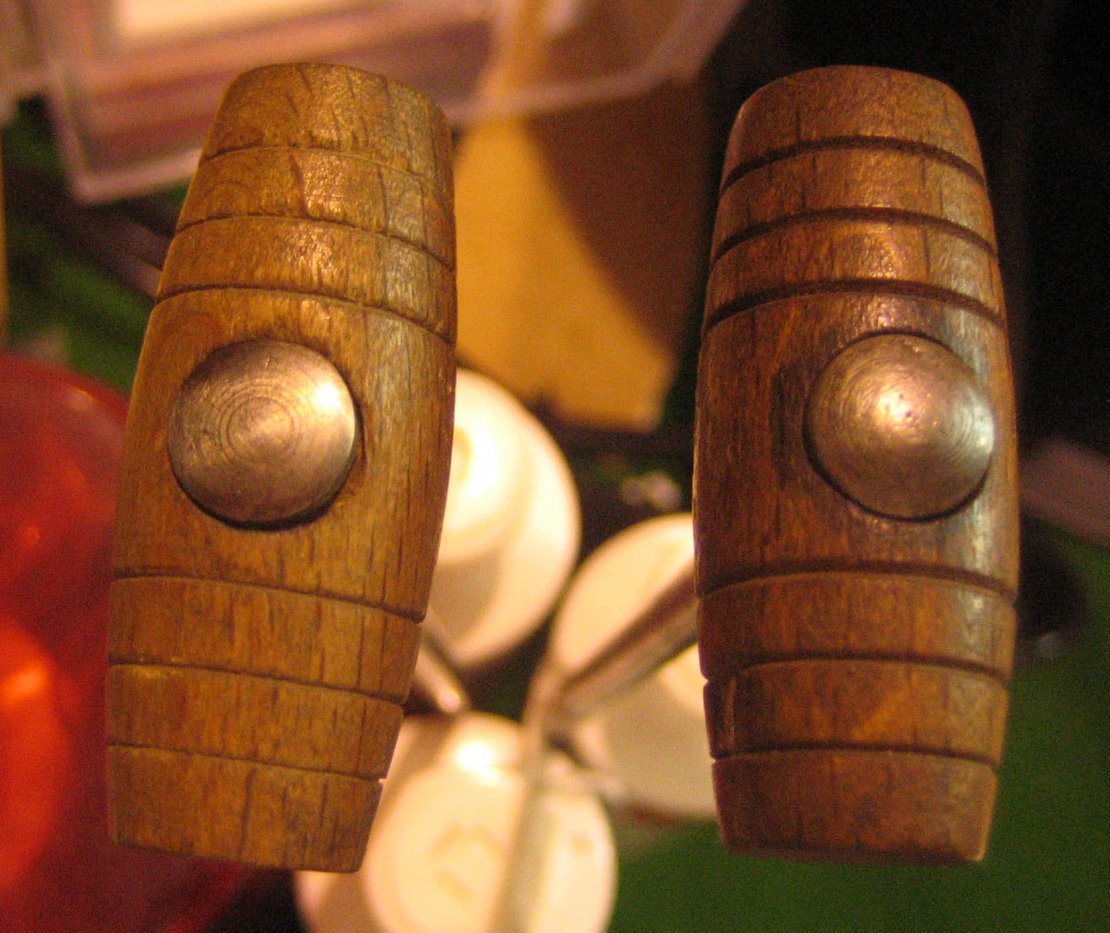

Ok, here are some photos taken this morning, I also took some photos of two cleaning rods and three mag pouches for your comments. Your comments is appeciated.
Alf.

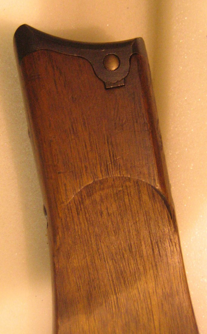

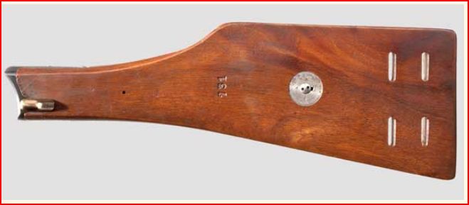

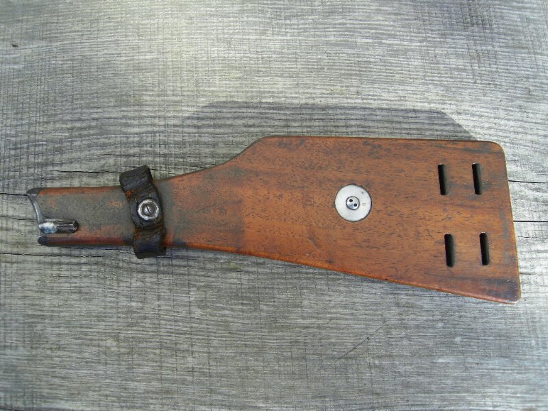

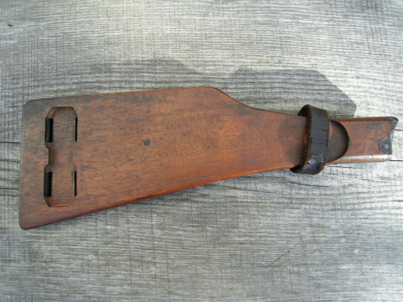

Hello,
Here is my stock.
It is matching my navy luger.
regards
Otto

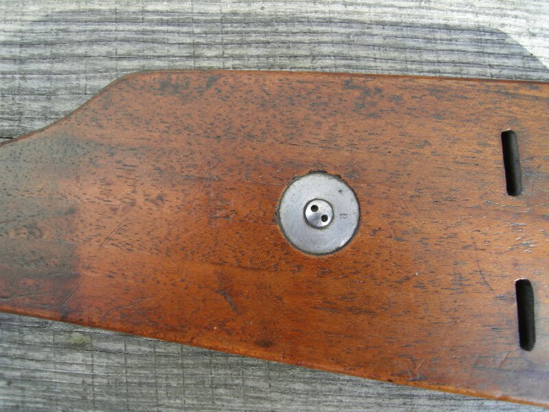

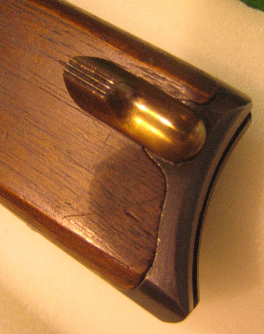

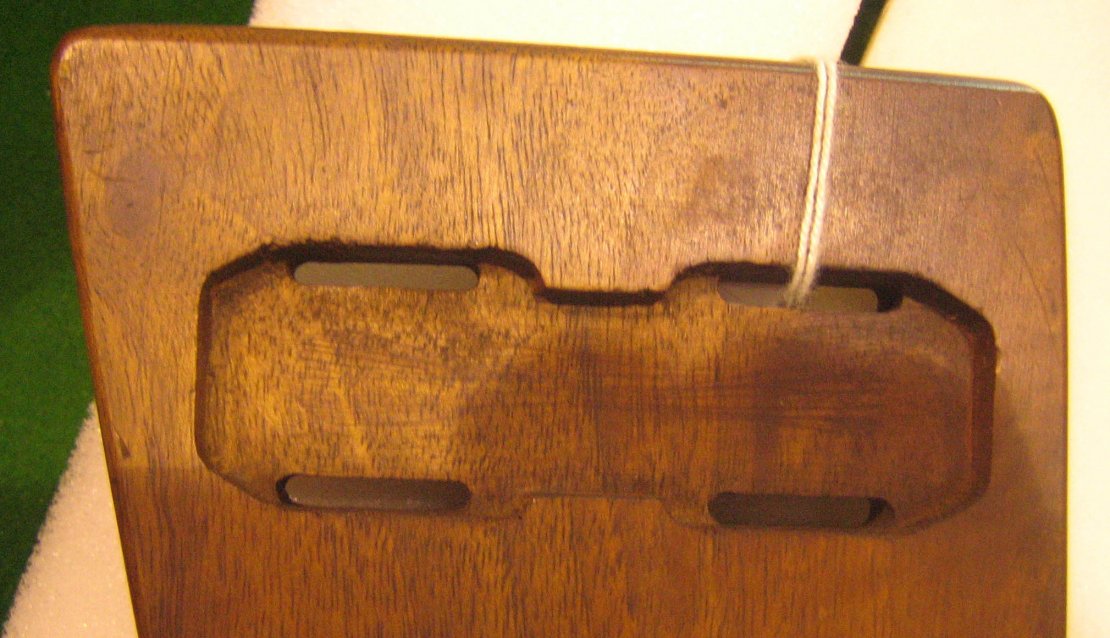

pors12 is offline   Reply With Quote

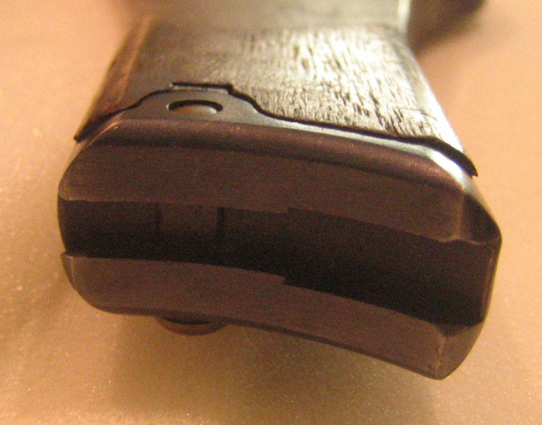

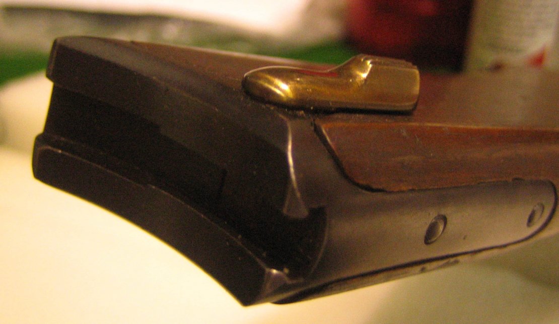

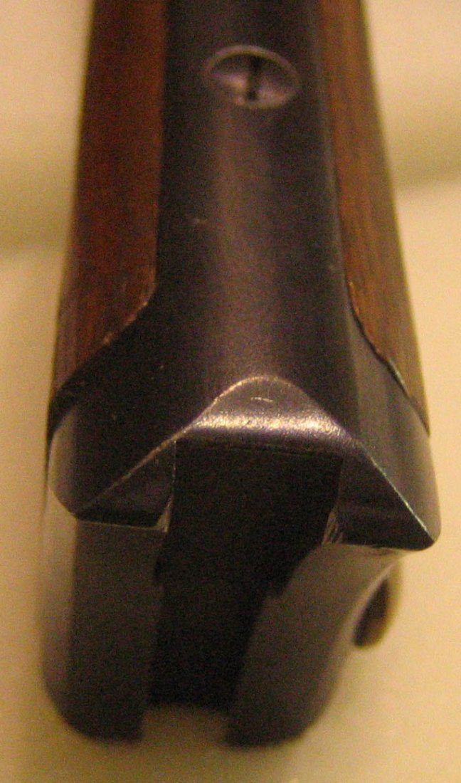

Hi Thank you for thr photos, can you show a closeup of the front iron please ?
Alf

Unread 08-06-2011, 01:46 PM   #18
pors12
Join Date: Feb 2011
Location: Austria
Posts: 115
Thanks: 24
Thanked 59 Times in 21 Posts
Default Front

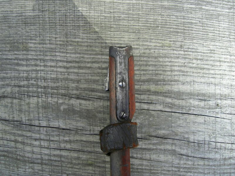

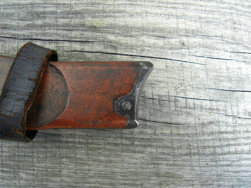

Here they are, if you need more pics just tell me.
Otto

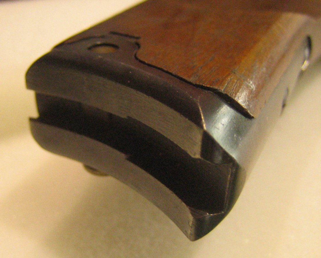

Unread 08-06-2011, 02:43 PM   #19
Alf..The Navy stock..It is a little troubling in places. The stock iron for instance. No serial number and awfully new looking. It does fit properly though..The locking lever looks high polish and strong bright straw..Could just be the photo's.
I wonder why a hole was bored into the steel marking disc? Otherwise it looks OK. I don't quite know what to make of it yet...
The 2 rod tops look alright.
The double magazine pouches..the 2 black Navy types are not Imperial but Portugese.
The one with the back belt loop is an Artillery.

Thanked 13 Times in 13 Posts
Thank You. Yes the locking lever is bright yellow, even I noticed that. The disk is in my opion installed recently, you can see the end of the pin disk on the other side of the boad, but as I said I only saw a couple of navy board, so I can't be judge of this one.
