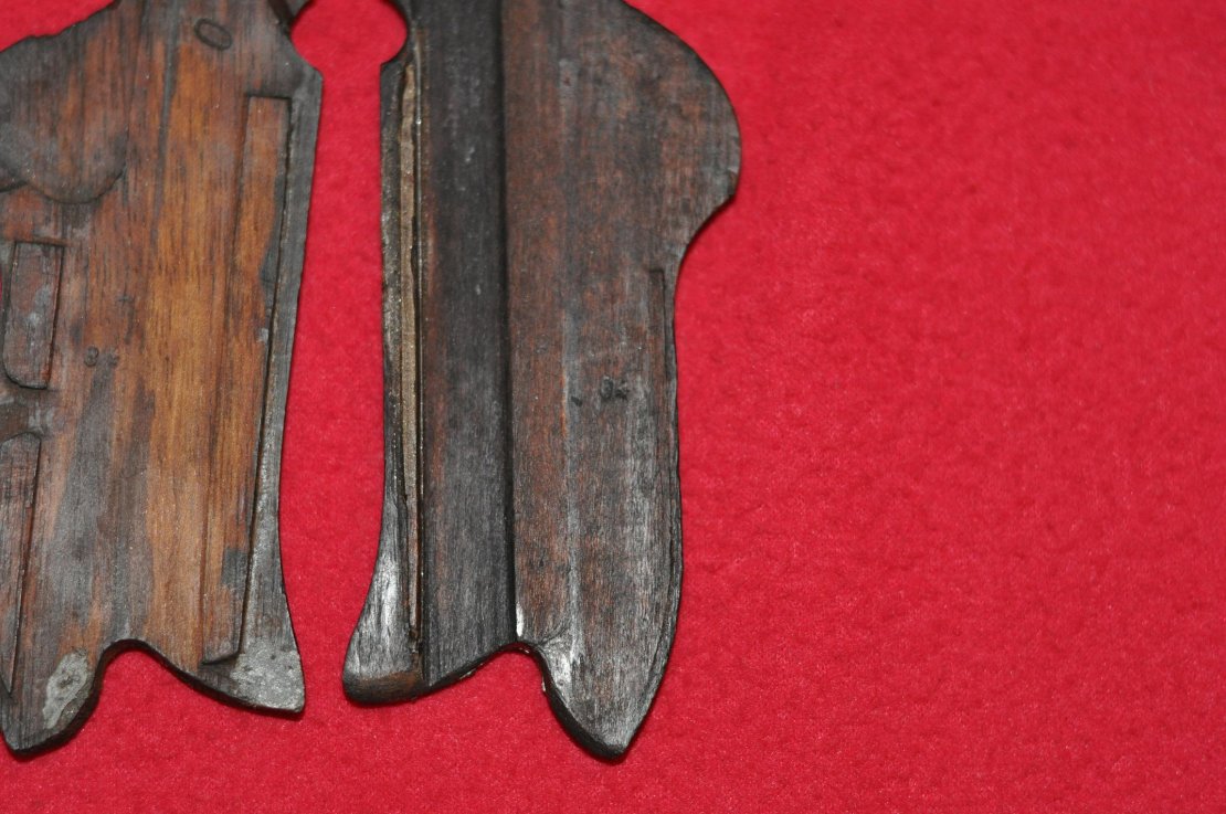

These couple of grips that had my byf41 ... of that epoch of luger are?
They have of brand the number "84 and one "0 in the left hilt

Thanks for the great feedback. The luger came today and I am in the process of getting some pictures together. I noticed that one grip had a 0 on it and the other D on it. One more question, the firing pin is also unnumbered. it looks to be original by the patina and style. Does anyone know if the firing pins were numbered at this time? Also, I apologize for having to ask, but unfortuantely all my references are in NY and I am in Fl right now. Again, thanks to all. -- Hal
