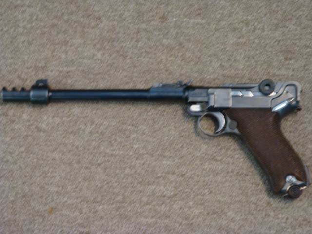

Default Picture
See pic attached of compensator

A compensator on a Luger is like go faster stripes on a golfkart. Looks nice but totally useless.

This setup appears to me similar to compensators, which are held by a set screw or by the front sight itself. If you have access to the gun look for a set crew or some indication that if you tapped out the front sight this moderator would just slide off.
With any luck this is the case and no serious permanent damage, (except for a set screw gouge) was done to the gun...
Unread 12-14-2009, 06:11 PM   #9
The front sight is not an Artillery sight. The frame appears to have a Mauser hump, and the stock lug has been removed. The sear bar is unrelieved, suggesting that the upper came from an early Imperial Luger.

Wow. The less people seem to tell about the gun the more you can sense is wrong with the piece.
