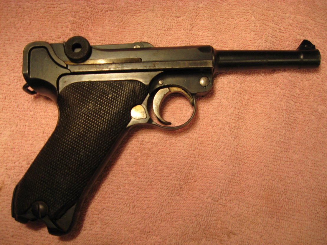

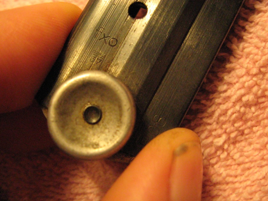

This belonged to my late father, and he received it in the early 70s from a fellow that had shot the German and brought it back.

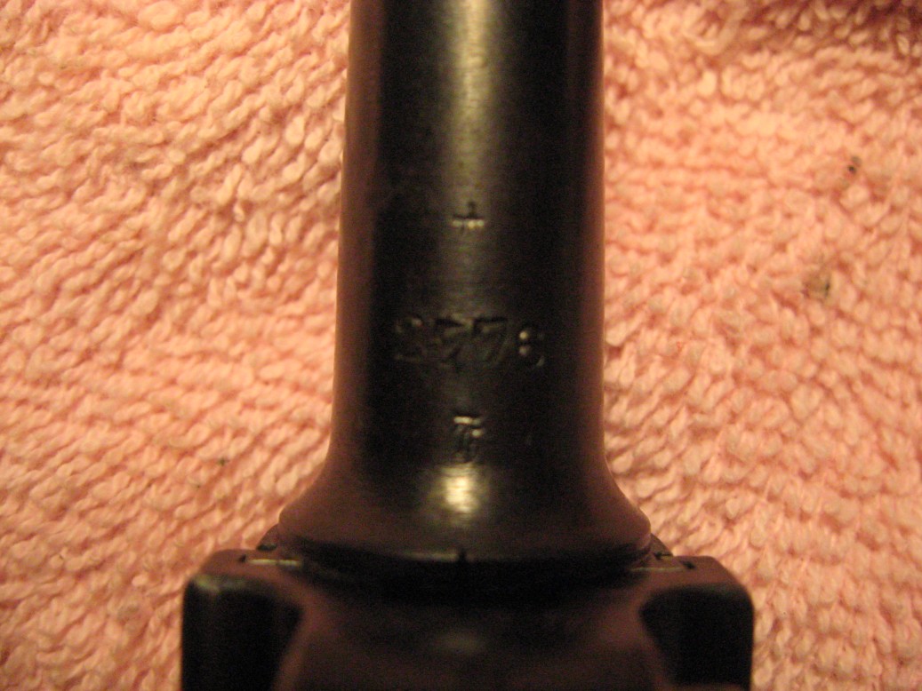

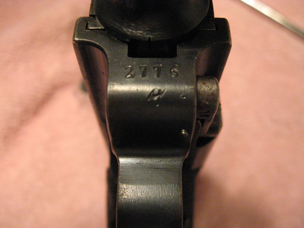

Hopefully these pictures are clear enough to help identify some of the markings. I've read quite a bit on the 'net, but it's very complicated it seems...

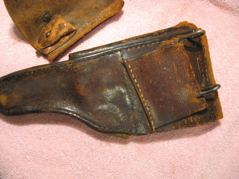

Serial number is 2776, and it appears that all parts have 76 on them, even the inside grips are 2776. I have one clip and the holster, but the holster is really showing its age, as the cover flap has separated. Still has the tool inside. More pics to come, if I can figure out how...
Thanks for any info..
Tim

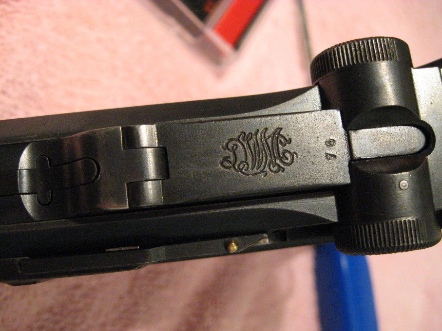

Default top view
top view marks

Tim,
I beleive it's a DWM Alphabet commercial, made in 1927. Originally 30 cal. Reworked/rebarreled (9mm) and sear safety added, put into Police service. Someone else will have to decipher the unit marks for you.
Mike C.

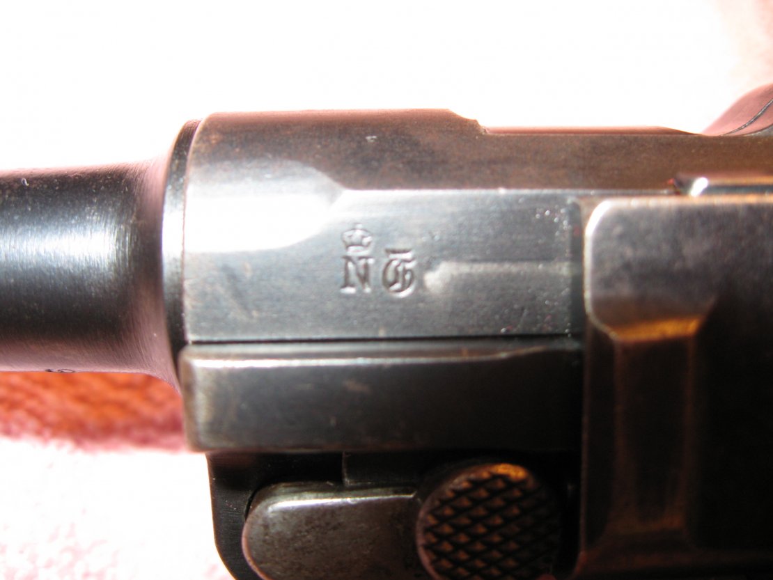

The C/G on the left receiver indicates that it was reworked. I can't see the crown pips clear enough to say whether by Simson or Mauser. Police grips strap making are Shutz Politizi Dresden or Dusseldord, I've forgotten which. TH

Sear Safety? What signifies the "alphabet commercial 1927"? I take it the left receiver is just above what you call the "take down lever"? If so, I thought that C/G (correct?) looked like some kind of fancy "T" script...and what are you looking for in the "crown pips"? And "Police Grips Strap"?

It´s a police one with the G- stamp. The crown of the G was "killed" and we find this inspector´s stamp on several police Lugers and police accessories like conversion units. S.D.IV. means Schutzpolizei Düsseldorf 4. Dienststandort. Your Luger was stationed in Duisburg at the river Rhein.

Klaus... I get most of that, but "G stamp" and "killed"...can you explain a little more? And "conversion"? Is that "G stamp" beside that crown over N?

Your Luger started out as a DWM Alphabet commercial. S#2776q (q is part of the S#) was made in 1927 with a 30cal/7.65mm barrel for the commercial market. At this time it only had the Crown/N commercial proof. It was later reworked/rebarreled with a 9mm barrel at a military/police arsenal. This is when the gothic G proof, next to the C/N proof was added. The gothic letters (inspectors stamps) on earlier Imperial Lugers had a crown over the letter.
I hope this clarifies a few details.
