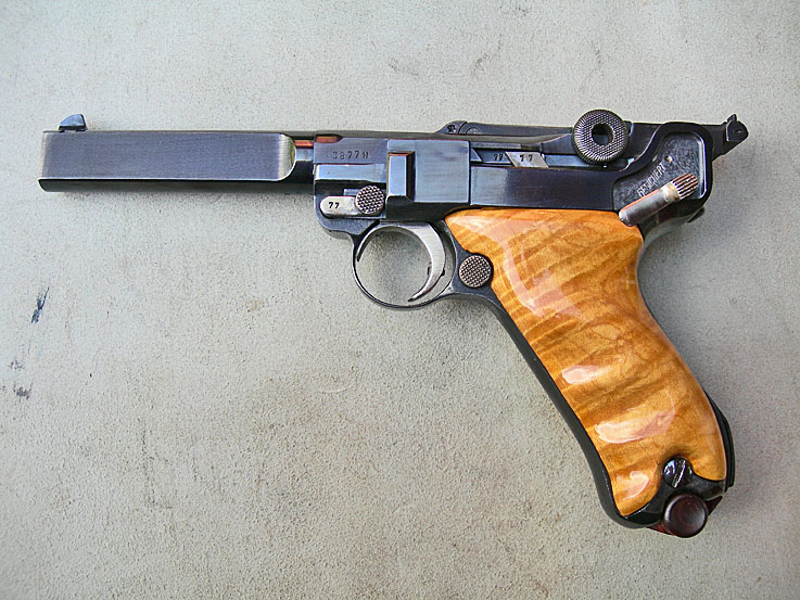

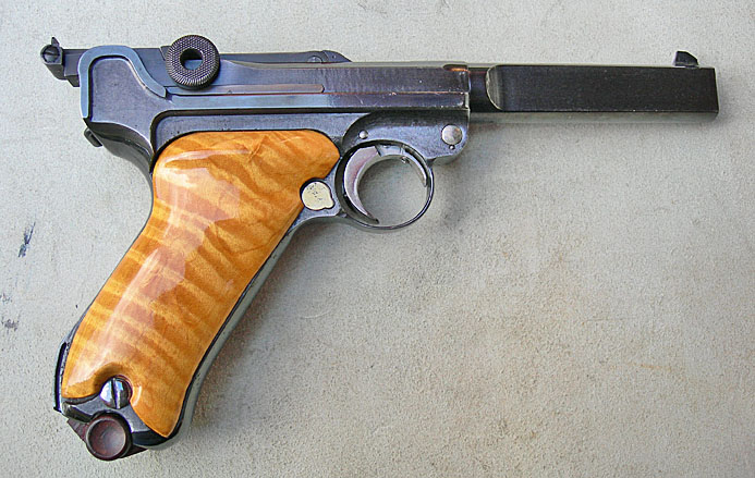

My custom target Luger built by a now deceased Texas gunsmith, 9mm, S&W rear sight. Note stop screws in top & bottom of trigger.:

Very Nice!! How is the trigger pull? I bet it groups well

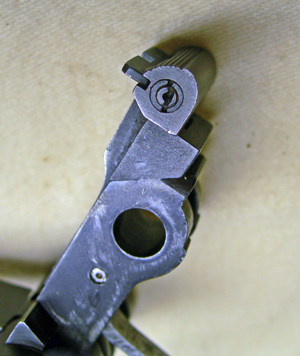

Hugh -
I've mounted some [shortened] S&W K and N frame sights like yours on M1911's...I see yours screws to a pad attached to the rear toggle...How is the pad itself attached???

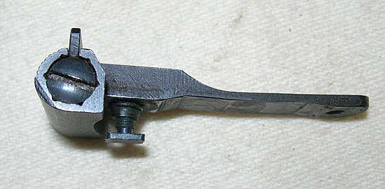

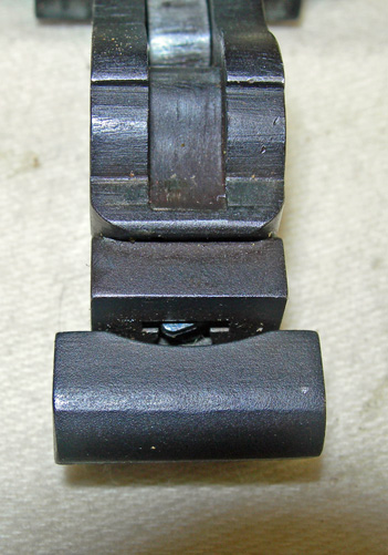

Hugh ,
could you post some pictures of the target luger rear toggle showing how the pad / toggle extension is made ?
is it silver soldered on , or welded or ?
or a custom machined one piece rear toggle ?
thanks
lfid

Here are closeups of the target rear sight. The extra block appears to be soldered on as is the little round "nut" for the mounting screw:

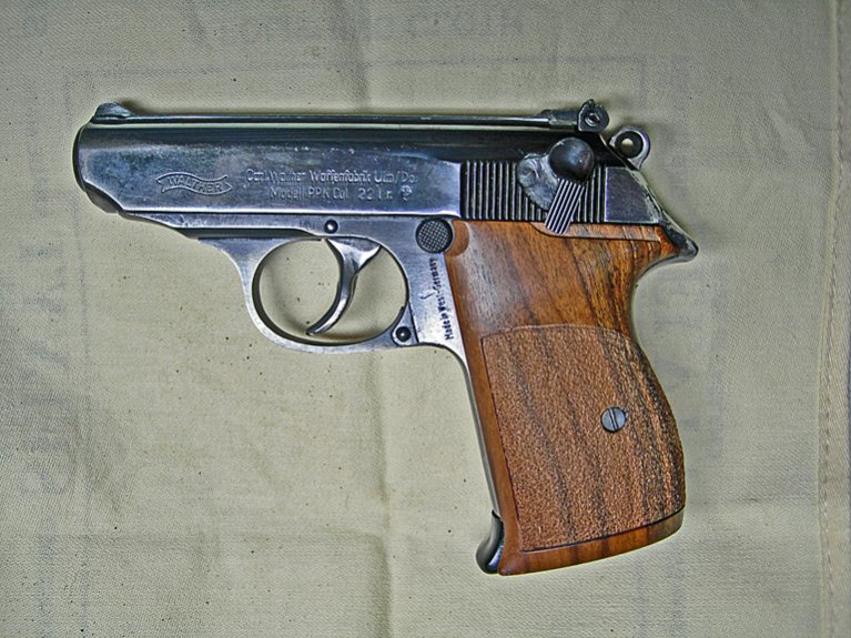

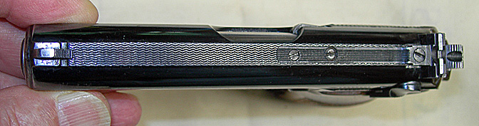

Default And tho not a Luger,
here is my "target" Walther PPK 22:
