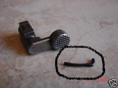

Dear friends, prompt how correctly to put this spring please?

these can appear tricky, but are not.
use needle nose pliers, and going from right to left, insert and push the L part into the frame.
it might click in, or it may not
My directions may not translate well using whatever translator you are using.

Ed,
That's one I've never done. Do you put the rt, straight end in the hole first? then fit the L end down?
FN
Unread 10-04-2009, 12:20 PM   #4
Posts: 15,978
yes
it will sometimes act like it'll click and sometimes acts loose or even so tight that the locking bolt will not fit, but it usually snaps into place.

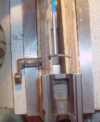

I was able to set it in place with a long thin magnet...then tapped it in place with a brass drift...while holding the grip frame in a padded jaw vise...
One warning: If you bought a "new" locking bolt spring from Numrich, throw it out immediately...

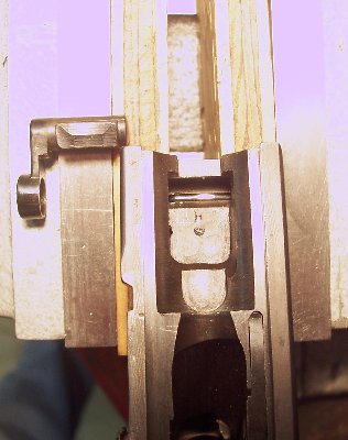

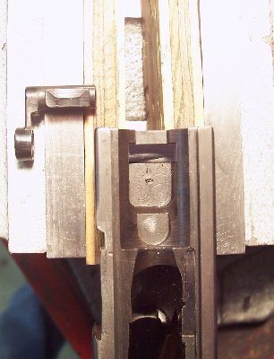

Unread 10-04-2009, 01:13 PM   #8
OK, let's see how these turn out...
First pic - Spring on magnet; short end down, goes in hole...
Second pic - spring laying in groove; short end poking into hole (snug fit)
Third pic - spring pushed/tapped into hole, ready for locking bolt
