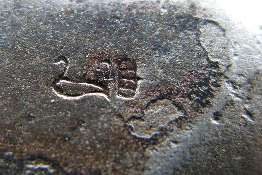

Please note there is an acceptance stamp on the right side of the chamber. The barrel must be 9m/m cal originally. No other known original 7,63 barrel bears s/n 84707 (or 4707, if we assume the leading 8 was an add-on) and acceptance stamp.... even if we assume that acceptance stamp was an add-on as well (highly unlikely), that shape of barrel taper area is almost impossible to modify and its current shape definitely points wartime production. Also, the shallow relief cut on the top right side of the magazine follower also matches 9x19 style.

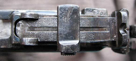

Could you also post picture showing the top of the rear sight ramp with slide set to 500? If we assume the sight ramp was modified from flat 50-500 style to steep 50-1000 style, it will be very interesting to see the worksmanship of modification.
Sure thing, just happy to clarify new aspects of this.

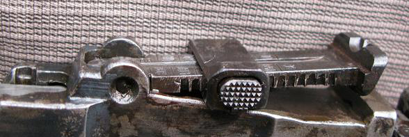

Unread 10-13-2008, 07:11 PM   #24
Thanks for the pix and I appologize for jumping too deep into the sideway bore stuff. The sight leaf is prewar. The sight slide was installed wrong -- you need to rotate it 180 degrees, so the pushdown button on the slide appears on the right side of the gun. Enjoy the gun! I agree Luger is blue chip. Broom is great fun as well.

Posts: 1,538

Unread 10-14-2008, 08:23 AM   #26
Originally posted by Morgan Kane
does that mean this sight is 'right' for a 7.63?
The sight is 'right'.... if it were 1930 (too late) or Conehammer style (too early), I would had assumed it were 'wrong', but prewar 50-1000 sight was close enough. More importantly, the work on sight ramp is excellent as well. It's impossible to tell who did what, I assume it's old work, probably by German in post WWI era. If not, at least it's done by workshop with enough skill and equipment.
