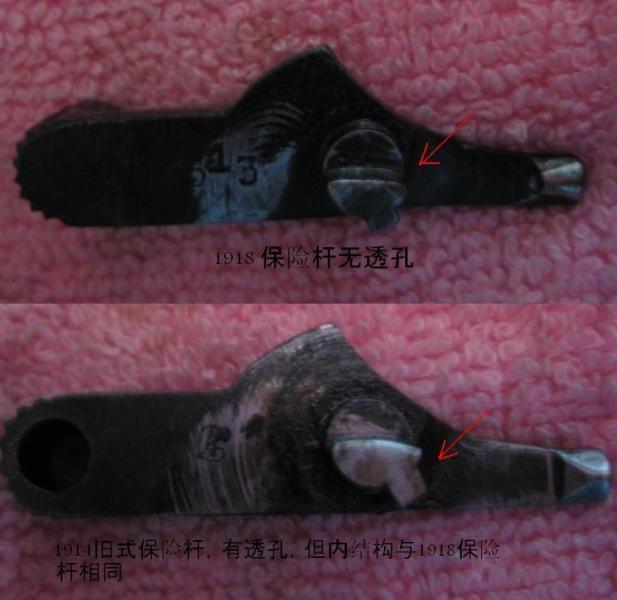

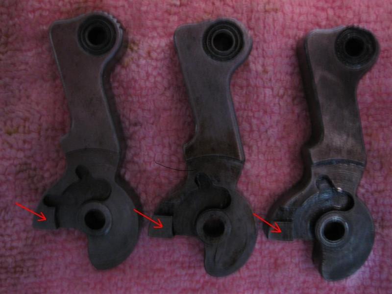

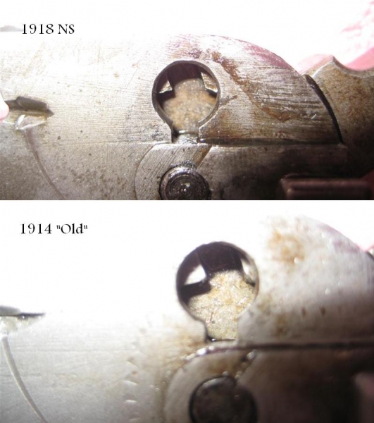

I heard it stands for "Neue Sicherung". The correct NS safety level does
not have hole on the knob, earlier safety level for non-NS marked Small
Ring has a through hole. But, that's not functional delta. The functional
difference between NS marked hammer and earlier Small Ring is the location
of the cut in front of the hammer, so the NS marked hammer has to swing
back a little bit more before safety level can be applied on in cocking
position.
Safety levels of NS gun (top, 103xxx, "Red 9"), and an earlier non-NS Small Ring (194xxx, "Prewar Commercial"). As shown, they are functionally same thing.
Small Ring Hammers (left 35xxx, "Early Small Ring"; middle 194xxx, "Prewar Commercial".... those two have the same cut location, they are actually same except the cut on left one is not through, non-functional delta. right 103xxx, "Red 9" NS, the cut is lower, functional delta)
Lock frames (top 103xxx "Red 9" NS, bottom 194xxx "Prewar Commerical", both hammers in cocking position. On the top one, the hammer has to swing back a little bit more to generate the 'pattern' shown in the bottom one.... so safety level can be applied)

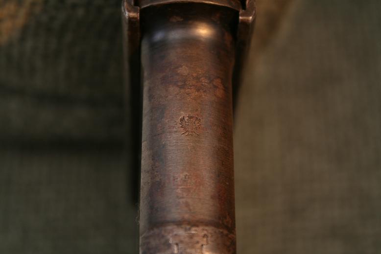

Btw. The gun in question is Prussian Eagle marked in front of the magazine well, so I beleve it's a wartime 1916 production

Prussian Eagle was supposed to be on *some* late 1918 guns. A few that I have seen having Eagles, s/n are above 100,000. There were also a few earlier samples having Eagle under the trigger guard. More observation needed. Long long way to go.

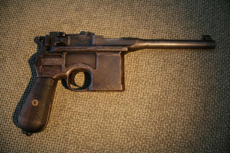

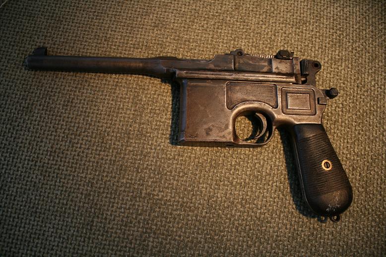

Alvin, as requested, more observation coming your way! I took a couple of pictures of it this evening, didn't have much light so they came out a bit too dark. Perhaps they put a date on this old broom?
It's quite worn on the outside, but strangely enough, it has a very nice boore still in the 7.63mm calibre. SN is 84707

Thanks for the picture. Is it a relined gun?
In 'standard' Mauser theory (as defined by great works like System Mauser, 1896-1936 etc), only three Mausers could have s/n 84707
(1) A Prewar small ring. It's not.
(2) A Schnellfeuer. It's not.
(3) A Wartime 9m/m. It's supposed to be a reworked gun modified to 7,63m/m caliber and the grip panels are replacement. Since the sight ramp looks OK, I assume the caliber was modified by the factory (recently modified guns seldomly do that right).
Although this gun has lost almost all gun blue, it's interesting to notice the residue gun blue in the Eagle stamp. On my gun, which has some gun blue (the one that I posted in the 'Shooting and Reloading' column), there is definitely no 'halo' around that Eagle. Looks like the stamp had been applied in the factory before it was blued.

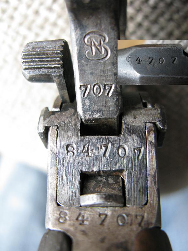

The broom is clearly marked 84707, a second look in daylight today verified it. I know very little about C96's, but I can't see any evidence of a a reline.. Is there any particular way to tell?
This broom had active rust inside and out after years of storage, had to give it a Kroil soak and 'Big .45' pad rubbing (kindly donated by Policeluger!) before it ended up as shown above. Was surprised to see how well the bore turned out, as my previous brooms where all 'shot out'..
It's matching in numbers except for the grip panels, they have a different number stamped inside. I can verify that the calibre is 7.63mm and not a 9mm..

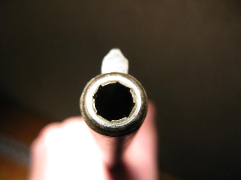

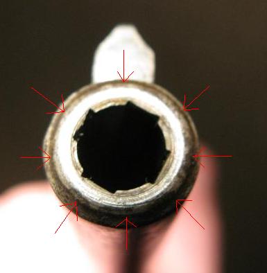

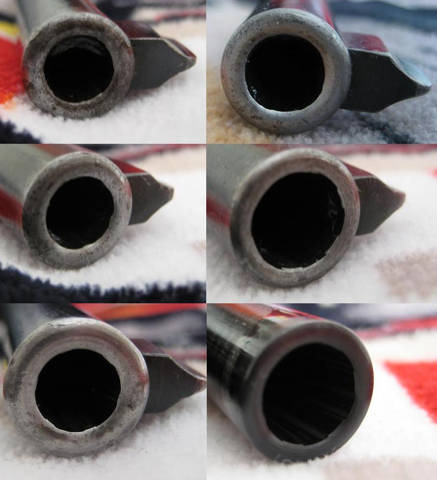

Does these show signs of a reline?

nope.....
Unread 10-11-2008, 07:01 PM   #15
It's interesting to see 4 rifling lines, and so deep. Original Mauser rifling is supposed to be 6 lines. Earlier barrel (before 1910?) has 4 lines, but those barrel also has much steeper barrel neck. I assume it has a liner inside, Quality of work is as high as Walther P-1's liner -- regular workshop could not do so good.
Unread 10-11-2008, 08:39 PM   #16
Vlim -- "Prussian Contract" was seperately numbered. I heard no contract paperwork was found, but it's known there was such a contract (Kyrie said in a Yahoo post).
Given the barrel thickness of a 9m/m, the 7,63 liner is supposed to be around this area. It's the easiest way to stay with the 'Bible' and make sense out of this 7,63m/m. I believe it's relined.

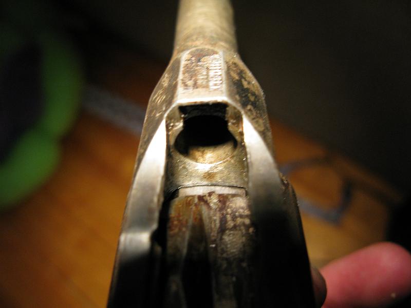

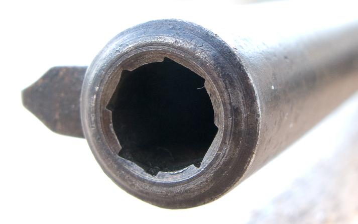

But I'm really interested in knowing more about this gun. Perticulary if it's relined or not.. So I'm tossing in another picture of the muzzle, perhaps it can reveal a reline?
..the '8' on the upper part is a bit off line, would that be normal?
Unread 10-12-2008, 03:45 PM   #18
For crown shape and rifling depth comparison purpose, I composed a picture. The one on bottom right is not Mauser, it's a BDM that I bough NIB for self-defense purpose, included here so we have a new gun to compare (the only new gun I have). Others are Mausers.
I feel the crown should be near perfect domal.

I think it's relined, but rather a 7.63 that was relined to 7.63 again.
The serial numbering is supposed to look like it was done by a drunken monkey. Perfectly normal.

If it's a reline, I have a feeling it's not done in my lifetime.. rifling is strong, but it's not exactly like looking down Flipper's blowhole eighter, find some some signs of pitting and wear in there also.
