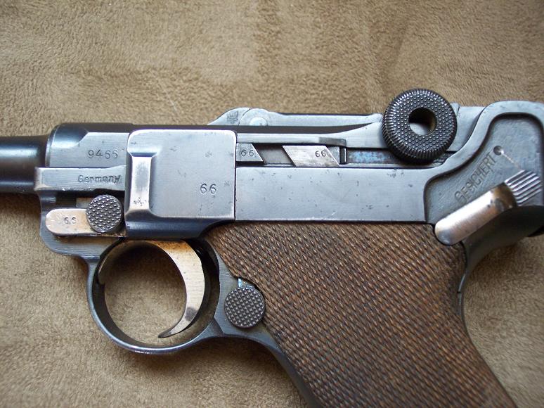

I am not familiar with the luger. I am looking for more info like what do all the markings mean and what is its value. Looking for value for insurance reasons.

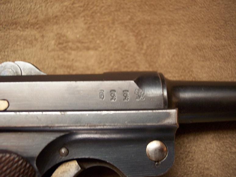

Close up of the markings

Matching numbers as far as I can tell with out taking it apart.

Robert, welcome to the forum. To help us, give us more information, suffix on front of frame, marking on toggle, etc.
Although I can guess the toggle is marked DWM and was made in 1916.
Is it 9mm or 30 luger? originally it would have been 9mm, and at some point it was sent to the USA receiving the "germany" export marking (a requirement of the USA, so could also be considered a import marking, except it was applied before coming over here).

* It also does not look like it is assembled correctly. It would be dangerous to be discharged in its present condition.
* As a guess it does not look like the toggle's internal hook is properly engaged to the main spring's "U" shaped link.
* Disassembly/reassembly instruction are available in the Tech Info section of this site. A video is aslo available; but, I have not saved the URL.
* A gunsmith familiar with Lugers could reassemble properly in less than a minute unless broken/missing parts are involved.
* Nice looking piece. If all matching numbers, this condition should bring at least $1k (Insurance purposes).
* Trust this helps.

It is a 9mm and the toggle is marked DWM.
The magazine serial numbers do not match.
I never had it apart and I donĂ¢??t intend to shoot it. I looked at the diagram but I am not able to tell what is wrong on assembling. It is "Loose" The toggle will move easily. Can you point me in the right direction on how to assemble correctly?
I met the same problem when I handled a Parabellum the first time. The T shape hook must go under the U shapped opening in the back of the frame. Otherwise, the gun can still be assembled, but the receiver just slides back and forth freely on the top.

* Fellow member "Shadow" has provided "how to" video's on his YouTube site. Hardly likely you would have to go to the detail level of disassembly shown to rectify your pistol's malady.
* Assembly/Disassembly: http://www.youtube.com/watch?v=X2Mra...eature=related
* Assembly after a basic field strip for cleaning: http://www.youtube.com/watch?v=WBP0R...eature=related

So what does the markings mean and the suffix i? Is this a Collector or a shooter?

The markings (proof marks) deliniate:
German military receiver proof. Found on DWM Lugers 1914-1918.
Proof marks can be found in the technical information section of the forum.
From the pictures that you posted, the finish looks at least original to the era (1920? might be refurbished before exporting? you may check "GERMANY" under a loupe for the halo effect). If it's also all-matching except the magazine, it's a conventional "collectible". I have seen quite a few people shooting collectibles though. Some spend more $$ to replace fragile small parts before shooting, some don't bother doing that. That's up to the owner.
