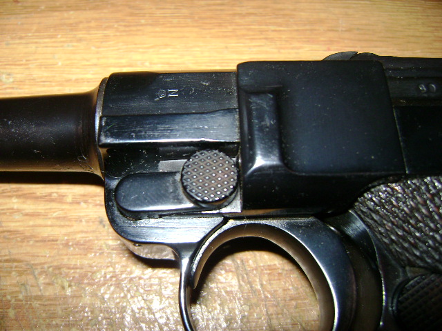

safety is in german.

and report whether your Luger has a straight or spurred recoil spring well; a reinforced or unreinforced frame; and an unrelieved or relieved sear bar. Your observations will help narrow down the time frame.

here's the spur.
