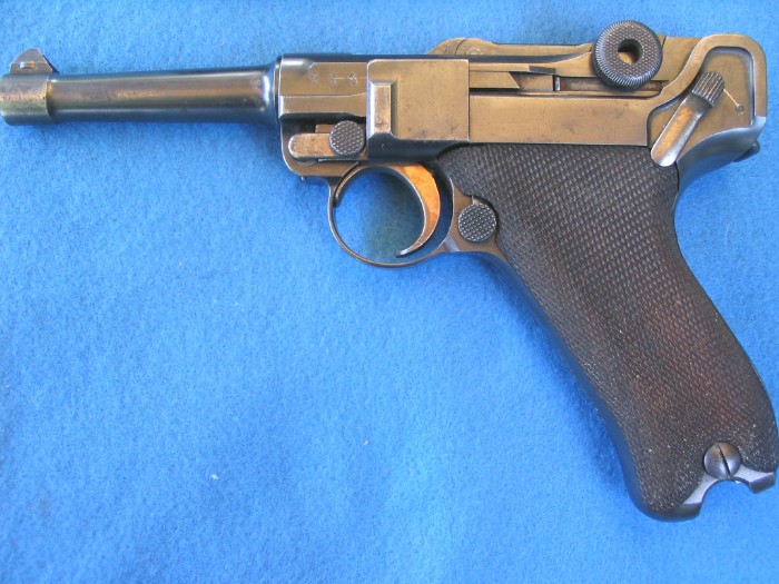

Look on the left side of the upper half. I have a first model and Ron is right. They are easily mistaken for a commercial. The stock ramp is the giveaway The original 08s didn't have one. many of these early 08s were unit marked

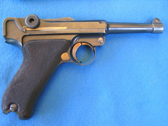

Chris,
Photos of one of my 1st Issue P.08s for reference. Note the proofs on the left side of barrel extension/receiver. Also, Commercials will have Crown N proofs, 1st Issue will not.
