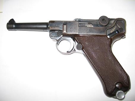

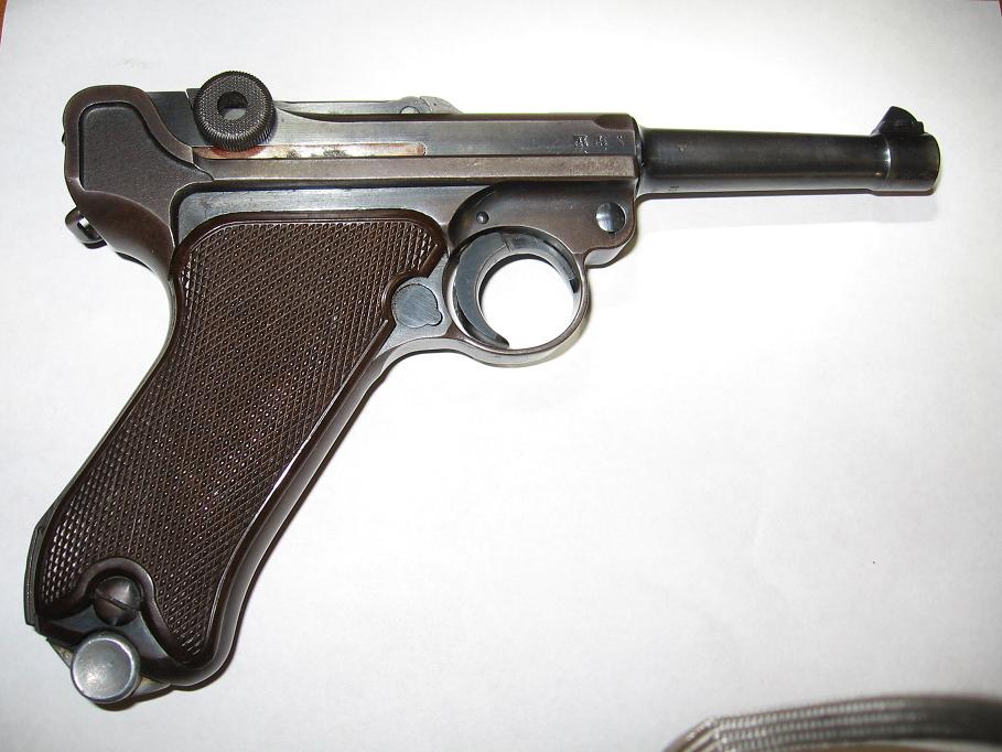

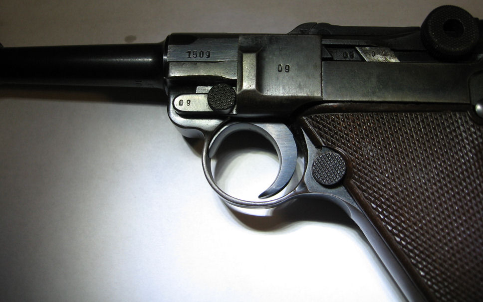

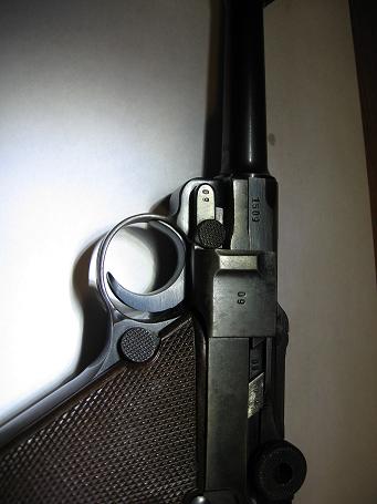

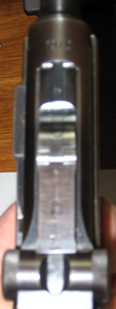

Default pics of my luger
Here are some pictures thanks for the idea of using paint to reduce pictures so we can post them on the luger forum. lugeral

Unread 01-16-2008, 08:42 PM   #8
lugeral, looks like a nice 1940 42

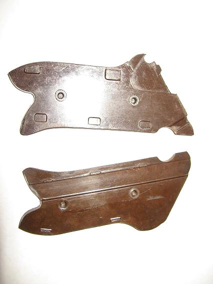

Unread 01-17-2008, 10:51 AM   #11
I would be very interested in seeing clear closeup photos of the inside of these brown grips... the possibility exists that they are originally Krieghoff grips which would raise the value of what you own considerably... Krieghoff grips are a premium item, and yours are in good shape.

Default handle pics
Here are those handle pics thanks for your interest. lugeral http://forum.lugerforum.com/lfupload...dles_small.jpg

Unread 01-17-2008, 01:48 PM   #13
I am not an expert on Krieghoff Grips, but these look like genuine KH grips to me. I suggest you post these photos in the Krieghoff forum and as the experts there for their opinion. There is a pair like this on ebay right now and the buy it now price is $499.99... Good luck.
Unread 01-19-2008, 12:28 PM   #14
waltherguy
waltherguy's Avatar
Join Date: Jan 2006
Location: FL
Posts: 201
Yes the grips were the first thing I noticed when the pictures were posted.. My first thought was Kriegoff as well.. I am no expert either.. but they look legit to me. overall a very nice Shooter! congrats!
