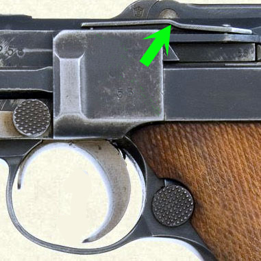

Jarrod,
I agree with Jamese. Here's a photo that may help. The green arrow points to the "police sear safety."
Dave in TN.

Yep thats it. I found the "data base" here and found out that only the police lugers got them, unless it was added later. But mine is origional to the rework.
I did get it out and everything ok, just wasnt sure why some dont have it. And why do some have the sear bar back farther than mine, because mine there is like an 1/8 inch gap between the safety block and the sear bar, where on some they mate up right next to eachother.??

You have what is known as a "relieved" sear bar. In 1916 an improvement to the sear bar was made that permitted a loaded gun to be cleared with the safety on. Before the sear bar was relieved, with the safety on you couldn't bring the toggle back far enough to extract the cartridge from the chamber. Many earlier guns that were still in service were retrofitted with the relieved sear bar.
