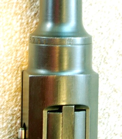

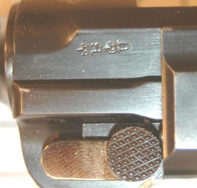

The term is "Berner Probe".
Here is what is looks like on one of my Swiss M1929 Lugers :

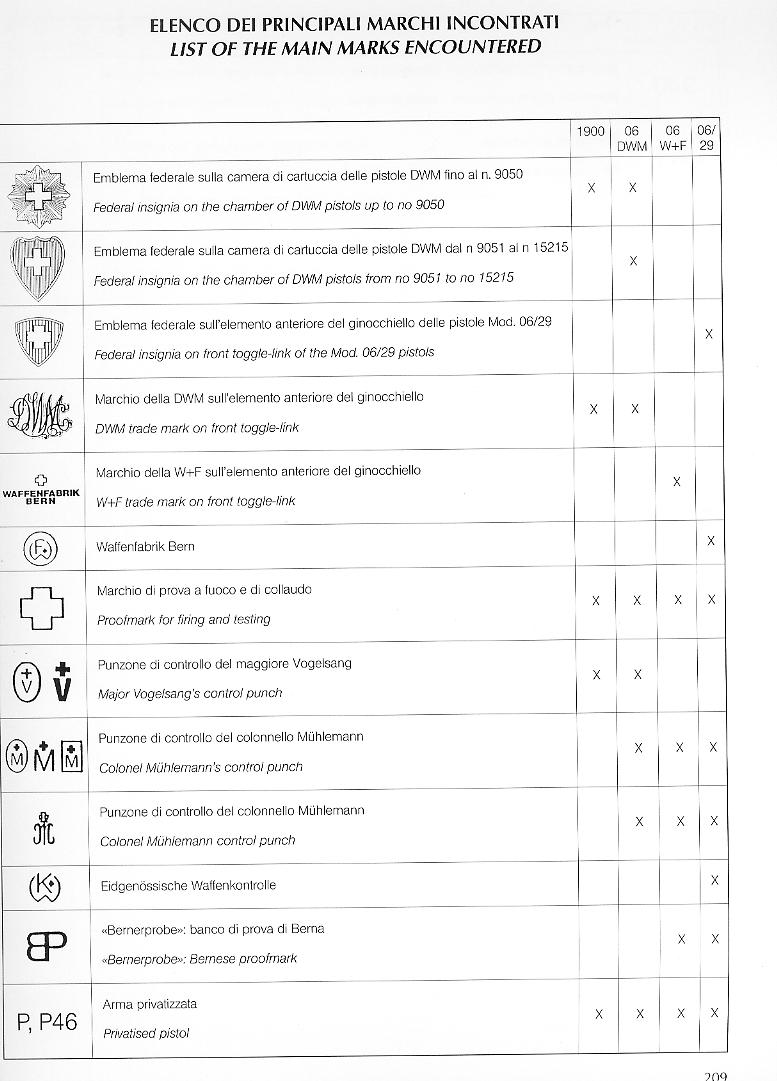

Here is a chart from the Bobba book on Swiss lugers showing all the Swiss proofs :

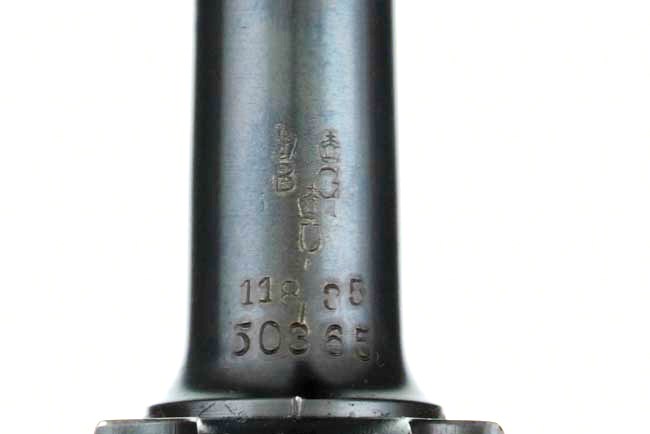

You will see only "BU" on the left side of a receiver and "BUG" on the barrel (usually with "halos") :
