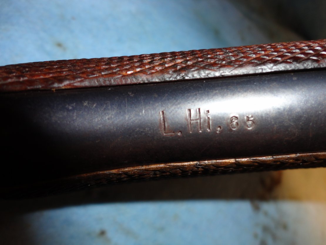

Jags, i myself think you maybe very correct in your assumption. The picture of my 1929 dwm police , most concure on here it was a new gun when issued to the Landicejer police. Others on the forum may have ideas on this matter. Hope to see some pictures of your new purchase and welcome to the forum.
Name:	0106 12 019.jpg
