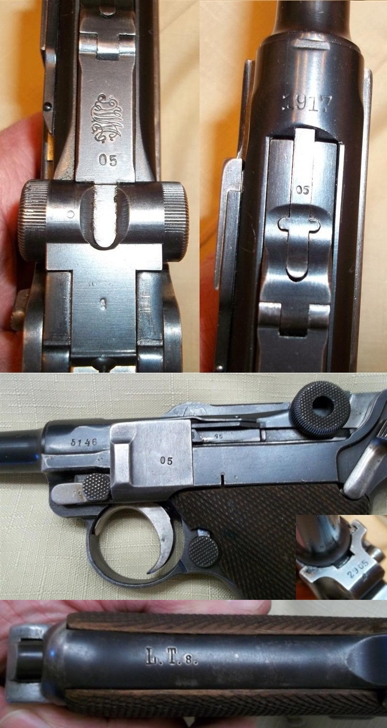

jags 04-03-2012 06:28 PM
Thanks for all the input!!
Here's a pic that might help with the discussion:
http://www.giftworldminimall.com/p08c.jpg
Is there anyway to date a military frame without the barrel date?
Thanks again!
